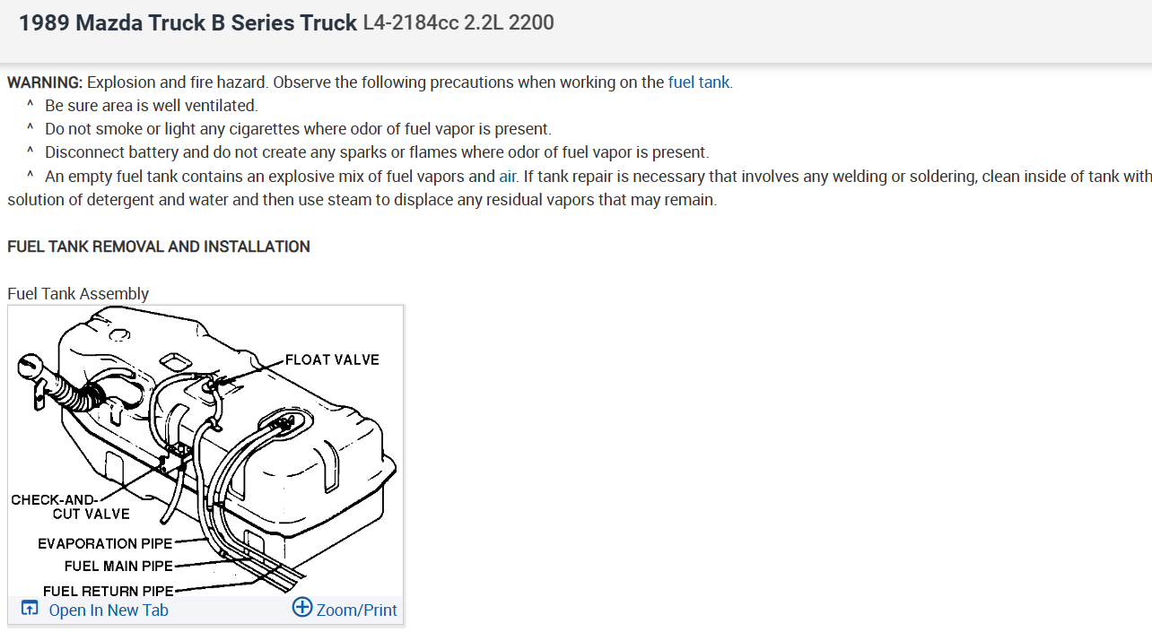

Truck will be running fine. Then it will run as if it's running out of gas. So, I will add gas but then I can only put 3 gallons. Why is it running like it running out of gas after 3 gallons low from a full tank?
Oct 29, 2024 at 11:11 AM
  • 55,214 POSTS

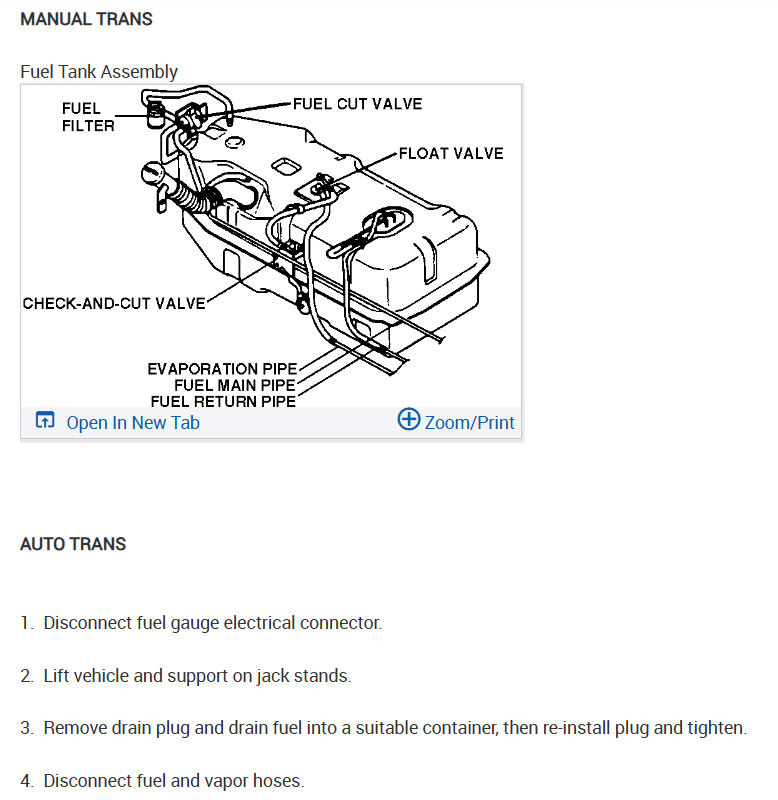

You probably have a fuel pump that is going out, also I would replace any lines that are dry or cranked which should take care of the problem. here is how to replace the fuel pump. Check out the images (below). Please let us know what happens.
