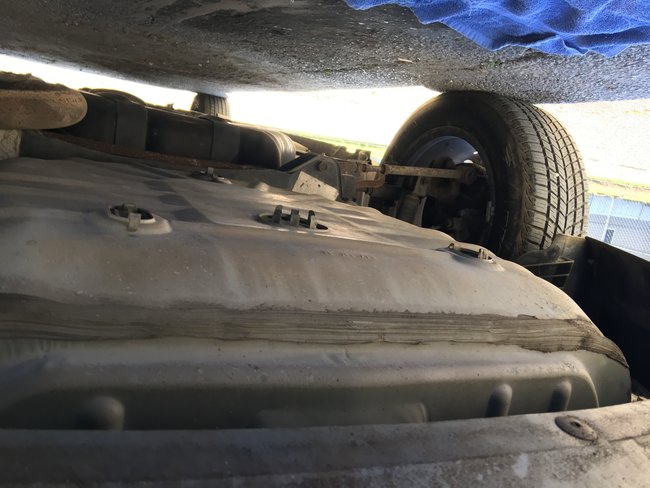

I want to remove my gas tank so I can replace the fuel pump and fuel filter. however, I have no idea how to remove my fuel tank, it almost looks like it is sealed to the car.

That is not the fuel tank. The fuel tank is farther forward in front of the rear axle. You have to get the car at least two feet in the air to remove the tank as it has to drop a small amount for you to get to the wiring and fuel lines. Then wrestle it the rest of the way out. Next you need air to clean around the pump retainer ring. Remove the ring then the pump. Reverse to install.
However, and no disrespect meant, if you are not sure what the tank looks like you may want to pass on doing the pump yourself. If you break a line or install an O-ring wrong you can have a very bad problem. Plus the bonus is than you do not end up stinking like gas!
Now if you still want to try, look on YouTube there are likely a few videos on pump replacement on the same year/make/model of car that will give you a lot more information.

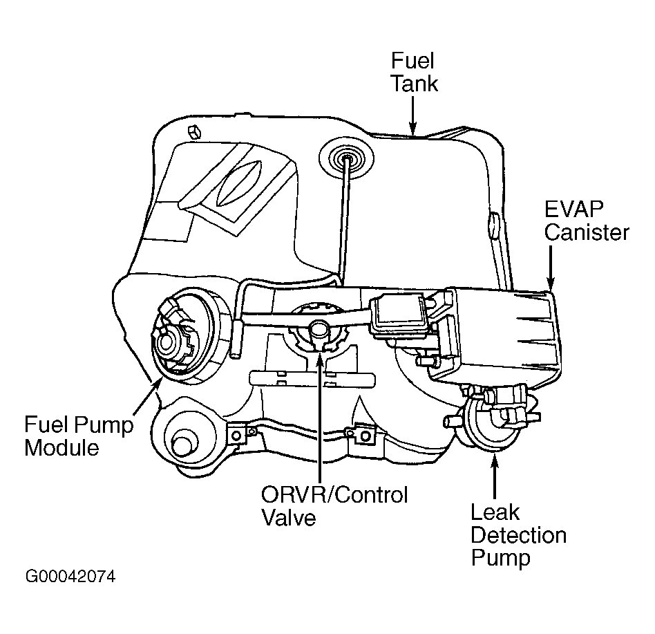

BOOOOOOO.... Those you have to drop the tank. The coupes have a handy access panel under the rear seats.
Here are the "book" directions:
Release fuel pressure from fuel system.
Disconnect negative battery cable. Raise and support vehicle.
Place a gasoline container (at least 16 gallon capacity) under fuel tank drain plug. Drain plug is located on left edge of fuel tank. Remove drain plug. Allow fuel to drain. Install drain plug, and tighten to specification. (Warning plug does not drain all fuel from tank)
Support fuel tank with a transmission jack. Remove fuel tank strap bolts. Slightly lower fuel tank. Disconnect fuel filler vent tube. Disconnect fuel and vapor lines. Disconnect vacuum line from leak detection pump. Loosen fuel filler hose clamp, and disconnect hose. Disconnect fuel pump module harness connector. Lower fuel tank from vehicle.
Sounds like a piece of cake, until you find the rust and dirt the years add on. Then the nice brittle plastic and hard hoses.

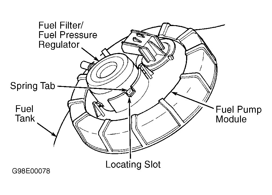

Also, one last question sorry about asking I am not well versed in vehicles in general. would you happen to know where the fuel filter would be on this car as well? It is apparently not a typical fuel filter you would find on most cars.

It is on top of the fuel pump and is part of the pressure regulator. Still need to drop the tank to get to it though. It can be changed without touching the pump itself.
