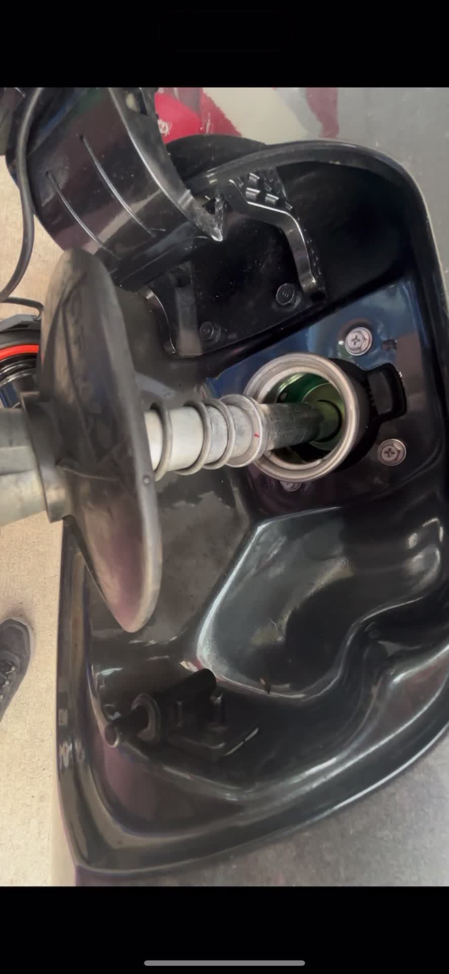

I went to a gas station and started pumping gas and halfway through it spewed everywhere and even after I removed the nozzle it was still going and if I squeezed the notch more would trickle out. This is the second time I have been to this gas station and had this type of issue and I even used a different pump! Is there a way u can confirm that the issue is with the nozzle from this video? Also will this cause any effects to my car? Thanks

I went to the gas station today and I began pumping and it seemed fine up until I got close to 4 gallons of gas and the nozzle seemed to spurt out everywhere. I talked to the gas attendant and he told me the nozzle was previously faulty and was recently fixed. I’m concerned if this will affect my filler neck or gas tank by it spurting out like this. Any mechanic advice would help thanks a bunch! Here’s a video of what happene

Yes, I see what went wrong, the gas filler needs to be inside the filler neck, not almost out, the gas nozzle has a shut off valve in the tip of the nozzle, but you have it too far away for it to work, insert the nozzle fully into the gas fill and you should be fine.

As the other tech states above. The nozzle needs to stay fully inserted into the filler neck so the shut off valve works properly. With it half in it will not activate the shut off valve properly and will cause it to spit out and overflow.

I'll be the third person to tell you to put the nozzle all the way in. The shut-off sensor can't do its thing when it's that far from the filler pipe. As far as damage to the vehicle, this is no different than when people like me keep trying to squeeze in a few more drops, over and over, until it overflows. The worst is the gas residue on the paint is likely to collect road dirt and show up until it's washed off.
By holding the nozzle back so far, it's the same as holding it over the ground and expecting it to not pour gas all over. Gas pumps and nozzles have different designs and run at different pressures and flow rates, so just because you don't have a problem at one pump or one station doesn't mean you'll get the same results at a different pump.
To say this a different way, If I held the nozzle out not fully inserted, I would expect gas to splash out like it did in your dandy video.

You want the nozzle to be in far enough that it is setting on the spring. With it part way out you are doing a couple things, one is preventing the nozzle from shutting off properly. However the other is why it is spewing gas out. The pump is trying to put gas into the tank, as it does that the air in the tank as well as gas fumes need a way to get out. For that your filler neck has a vent tube that goes down and through the vent system that is part of the EVAP equipment. That vent allows the vapors out while you are filling the tank. BUT, with the nozzle part way out, the pump now puts fuel into both the main fuel neck and some goes into the vent line. Now the air and vapor has no where to go and it dumps gas back out until one or the other is open to let the pressure in the tank escape. Have ever swallowed something wrong and then started coughing trying to clear it out? That is what is happening here. The pump flows fuel very fast, some blocks the vent and the system tries to cough out the excess. Put the nozzle farther in and you will prevent this.

The symptom you have is air trapped in the tank from the fuel going in. A bad nozzle wouldn't act that way, it just wouldn't shut off when you removed it from the tank. The sensor that trips the valve in the nozzle actually uses the venting gases to tell it to stop when inserted properly.

Continuous would be the same as if you were holding the lever on. Like spraying with a garden hose. The dripping you saw was due to the fuel that spit back. If you were to look inside the nozzle you would see the large opening the fuel comes out of, and a smaller port that senses the fuel vapor and is what tells the nozzle that the car is full and to shut off. Normally the smaller port doesn't have gas in it, the spray back you had would have shot fuel into the nozzle and into that tube. The fuel trying to get back out would be much more than would normally drip out. The way they operate is also why they need to be inserted fully into the fill neck on the tank. The auto shut off has to be blocked to shut off the valve in the nozzle. In your video the venturi tube is out in free air and not in the filler neck below it's vent.
