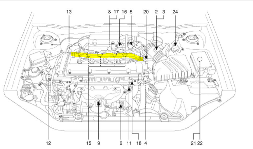

I was told that it could be normal with it being -20°F here but everyone said it should go away and it doesn’t. I can smell it coming from my heater when that’s running. I didn’t think it was leaking until I went outside and saw a little puddle and given that it’s been snowing that’s what I thought it was but when I went to smell it, it smelt like fuel. I don’t even know how to even go about diagnosing it, let alone fixing it. Any help would be greatly appreciated.

Regardless of the outside temperature, you shouldn't smell raw fuel. Also, this should be resolved before driving it.
As far as the puddle, where did you see it? Was it at the front or rear of the vehicle?
I attached a pic below and highlighted the fuel rail. Protect your eyes from possible fuel spraying. Have a helper cycle the key from off to on a few times while you watch to see if there is evidence of a leak.
By cycling the key, you will build up pressure in the system. So, make sure to protect your eyes.
Let me know what you find.

It’s at the front of the car. I smell it more on the driver's side of the vehicle than I do on the passenger side.

I got it figured out; it was the line that delivered fuel to the fuel rail. The hose clamp that connected the hard line and the rubber line failed. Replaced it and we’re good to go. Just wish it wasn’t -10 when I was doing it.
