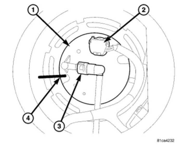

my gas gauge might be stuck at half a tank because it seemed at half for a while, but when i put gas in it, the gas went up.
Jun 12, 2020 at 8:48 PM
Good morning,

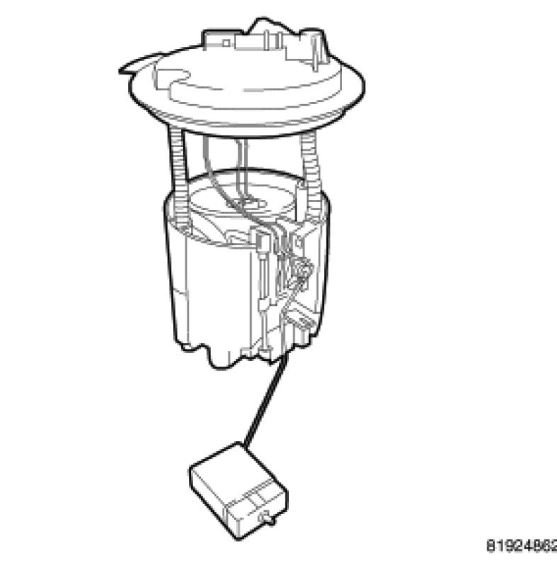

Most likely the sender unit itself is the issue inside the tank.
I attached the procedure and location for you for this issue.
REMOVAL
1. Use a marker and place a mark (4) across the position of the fuel pump module lock ring and fuel pump module (1) prior to removal.
2. Release fuel pressure from the fuel system, See: Fuel Pressure Release > Procedures > Fuel System Pressure Release Procedure.
3. Disconnect electrical connector (2) from fuel pump module (1).
4. Remove fuel line (3) from fuel pump module (1).

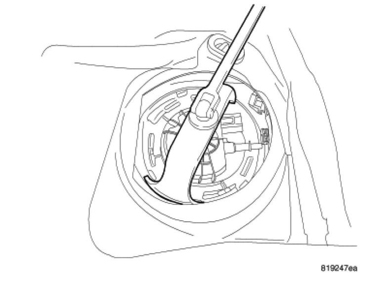

5. Remove fuel pump module lock using special tool 9340.

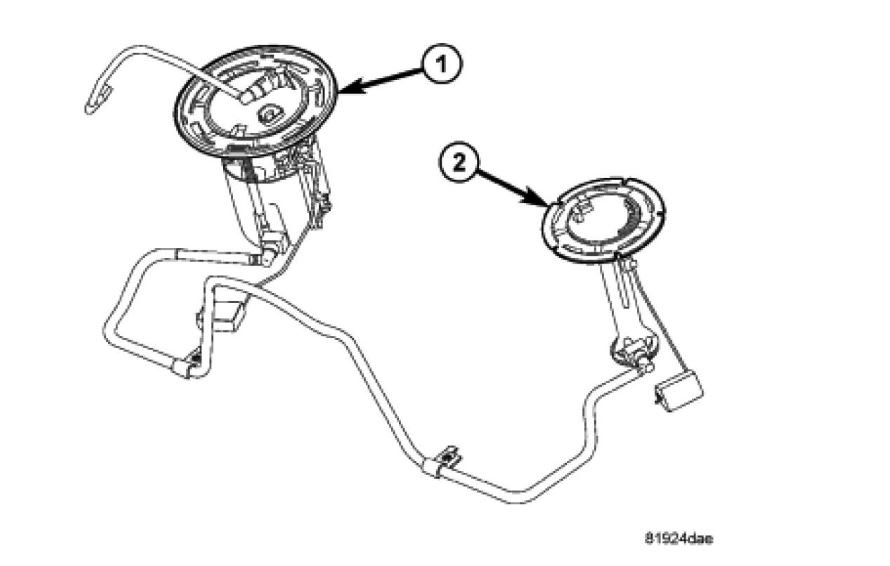

MODULES AWD STEEL TANK JS
6. If equipped with AWD, disconnect fuel line between fuel pump module (1) and fuel level unit (2).
