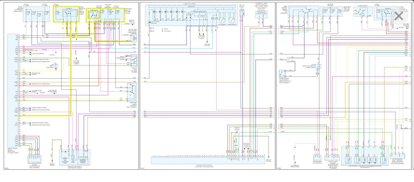

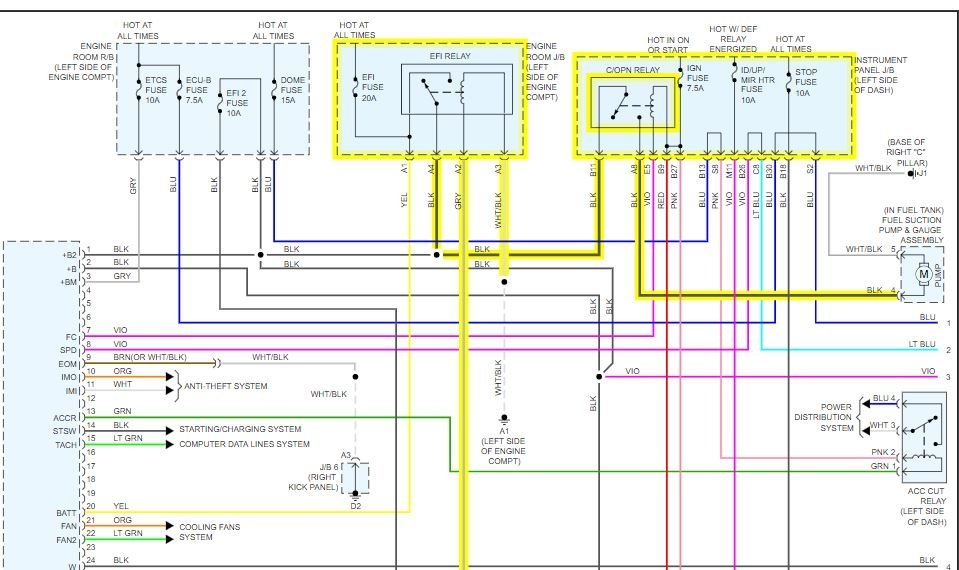

Electric gas pump, no power.
Jun 4, 2019 at 7:31 AM
Experienced Mechanic
52,796 POSTS
Good afternoon,
I attached a wiring diagram for you to view.
Check both fuses listed for power on both sides.
Do you have a voltmeter or test light to do some checks for power at the fuel pump?

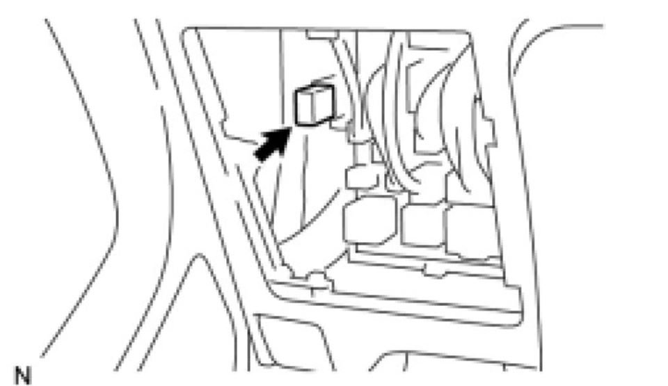

All the fuses are good. I need to know where the power relay is located.
Jun 4, 2019 at 9:54 AM
52,796 POSTS
Location for you.
