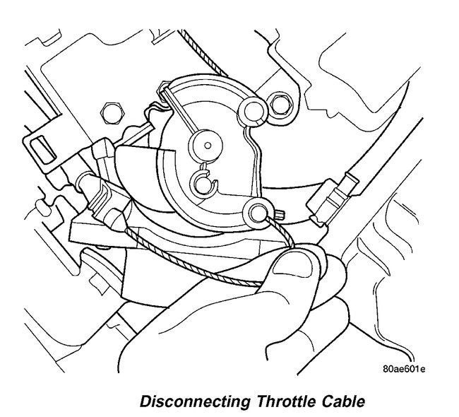

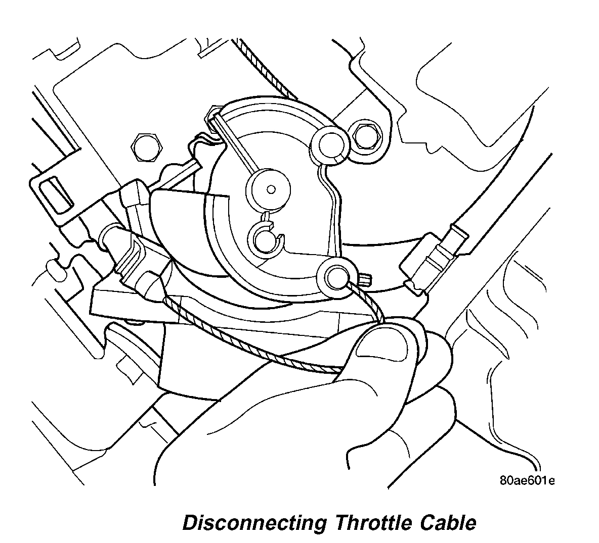

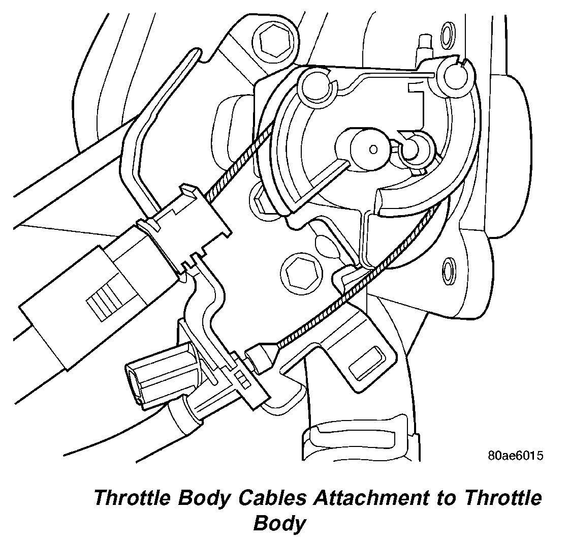

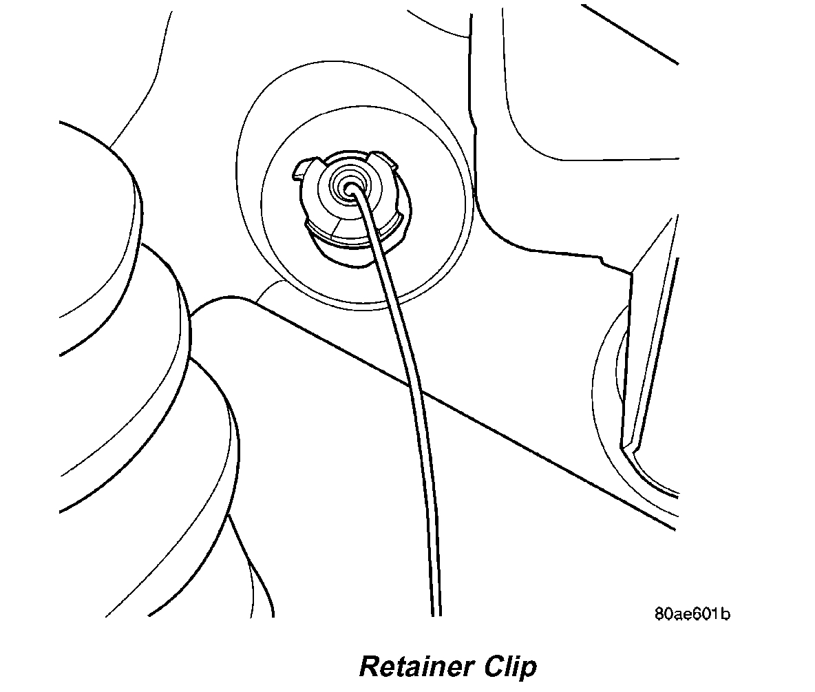

Your vehicle's throttle is controlled by a cable. First, confirm that the cable isn't disconnected, damaged, or broken. Here are the directions for removal and replacement of the cable. The attached pictures correlate with these directions.

1. Remove throttle cable cover or engine cover, if equipped.
Throttle Body Cables Attachment To Throttle Body
See Picture 1
Disconnecting Throttle Cable
See Picture 2
2. Working from the engine compartment, remove throttle cable from throttle body cam .
3. Lift the retaining tabs on the cable and slide cable out of bracket.

4. From inside the vehicle, hold the throttle pedal up and remove the cable retainer and cable from upper end of pedal shaft.
Retainer Clip
See Picture 4
5. Remove retainer clip from throttle cable and grommet at the dashpanel.
