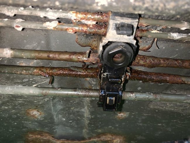

For the last week I've notice a gas odor coming from my car. I'm not sure if there's a leak because where I park my car, it's gravel/rocks. Someone looked underneath and thinks he saw slight dripping.Yesterday and today something new happened. I start my car, which starts right up. I go down my street (which is maybe 300 feet). After coming to a full stop at a stop sign, I step on the gas and nothing happens. It's like it's in neutral. After a few seconds it will slowly start to go until it's running normal again. At first I thought this was my transmission causing the problem until I remembered about the gas odor. One person suggested it could be the gas filter.

Clearly this is a serious issue because you should never smell fuel. If you smell it then clearly you have a leak that we need to find. What I would suggest is parking the vehicle in a parking lot (away from anything else) and turn the key to the on position. This is the position just before the start position that cranks the engine. This will turn the fuel pump on and pressurize the system. Once this happens you will need to look under the vehicle and try to find the general area that this is coming from. once we know the area that this is coming from then we will be able to better know what the possible causes or sources are. As for the issue of not moving, that could be related to fuel pressure but we need to fix the leak first and then see if that fixes the other issue. No sense in figuring that out if the vehicle is leaking fuel because it is not safe to drive so that issue doesn't matter as much right now.

My son did as you said, and it was coming from the second from the bottom pipe that you see in the picture. Whatever needs to be replaced, do you think an amateur would be able to do this? From the video that I just saw, maybe I should mention that the amateur is a plumber who deals with pipes.
Aug 9, 2020 at 7:50 AM

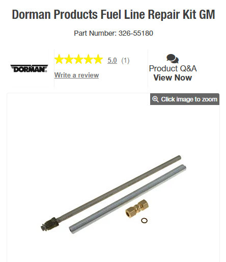

Oh my. Yeah that is the cause. Clearly this is something you need to decide if you are comfortable doing. If you are a plumber then this is nothing new but the only difference is this is a fuel line.
I am attaching a picture of a repair kit that basically you cut out the rusted line and splice in this new line. Otherwise you have to replace the entire fuel line and I would do each of those lines where the rust is. So to replace all those lines, that is a pretty extensive repair.
If you feel good about using this type of repair line then I would go for it because the principal is no different then repairing a drain line that has a crack in it. You don't cut the walls open and replace the entire pipe. You cut out the crack and use two connections and put a new piece in.

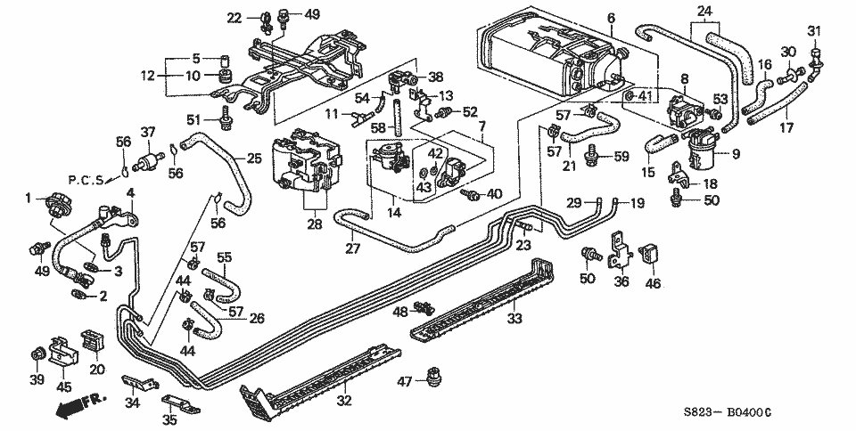

My ex husband fixed the leak, but the next day I had 4 other leaks in other areas. He said that both the in and out fuel lines both should be replaced. He can do the job, I just need to buy the parts. The problem I'm having is finding what exactly I need. Do these lines have a specific name? I called up AutoZone and there was nothing coming up on their computer, which I don't understand. Maybe she wasn't putting in the correct term?

I found one diagram on the internet but I think it's for a 2.3. I have a 3.0 if that matters. This is the diagram from that. He says I need # 19, 23, and 29. Is that correct and what are the actual names so I can order them?
Sep 8, 2020 at 3:52 AM
These lines are called the fuel supply and return line. I attached some diagrams for your vehicle.
If he wants to, he can just get some straight fuel lines and remove the old then bend the lines to match the hold ones. This is much easier then it sounds and much cheaper.
If not, then just sourcing fuel lines, supply and return, would get you the parts you need. Let us know if you have other questions. Thanks

You can use rubber fuel line but if you do and it runs outside the vehicle and underneath it is most likely going to get cut by a rock or something else. This is why they use metal lines. Also, the rubber will dry rot eventually.
However, if you are not comfortable bending the tube then they do make repair kits. Just do an internet search on fuel line repair kits and you will see where you need to cut the damaged line out and splice in a new metal line.
Again, this is not the best idea because if you have multiple spots, you have a lot more joints that can leak. However, it may be your best solution and then use rubber line on any bends that you need to cut out.
