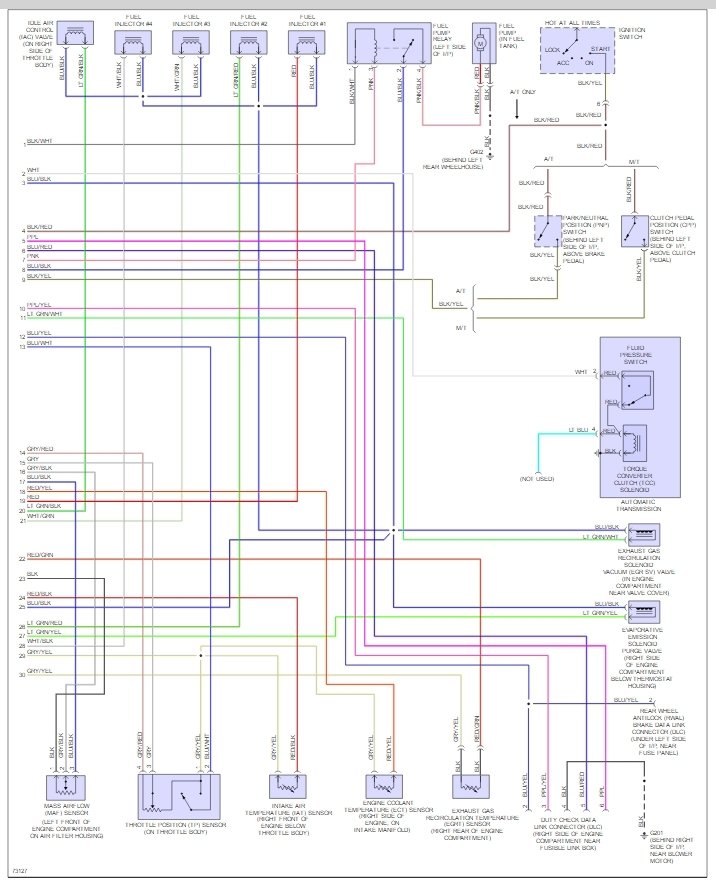

Changed fuel injectors. Now the gas is leaking in to the oil. Before change the fuel injectors the gas was leaking out the exhaust.

Hey William,

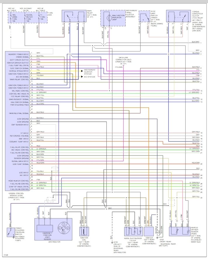

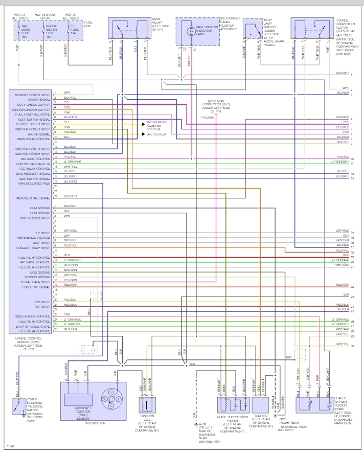

It sounds like you might have a system ground that is off, if it all checks out the computer is bad because you have an injector driver that is stuck on.
Here is a wiring diagram that will help you
Let me know what you find,
Best, Ken Lavacot
