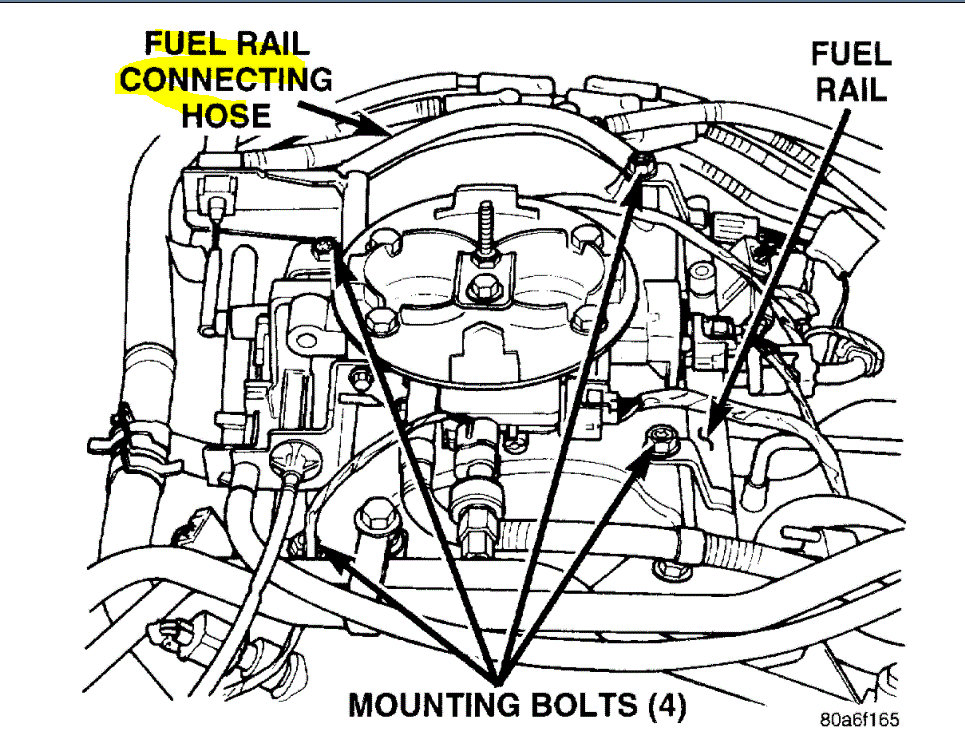

When It happened I lost all power only could drive 10 MPH so limped it home and now it won't start and there is gas leaking on back side of motor.

If it's leaking on the rear of the engine, it sounds like the fuel supply hose is bad. Also, that would cause the fuel pressure to drop enough to prevent starting.
I attached a pic below and highlighted the fuel supply. Follow that line and see if you can determine where it is leaking.
