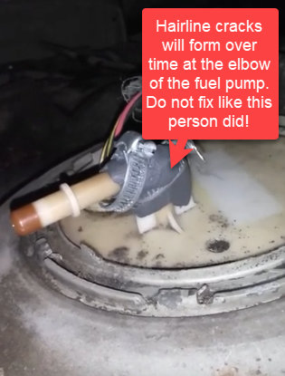

my car is leaking gas I can smell it and so do others. it has been doing it now for about a month and I keep putting gas in and wasting my money. I did try to put something underneath the car when I stopped it evaporated too quickly to tell where it was leaking from. what should I do? I don't have very much money for mechanic, but I have some friends that may be able to help me.

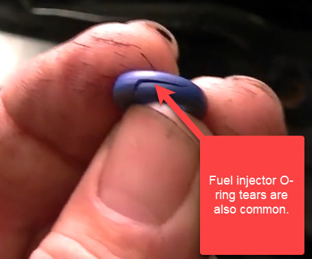

Fuel tank leaks can be tough to find if they come from the top of the tank, especially from the fuel pump area. I've included two pictures of common failure points from this particular vehicle.
