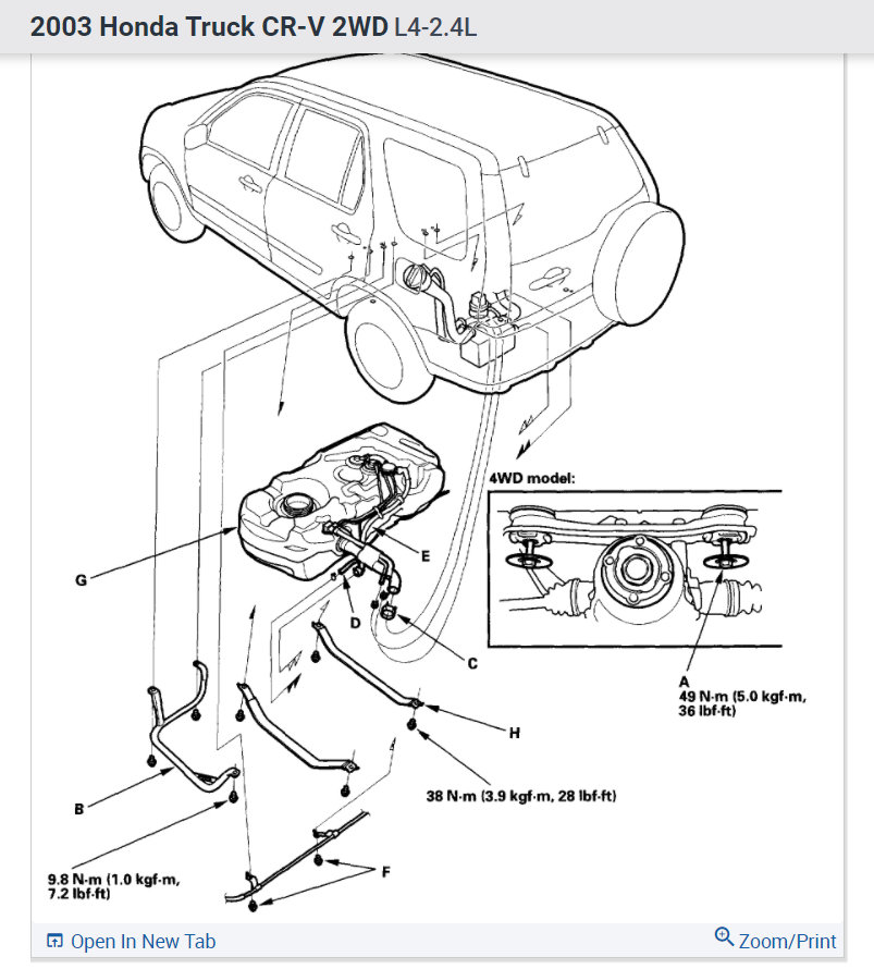

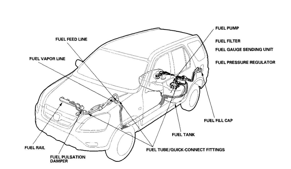

Gas will leak out of car, especially when I fill the tank up. What could this be due to?
May 25, 2021 at 2:10 AM
  • 55,743 POSTS
Can I ask where the gas seems to be leaking? front back? if it is from the back it sounds like the filler neck needs to be replaced here is how in the diagrams below. Check out the diagrams (below). Let us know what happens and please upload pictures or videos of the problem.
