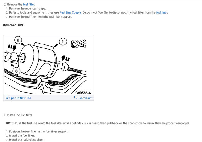

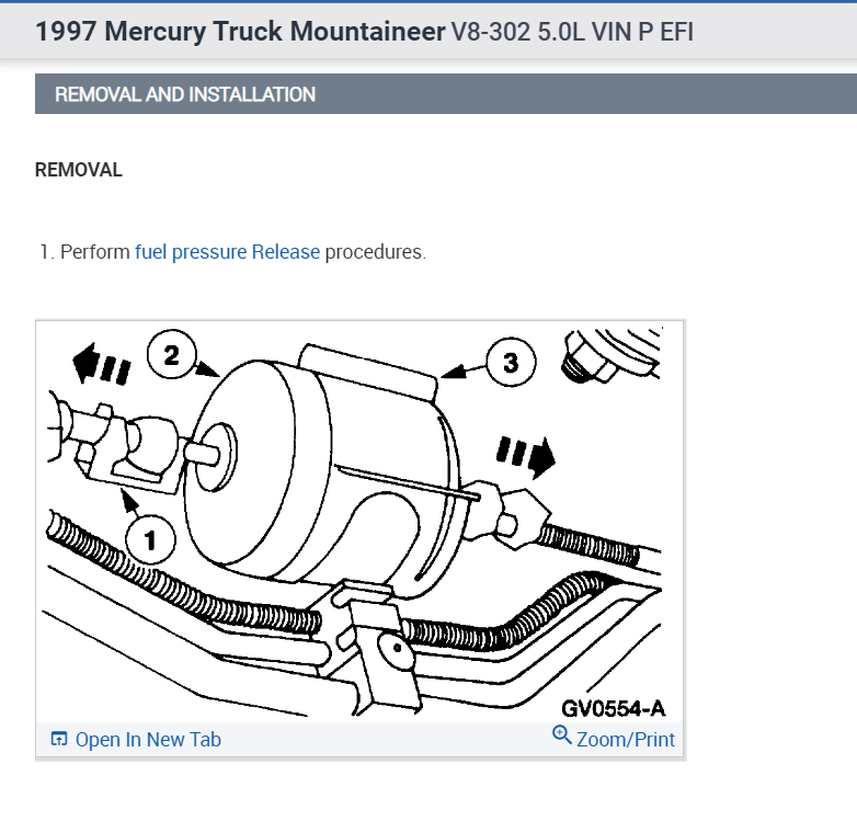

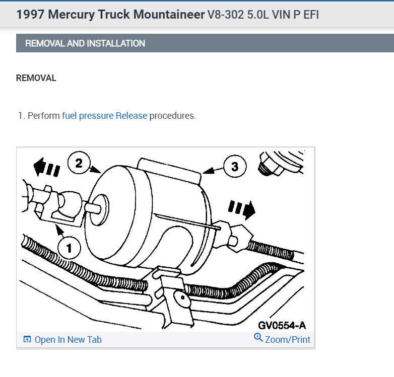

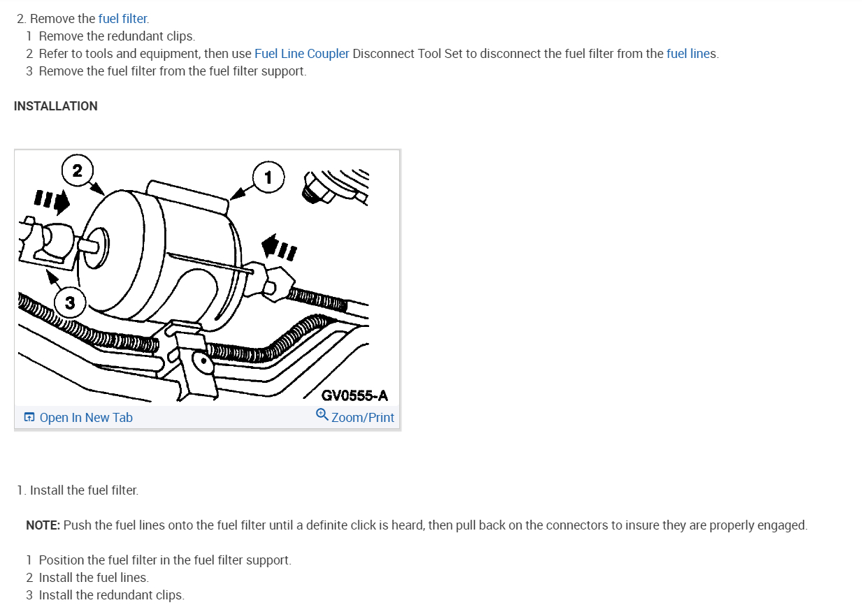

This sounds like low fuel pressure but to be sure let's go over this guide and run the test. You can get a fuel pressure gauge test kit from the local auto parts store for cheap or free. Here is a guide to help you step by step and the instructions in the images below for your car. It could be a clogged fuel filter as well.
and
https://www.2carpros.com/articles/how-to-change-a-fuel-filter
This video will help:
https://youtu.be/wi6kzRjk5to
Fuel system pressure should be between 201-310 kPa (35-45 psi).
