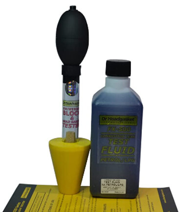

A fuel smell in coolant is a good indicator of a blown cylinder head gasket, a warped head, or a combination. With the engine running, remove the radiator cap (but only when the car is cool!) and see if you observe any gas bubbling in the coolant.
Best to carry out a carbon monoxide test for the cooling system using a chemical block tester.
