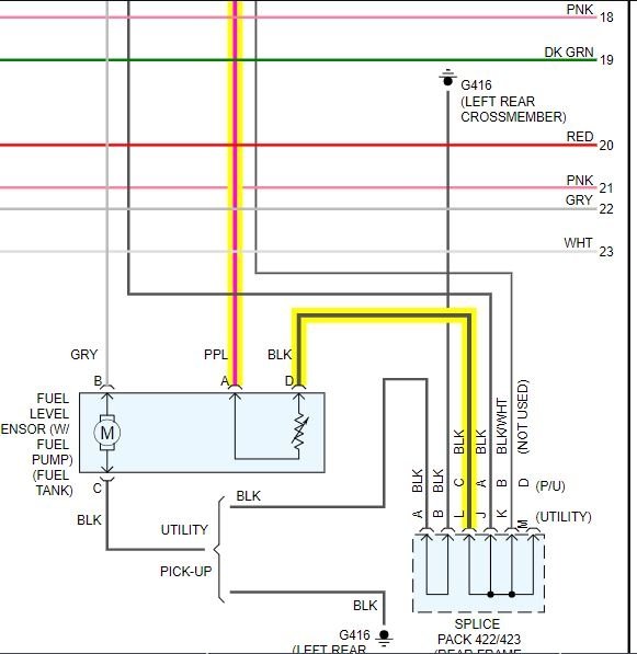

The gas gauge jumps from full to empty while driving.
Nov 24, 2019 at 1:41 PM
Good evening.

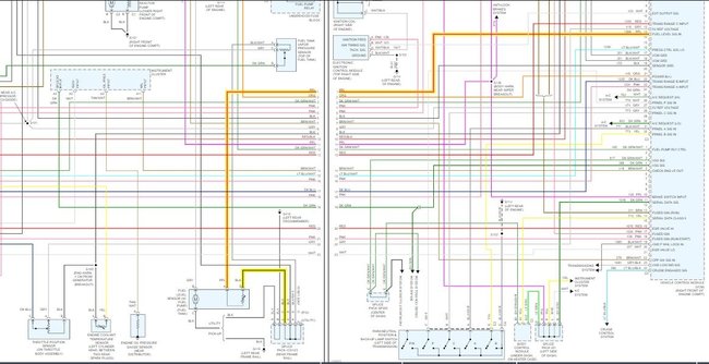

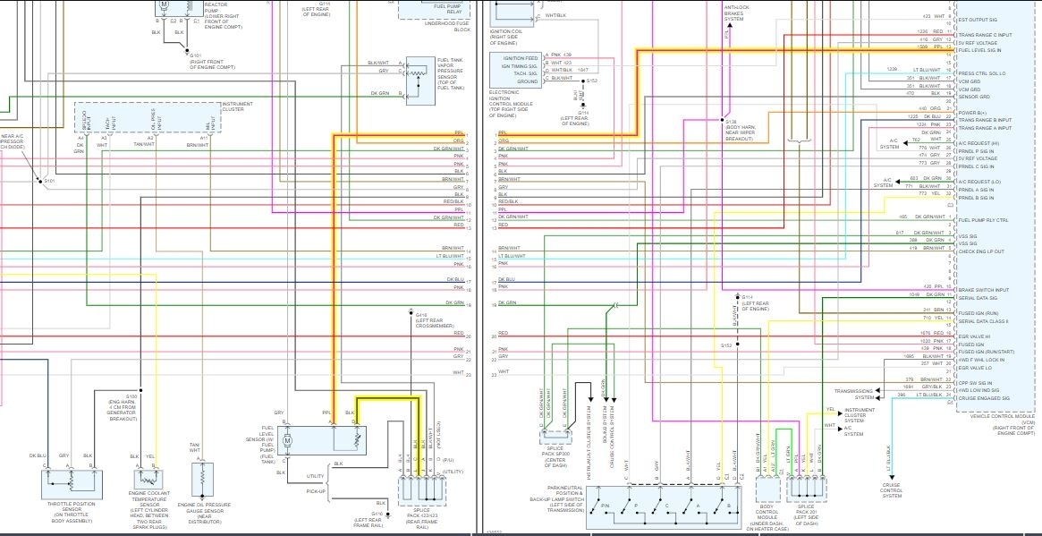

This could be a bad connection at the fuel module at the tank, it could be a bad connection at the cluster or a bad cluster, or it could be a wiring issue.
I attached a diagram for you to view. start with the connection at the fuel module. That is the most common failure for this issue. Check the purple wire at the connector.
