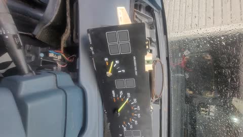

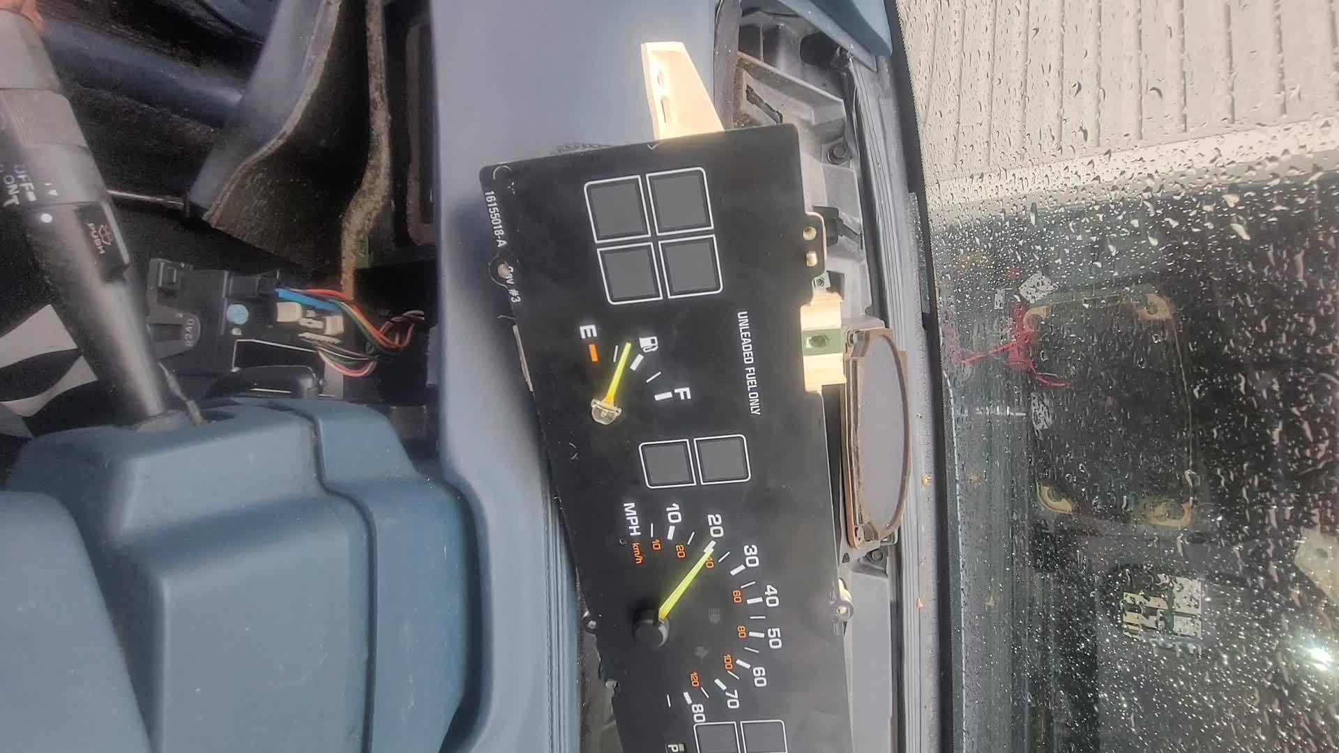

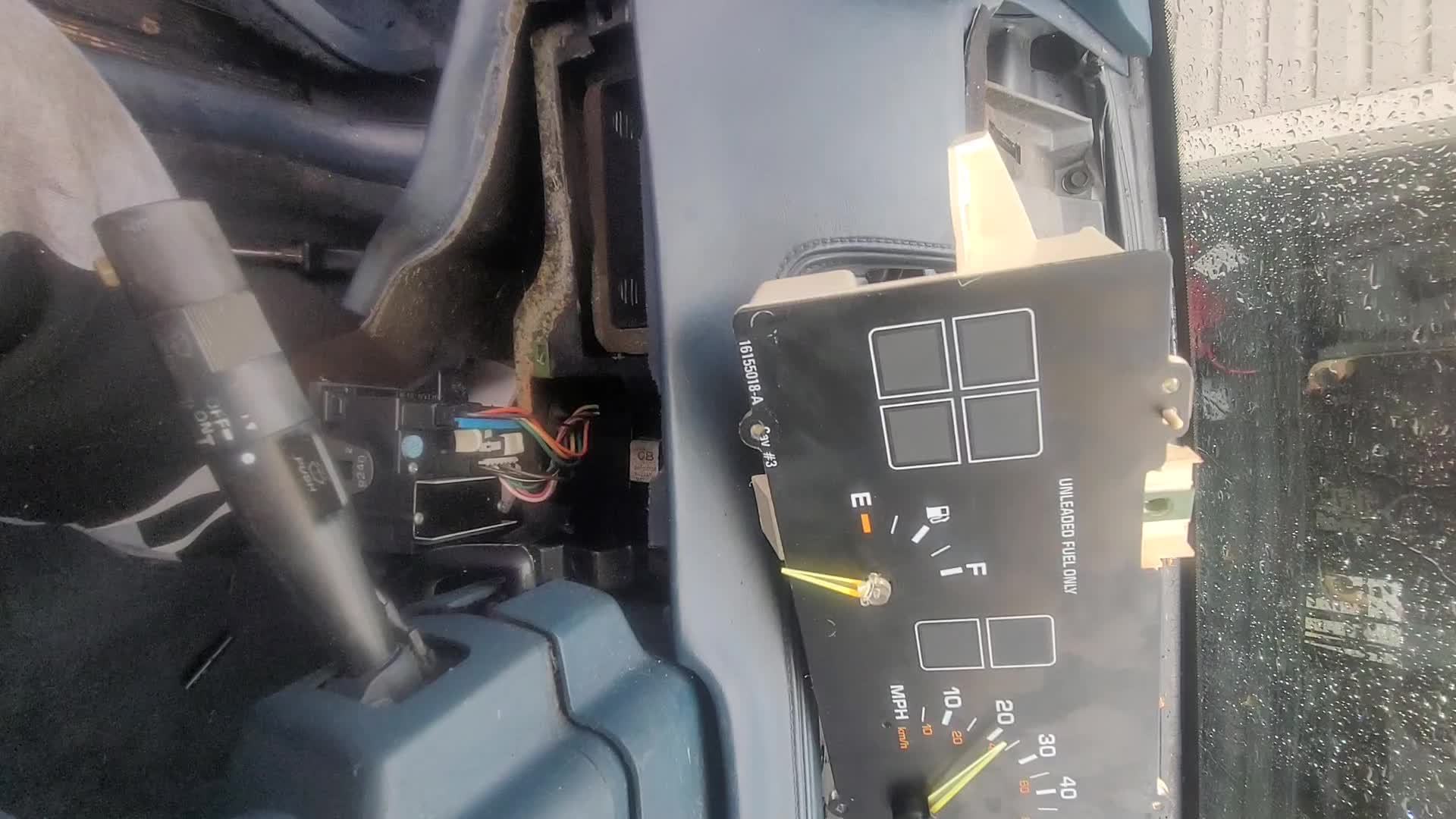

My gas gauge is buried below E. I replaced sending unit but don't know where to go from here. Any help is appreciated. I shared 2 videos on what I'm looking at. Thank you

More than likely the gauge is the issue, and the cluster is going to have to be replaced.
The way to confirm this is to check the voltage at the gauge when you are filling the tank.
Basically, you should see the voltage drop as the float in the tank comes up.

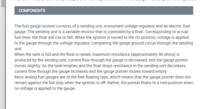

If it does, then the sender is operating but the gauge which is just a free-floating gauge, and the voltage is what moves it one way or the other.
It should float in the middle of the gauge somewhere when the ignition is off and then when you turn it on, the needle will go to the correct location.

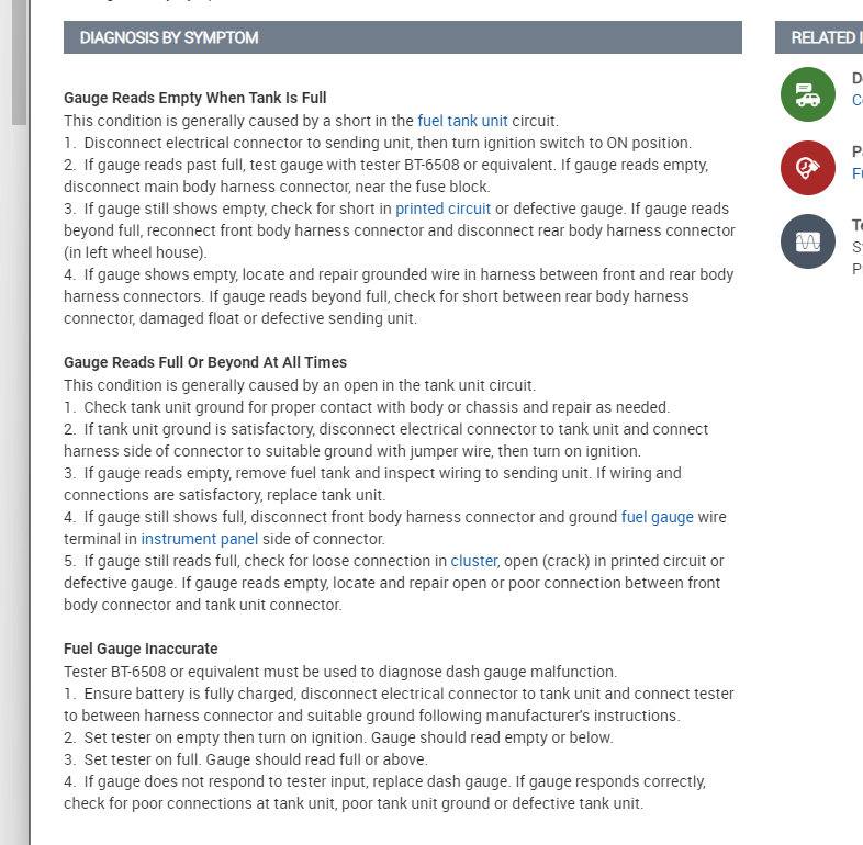

Here is a guide that will help with this:
I am attaching the testing below which will tell you how to do this except in reverse.
They have you go to the pump and check the operation of the sender.
Take a look at this and let me know what you find. Thanks

Do you mean to put another fuel gauge on the vehicle? Sure, you can do that if the sender and wire are fine, and the gauge is the issue then that will work.
The only thing you need to look for is a free-floating analog type of fuel gauge.
Do you remember when it was working if when you shut the vehicle off that the gauge would hover near the middle of the range? Then when you turn the ignition on it would go to the correct fuel level position?
If it does, then it is a free-floating gauge.
It won't matter if you can't find this as long as it is an analog gauge it should work.
Mar 8, 2022 at 4:20 AM

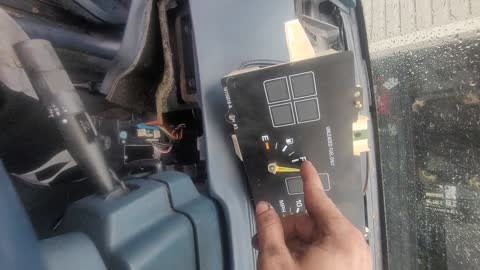

I bought the vehicle like that. It was buried past full until I moved it one time manually then it dropped down and will not move back up.
Mar 8, 2022 at 6:48 AM
Okay. Yeah, it sounds like a gauge issue so I would think the voltage to the gauge is fine but if you want to check it, you need to monitor the voltage while filling the tank and make sure the voltage slowly drops.
Mar 8, 2022 at 4:56 PM

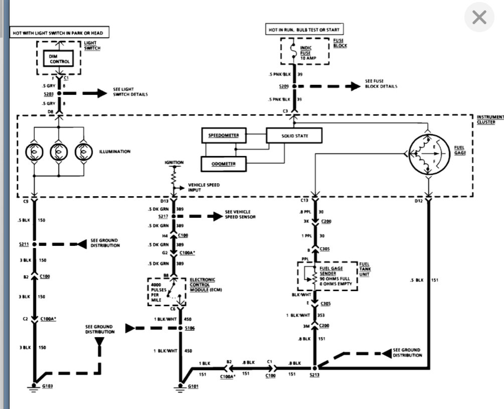

Take a look at the wiring diagram below. There should be a purple wire so you can do it one of two ways. You can check the voltage or the ohms.
I would suggest doing both but as you can see it says that there are 90 ohms when full and 0 when full.
This means as the tank fills up the voltage should drop. So, it depends on how much fuel is in the tank when you start but as you fill it, you will see the voltage slowly drop. This just proves that the sender is not the issue and that there is an issue between the two points in the gauge.
