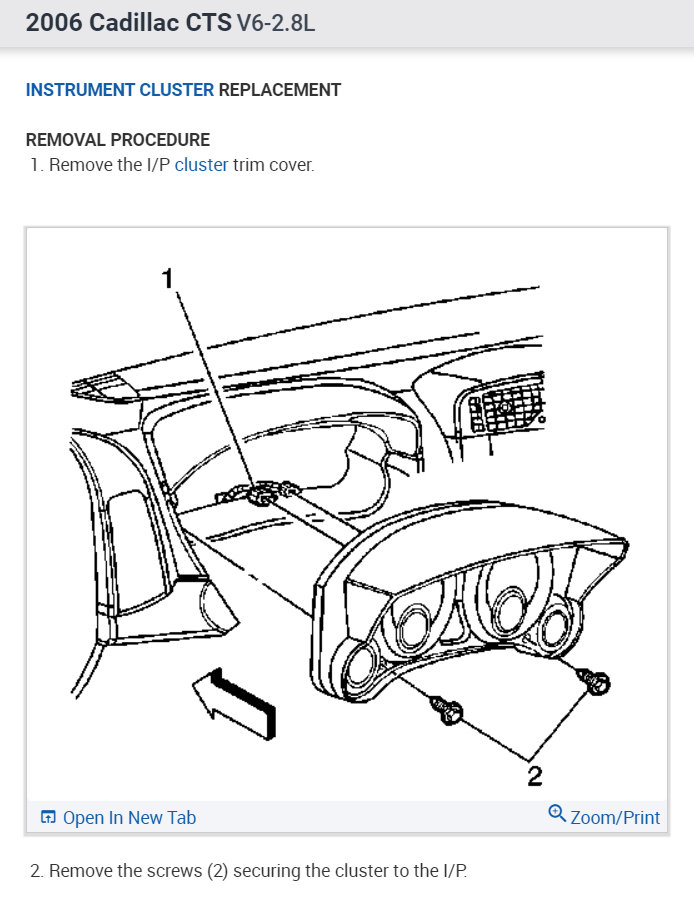

Gas gauge, temperature gauge not working. traction control light,service theft system light on. Ran codes, shows no codes. there are no signs of actual problems occurring. Anyone have this problem?
Dec 16, 2019 at 11:11 AM
  • 55,433 POSTS

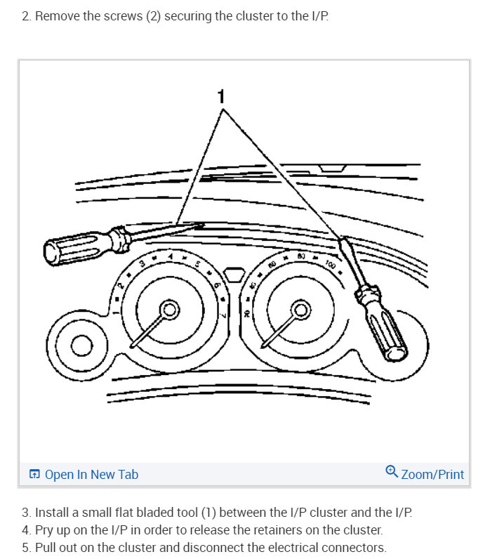

I have seen the instrument cluster go out causing this issue. here is a video showing the job being done on a similar car with diagrams below to help show you on your car:
