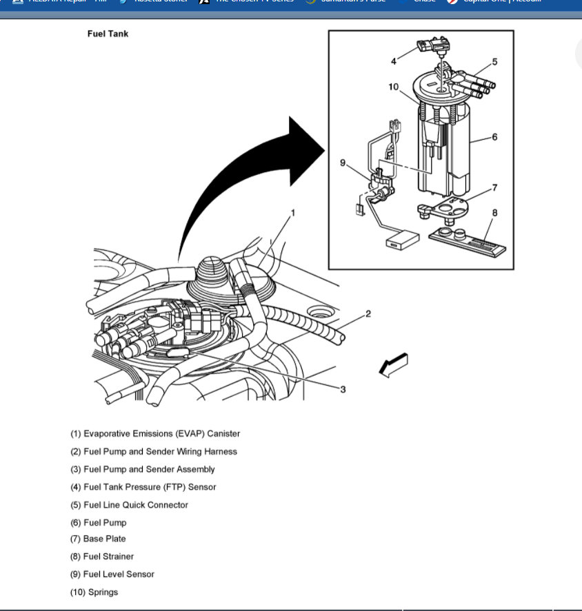

First one, gas gauge always reads full. Doesn't go back and forth, it just always reads full.

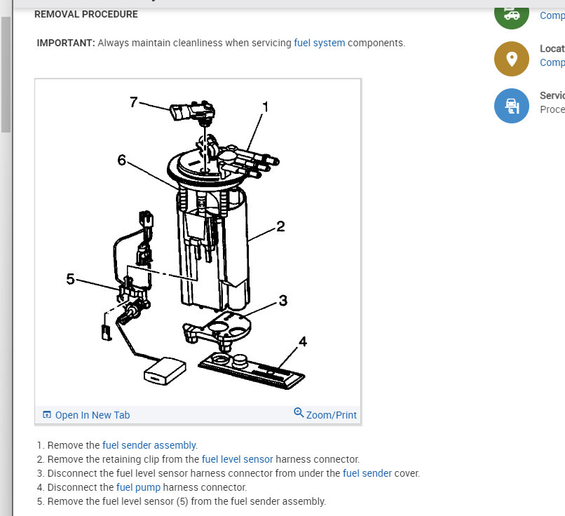

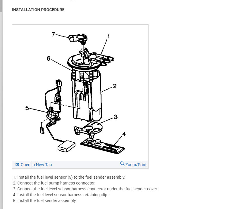

Let's start with the fuel gauge issue as these are separate issues.
The fuel gauge issue is most likely a faulty sensor. The sensor is in the tank and is part of the float. I am attaching the info below, but we need to test this by checking the voltage coming from the sensor and if it is steady and does not drop when you are filling the tank with fuel then the lever is stuck, or the sensor has failed.
I am attaching the info below. Please run through this and let us know what you find.
