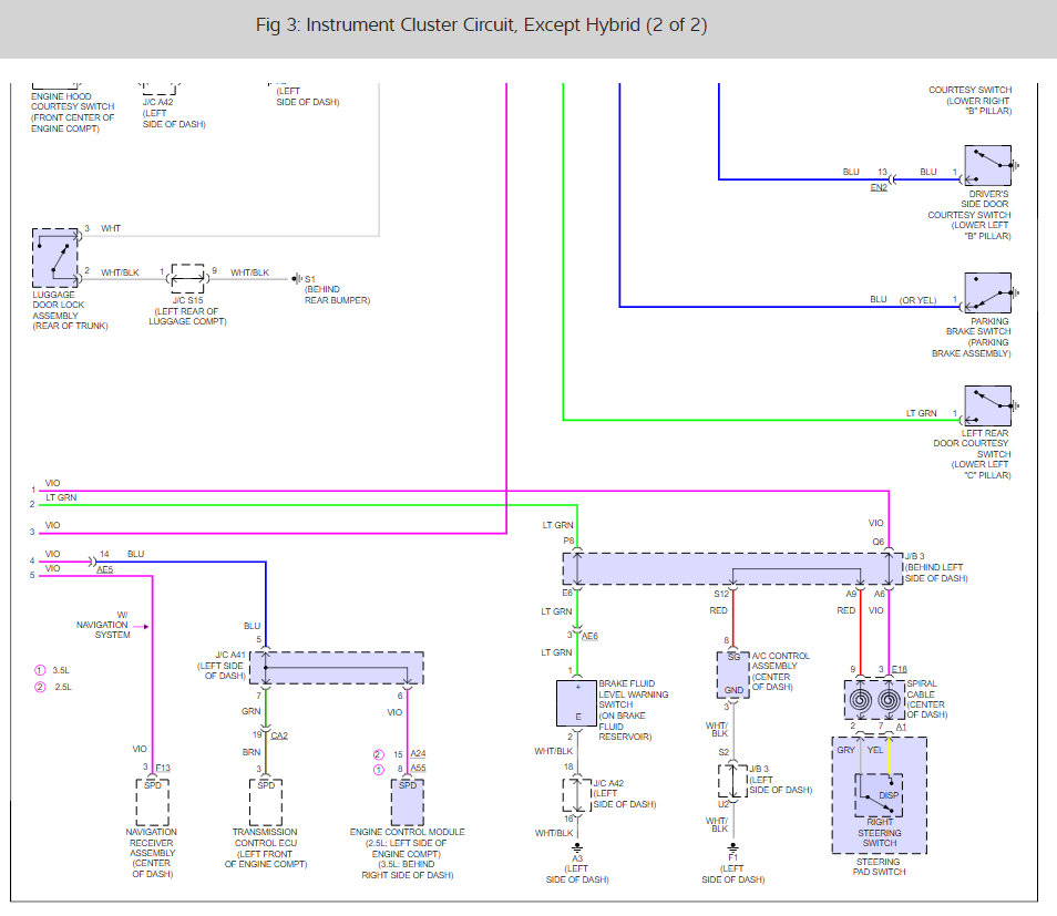

after i put in gas and filled it to half a tank, the gas gauge went down to empty in just over an hour of continuous driving. i filled it to half a tank again and drove for 30 min. and it went down almost to a quarter of a tank and it usually barely moved after 30 min. is the gauge off? i see no gas leaks.
I had filled it up to a half a tank again according to the gas gauge and right after five min of driving the gas gauge already started going down and it never does that fast. I looked under the car and under the hood and I do not see or smell any gas. And no, kids cant steal my gas because I have a lock on the gas fill door.
Oh and no I have not done any modifications and yes the check engine light is on but that has been on because I am overdue for an oil change.
Thank you for your help! Oh and yes with new Toyota a check engine light will come on when all you need is an oil change its crazy.

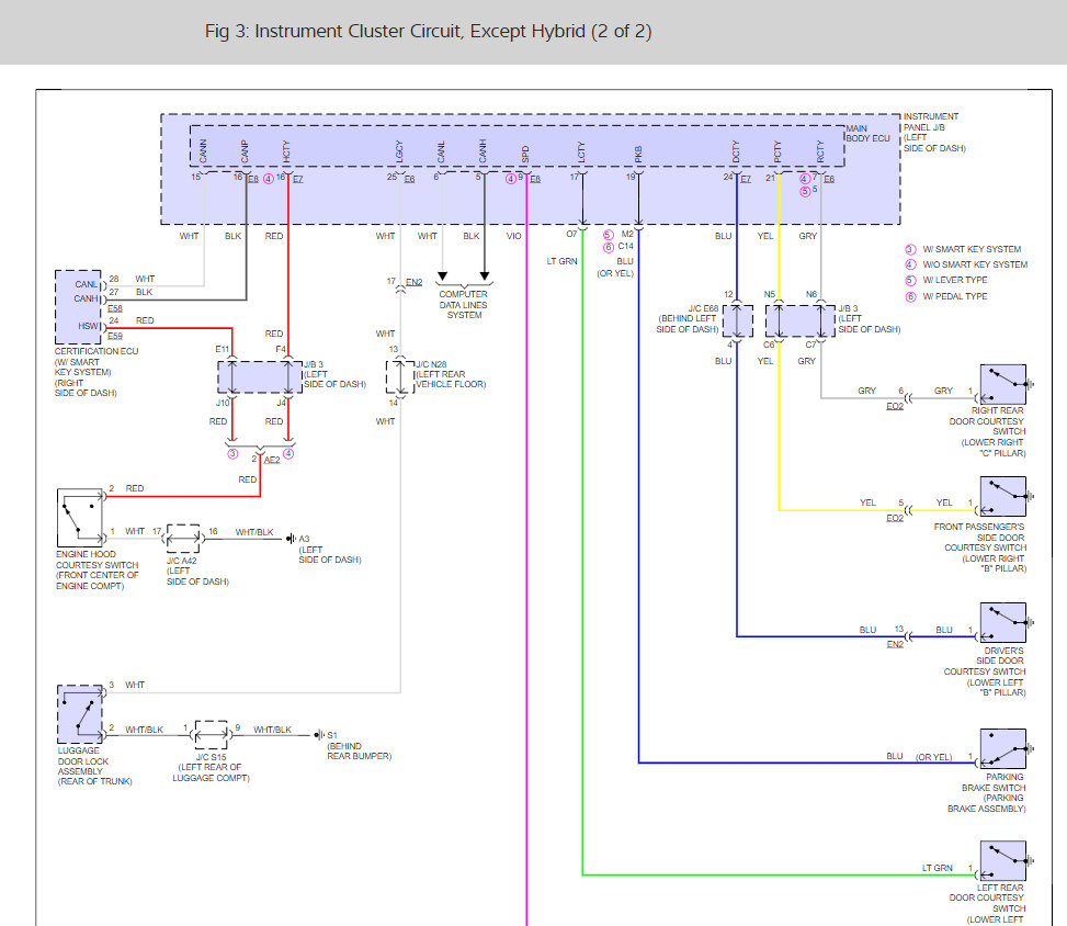

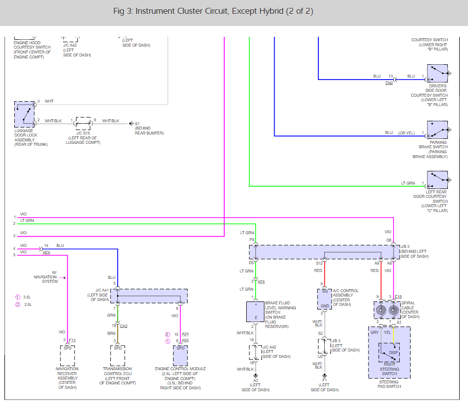

Hey Ryan,

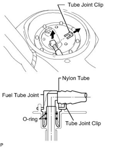

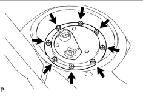

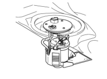

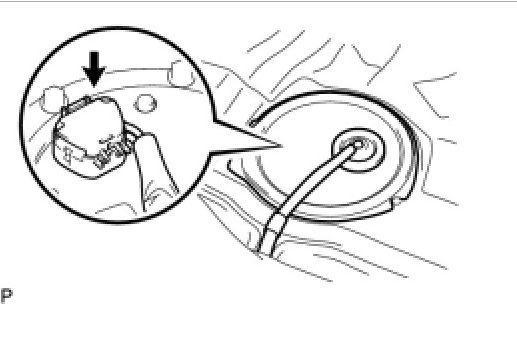

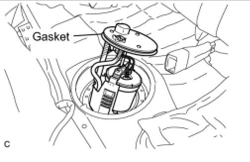

It sounds like you have a fuel level sender that is going bad. This bad connection can cause the fuel gauge to do all kinds of weird stuff. You can get to the float and fuel pump by removing the back seat.

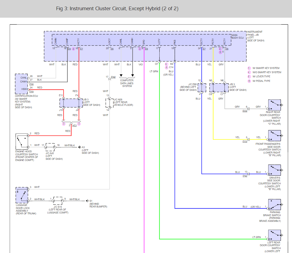

Here is a fuel gauge wiring diagram so you can see how the system works. (below) I would also try unplugging the cluster and plugging it in again this will help clean the connections at the cluster.
The problem of gas consumption could be attributed to a mass air flow sensor that has gone out of range and needs replacing. This kind of problem with not turn the check engine light on. Here is a guide on how to replace it.
https://www.2carpros.com/articles/how-to-replace-a-mass-air-flow-sensor-maf
If it is a gas gauge problem, in others words and gauge goes down but when you fill it up it does take very much then the problems is most likely the sender in the tank has gone out and needs replacement.
Please let us know happens so it will help others.
Best, Ken
