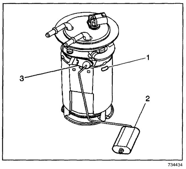

My gas gauge is acting flakey. All other gauges are fine. At start up it goes to full and stays there even though I know it only half full. It eventually comes back down. It also sometimes shows low gas light when I know its not true. I replaced the entire unit several years ago. I don't know what to do. Any help would be appreciated.
Thanks,
Chris
Sep 15, 2020 at 3:39 AM
  • 110,240 POSTS
Chris,

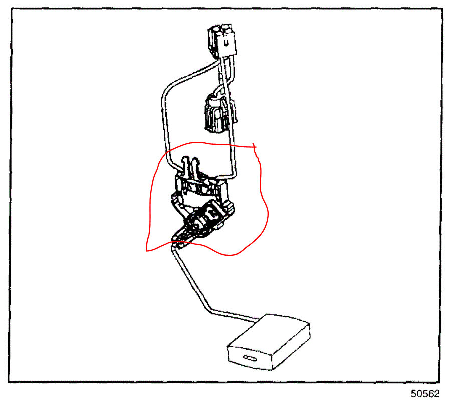

What you described sounds like the rheostat on the fuel level assembly in the tank is bad. The fuel level sensor consists of a float, a wire float arm, and a ceramic resistor card (rheostat). The position of the float arm indicates the fuel level. The fuel level sensor contains a variable resistor which changes resistance in correspondence with the position of the float arm.
The only way to confirm this is to remove the unit and check resistance from the rheostat. Basically, when moving the float up and down, the resistance (ohms) should change.
If you look at pic 1, I circled the part I'm referring to.

FUEL LEVEL SENSOR REPLACEMENT
REMOVAL PROCEDURE
pic 2
1. Remove the fuel sender assembly.
2. Disconnect the fuel pump electrical connector.
3. Remove the retaining clip from the fuel level sensor connector.
4. Disconnect the electrical connector from under the fuel sender cover.
5. Remove the sensor retaining clip.
6. Squeeze the locking tangs and remove the fuel level sensor (3).
