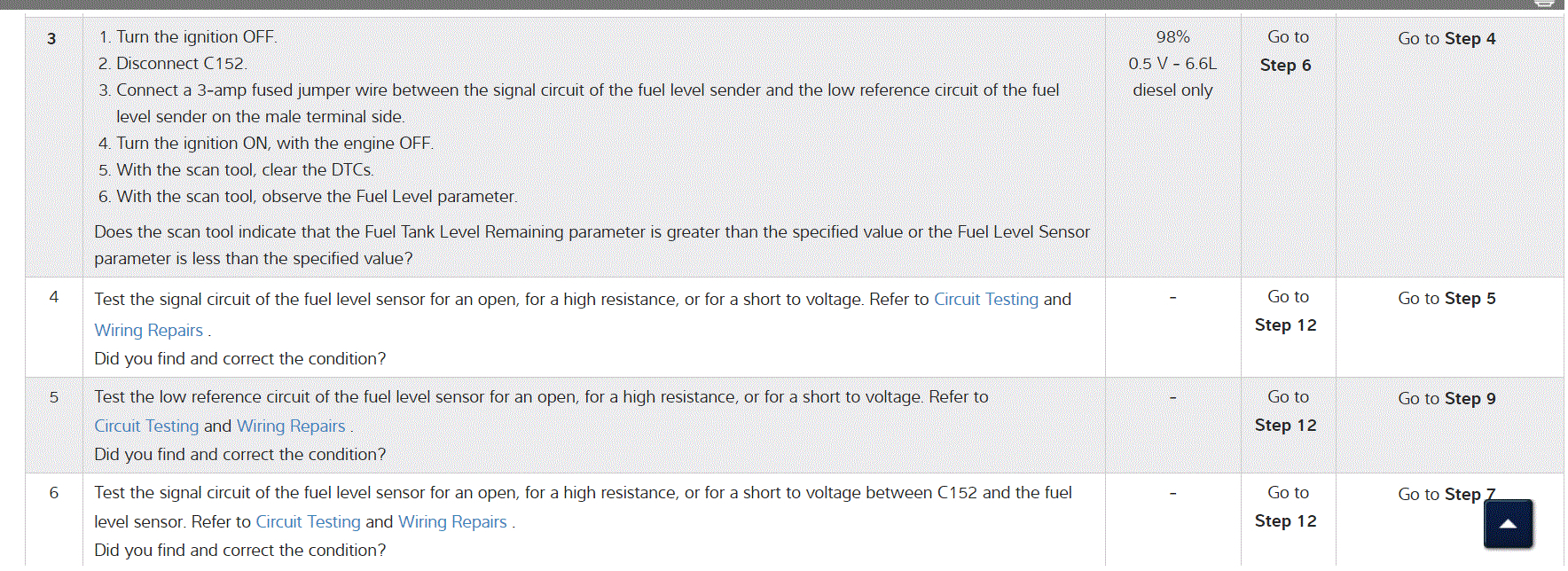

I’m so happy to find this site. I have the truck listed above (classic). My check engine light came on recently. Then I noticed the gas gauge may register low. It may register accurate. It may be some where between. But I don’t think it ever registers more than what’s in the tank. I’m mechanically inclined but ignorant about this topic. I want to repair it myself. I put my programmer on it and got the code P0463. From my internet research, it could be a number of things from the cluster to a sensor on top the fuel tank. I’d like to narrow down my options to diagnosis it. Any suggestions? Thanks!
Dec 2, 2020 at 6:50 AM
  • 110,244 POSTS

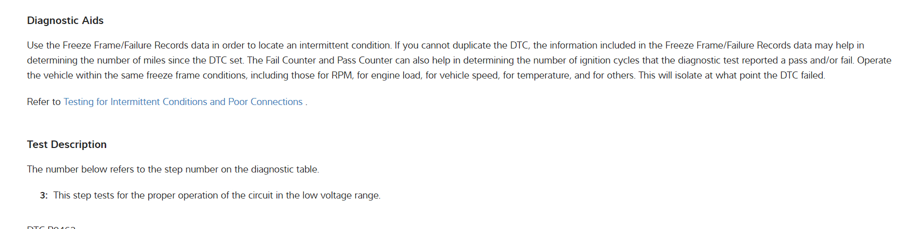

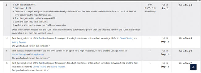

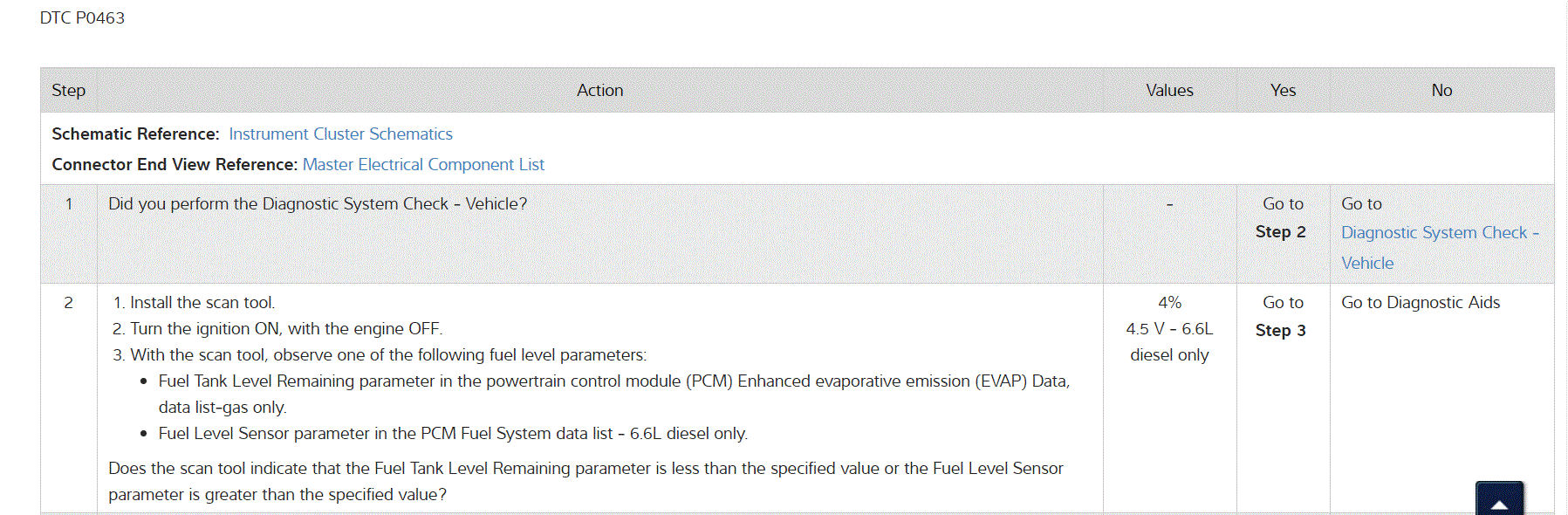

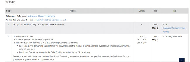

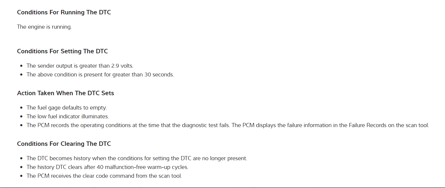

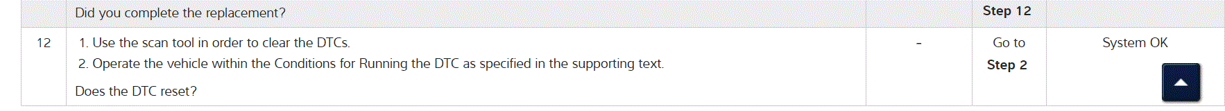

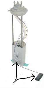

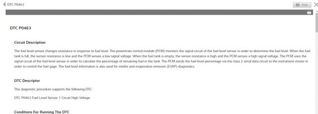

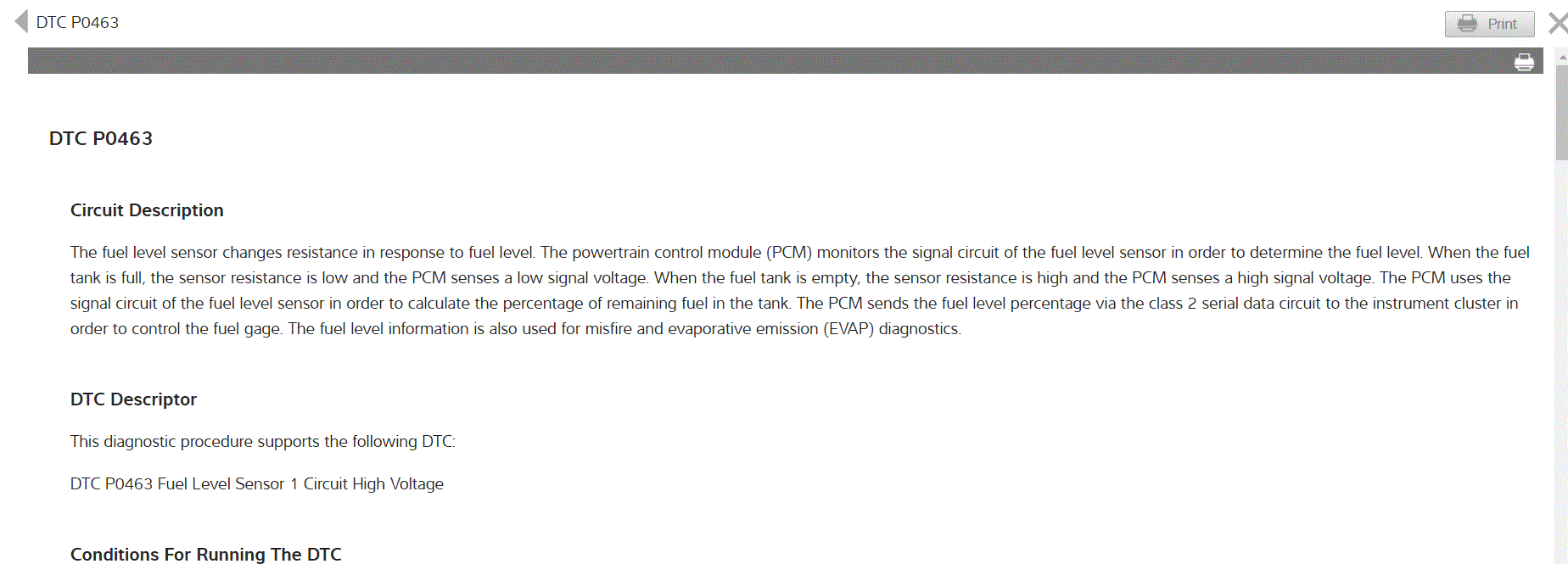

In the tank, there is a float that is attached to a rheostat. The rheostat sends a voltage signal to the PCM which goes to the BCM and then to the gauge. Ugh!! A lot of things there.
I suspect the rheostat is bad or the float is going bad, However, If you look through the attached pics, they indicate the diagnostics for troubleshooting the issue.
Let me know if they help or if you have other questions.

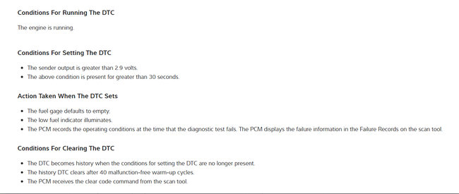

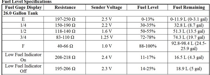

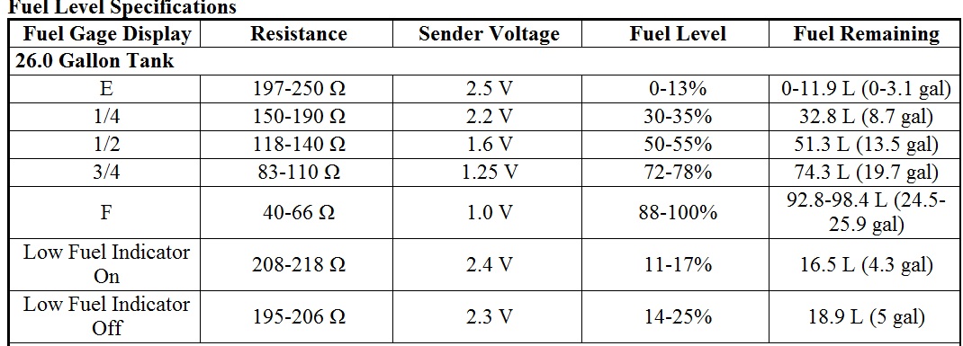

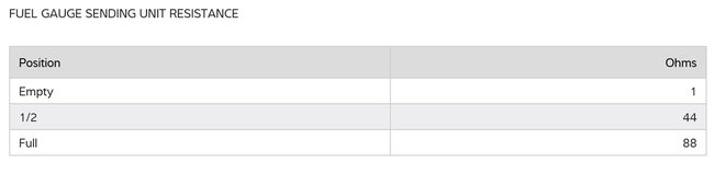

The info I looked at was for 5.3L vin B, single tank.. The gage will default to empty if, the pcm detects a problem with sending unit circuit or if the ipc detects a problem with class 2 data from pcm.
You may be able to check gage reaction with resisters, get about three, 250 ohm--empty, 140 ohm--1/2 tank, 66 ohm--full tank. If the gage reacts correctly to each resister, I think the problem is the sending unit in the gas tank. If it doesn't react correctly could be a problem with pcm--ipc or wiring circuit.
The wire colors for the sending unit are black--ground, dark blue-- voltage. If you use a resistor between those two wire colors, key on, no need to start it, the gage should react. The voltage is a 5 volt ref circuit from the pcm.
You can get resisters from radio shack, don't cost much. You can also check for applicable trouble codes. Some of the national brand autostores will check codes for free. I just don't know if they will check manufacturer specific codes?

In the info, notice the tank size in gallons, the specs may change depending on the size of the tank. That's where I would start.

If the pump unit had the swing arm and float, then yes. You should be able to take the connector loose from pump assemble, use a resistor between proper two terminals, key on, see if gage reacts to resistor, try a couple resistors for full and low. The resistance spec is in the diagram. Radioshack sells resistors, don't cost much. If the gage reacts properly then the problem is either the sending unit or connector.

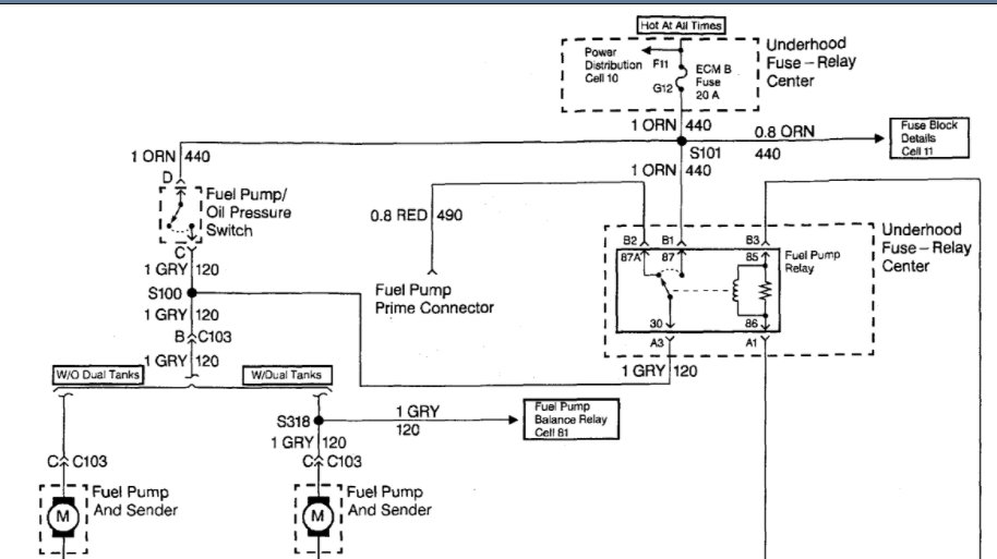

JDL
  • 16,098 POSTS

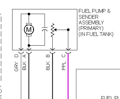

Wanted to show sending unit circuit. Except hybrid.
Purple wire and black wire is for sending unit.
Jun 2, 2021 at 5:35 AM (Merged)

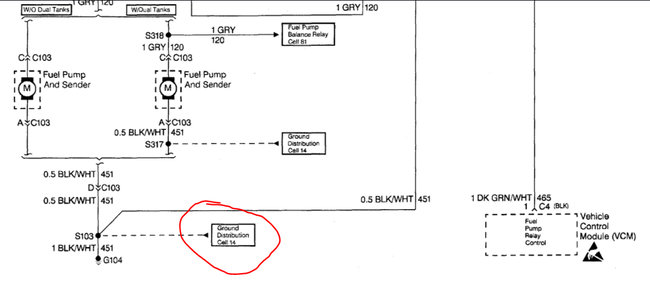

Hello, I'm Danny.
The 1988-1998 Chevrolet obs had a problem causing weird gas gauge related problems. You should first check the fuel pump- sender ground wire that attaches to the frame. There is also a ground strap that goes from the fuel tank to the frame. Sometimes road debris or road conditions can deteriorate are dislodge-destroy the ground strap and create havoc with the fuel gauge. Here is a wire testing tutorial for you as well:
I've attached a fuel pump wiring diagram below for your truck. The ground is cell 14 and I circled it in red. Let us know what you find after you clean, check and inspect the ground wire and ground strap. Hope this helps and thanks for using 2CarPros.

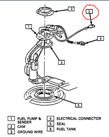

Hello, I'm Danny.
There has always been issues with fuel gauge problems on the 1988-1998 Silverado's. The most common being the fuel pump ground. I would get under the truck and clean the ground connection first. Here is a tutorial show how to test wiring:
I've attached a picture below and circled it in red. Also, Since the fuel sending unit is part of the fuel pump assembly has it ever been replaced? Hope this helps and get back to us after checking the ground and we'll go from there. Thanks for using 2CarPros.

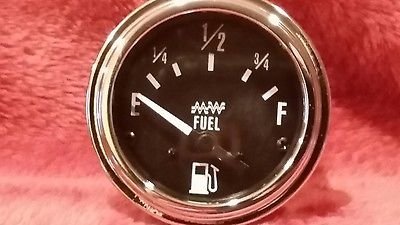

Hi I want to install a Fuel Level Gauge. My cluster fuel Level gauge does not work. How would I install a Fuel Level Gauge? Where would I run power from to make it work. This is what I am looking to install. Thanks.
Jun 2, 2021 at 5:36 AM (Merged)
SEAN SILBERHOLZ
  • 44 POSTS
This is what I am looking at.

first does the current gauge read full or empty. have you tested to see if sender is working. are there instructions with the new gauge you want to put in? one wire will need low voltage to operate it like 6-7 volts other to sending unit and other to ground if a 3 way connection. see pics how to check current problem.
