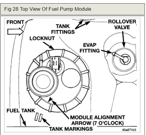

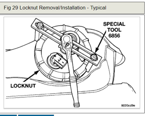

My gas gauge started to go down to a quarter and stop now it stops at half. I am going to try some Gumout multi system tune up to see if maybe there is some corrosion on the float. I do not drive this SUV much. Maybe twice a month.
May 18, 2018 at 9:44 PM
  • 55,224 POSTS

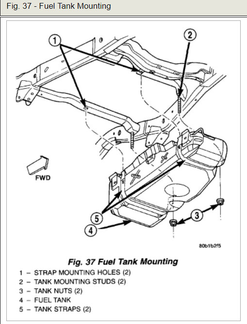

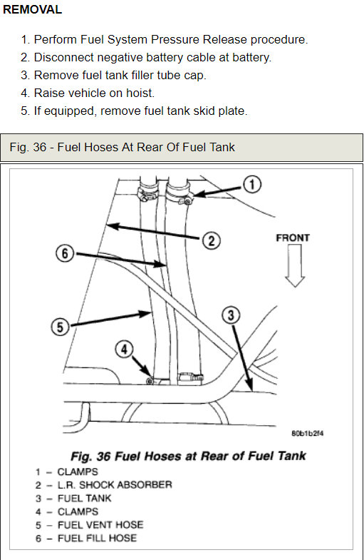

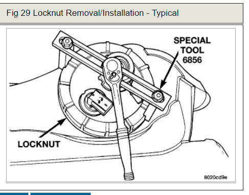

It sounds like you have a float sender that is out which is common with cars that sit a lot. To fix the issue you will need to remove the float sender and replace it. Here is what you are in for when doing the job:
https://www.2carpros.com/articles/how-to-replace-an-electric-fuel-pump
May 20, 2018 at 6:00 AM

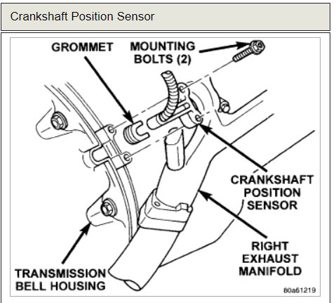

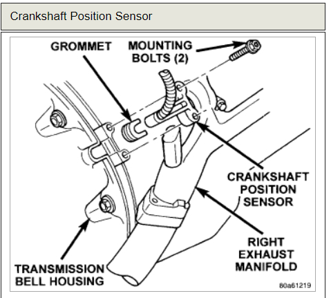

Hi Ken, I filled my tank yesterday and added Gumout multi system tune up. I got in to go this morning and it turned over but would not fire, I have not had any trouble with it firing up and it ran fine. I can hear the fuel pump run when i turn the switch on maybe the coil is bad. What do you think?
May 20, 2018 at 8:34 AM
  • 55,224 POSTS
It sounds more like a crankshaft angle sensor. Here is a guide that will show you what you are in for when doing the job:
This guide can help as well.
Please run down these guides and diagrams and report back.
May 21, 2018 at 2:48 AM
