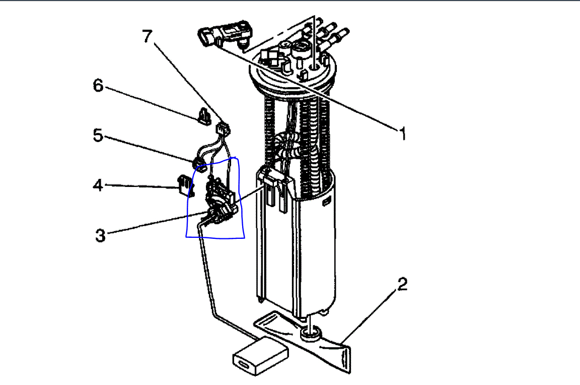

Chances are it is either a bad ground or the fuel level sensor, which is a rheostat, is bad.

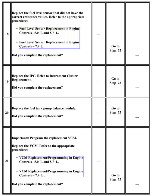

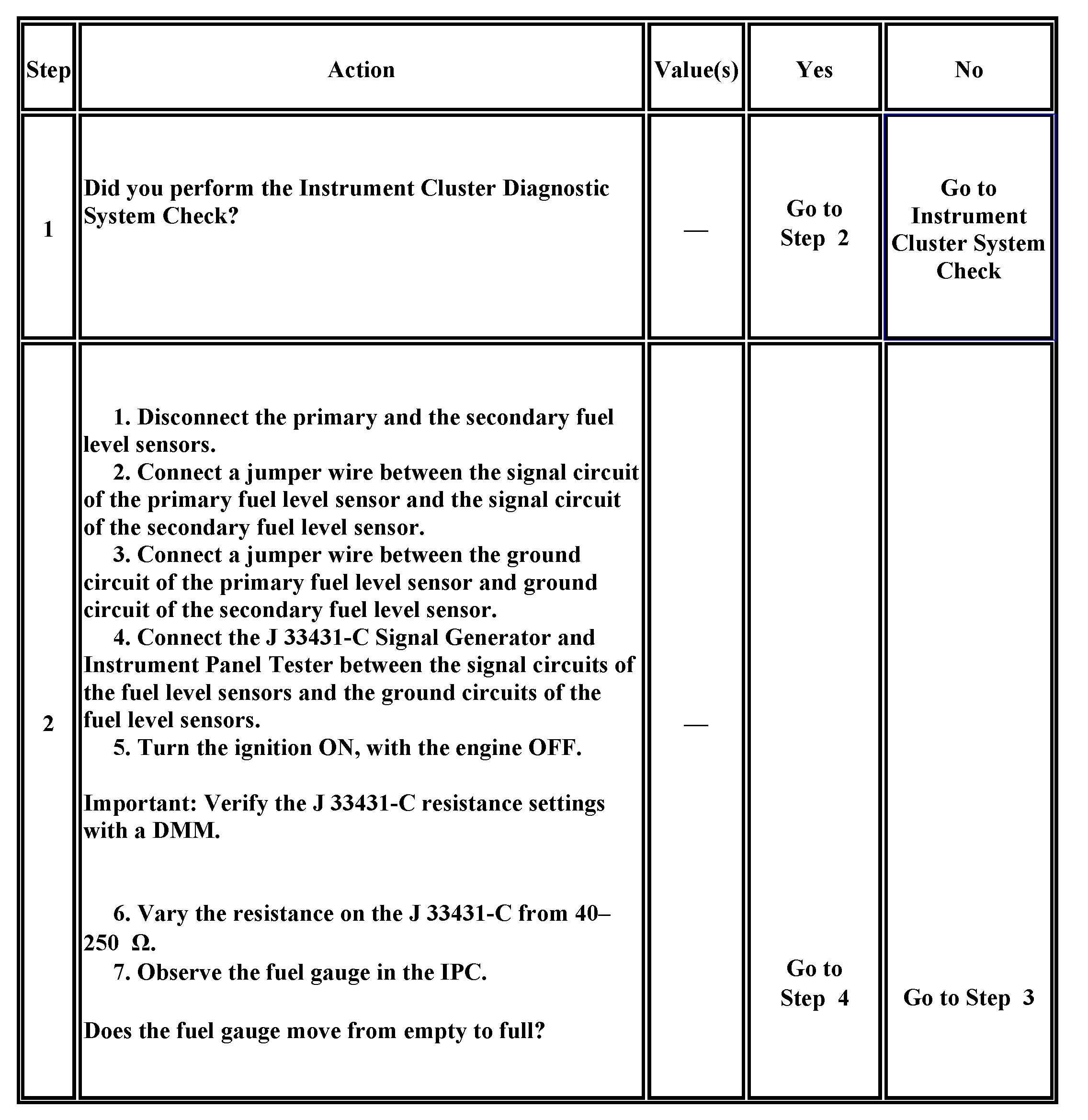

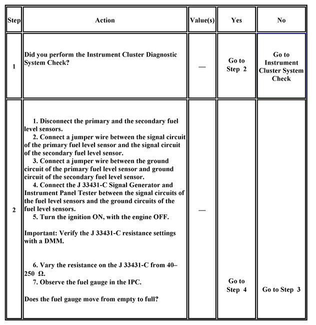

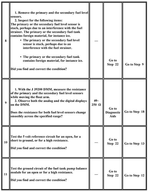

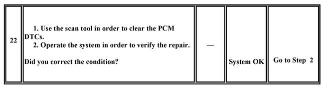

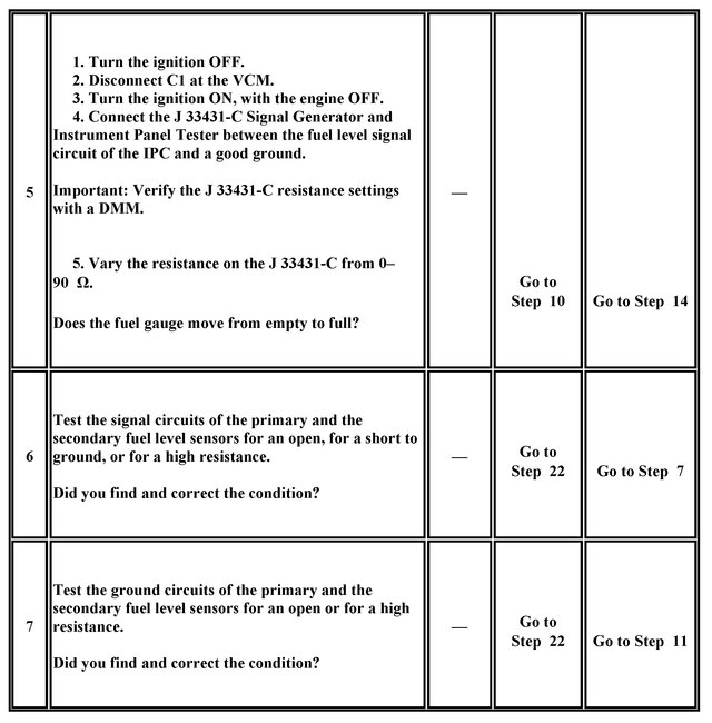

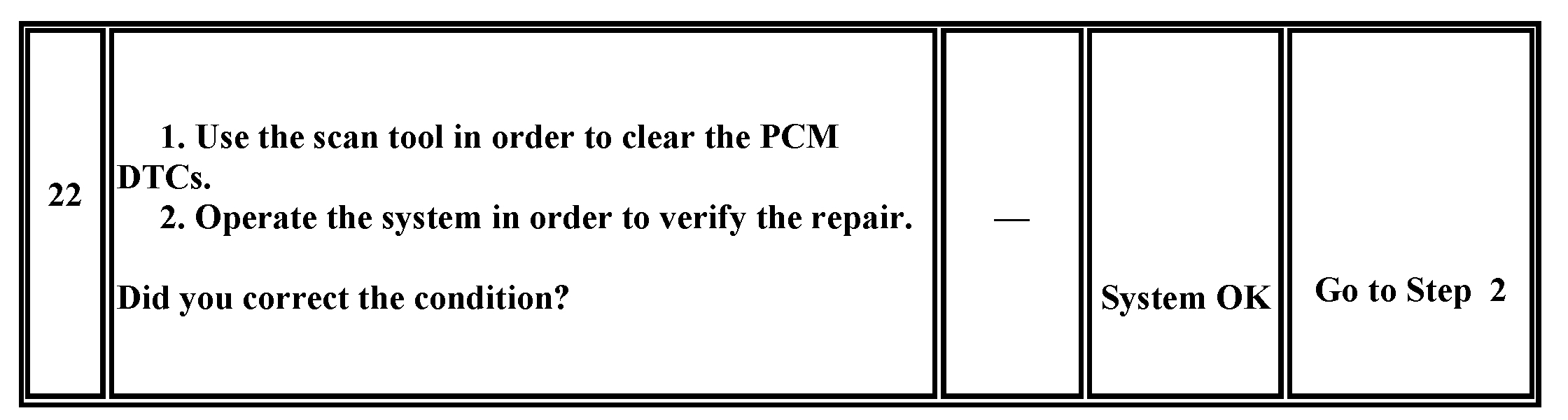

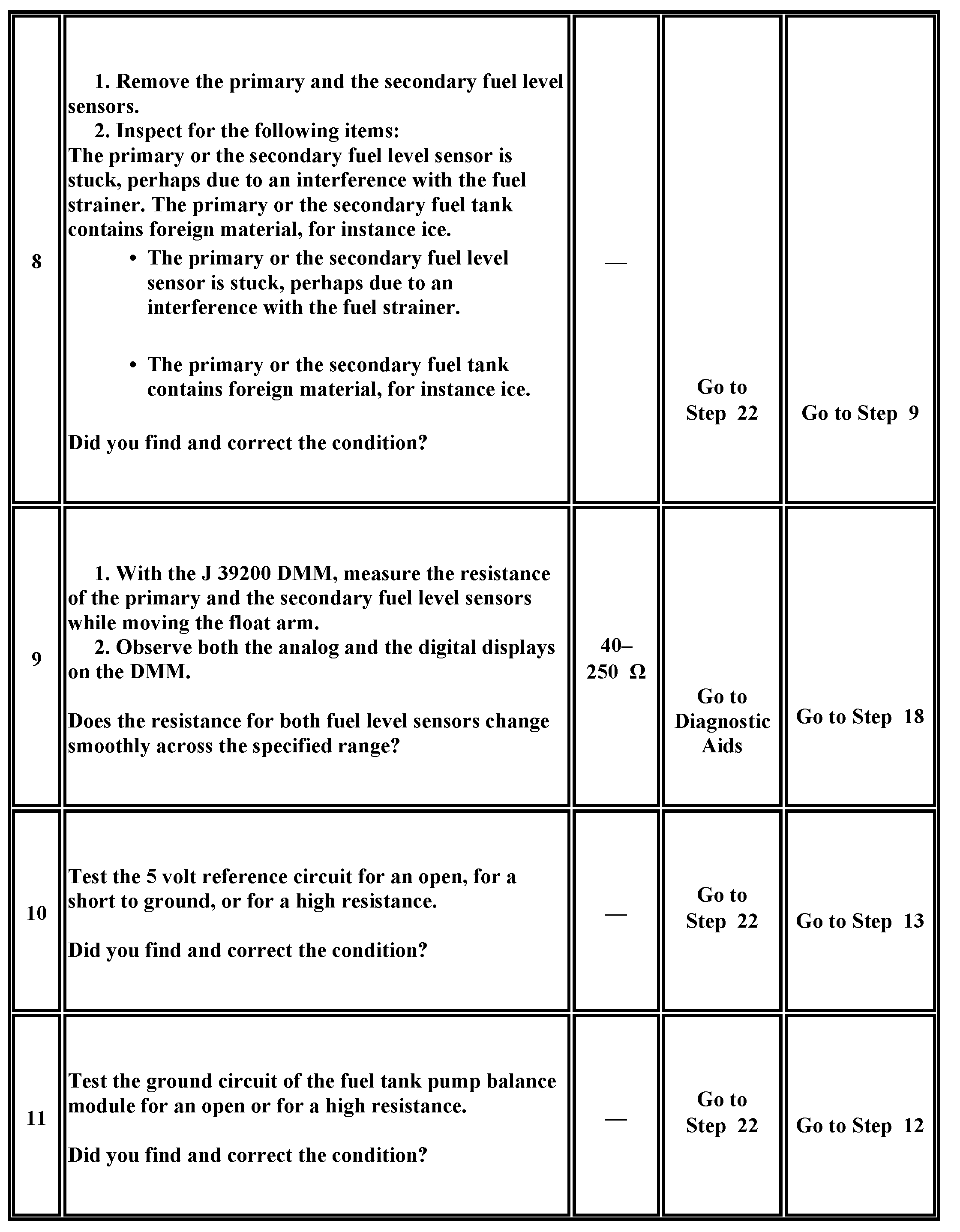

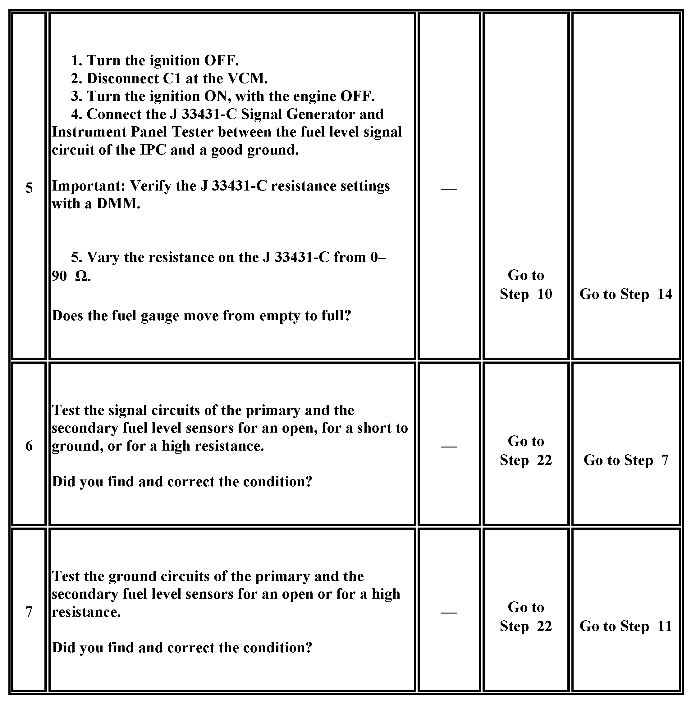

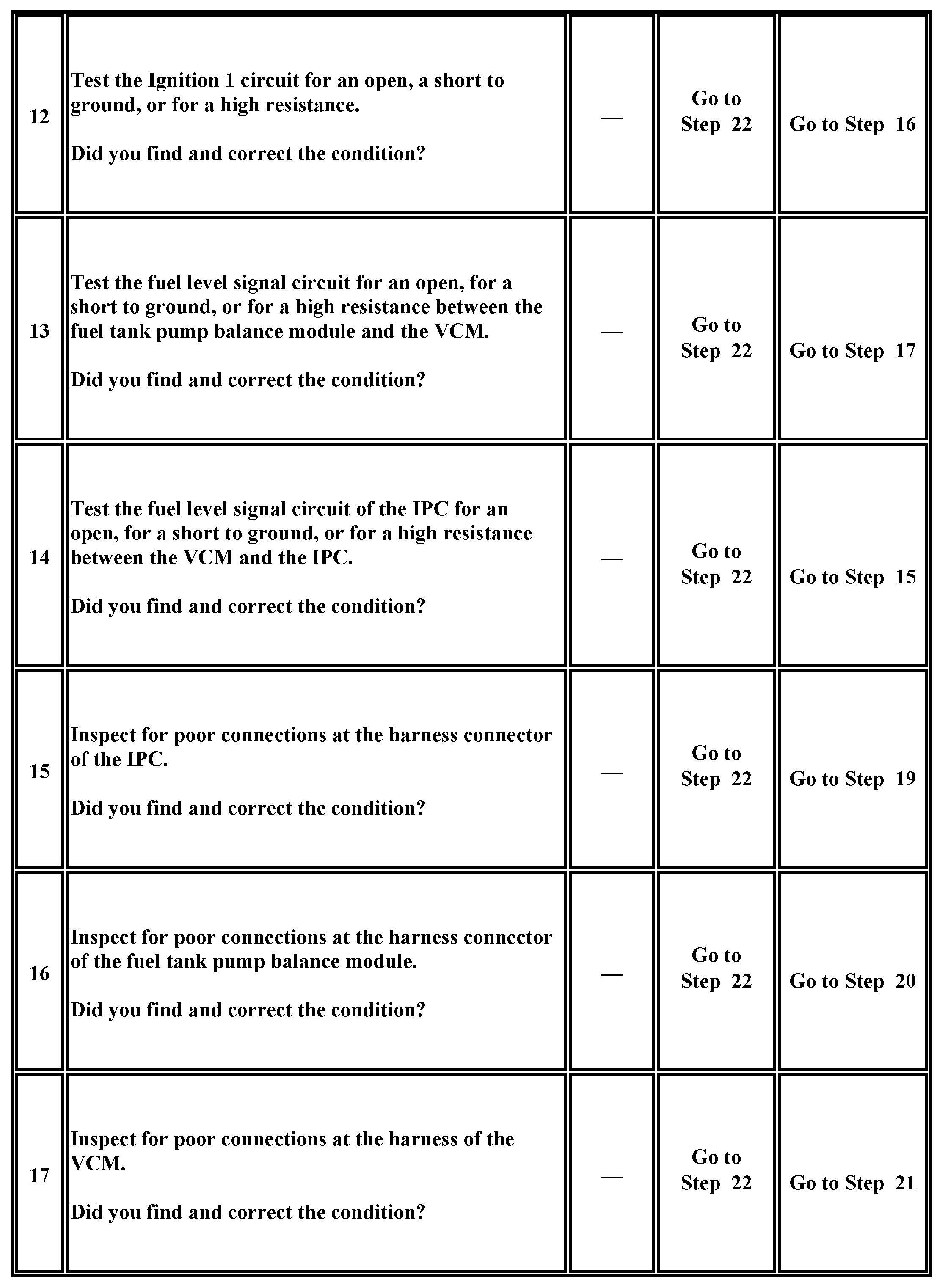

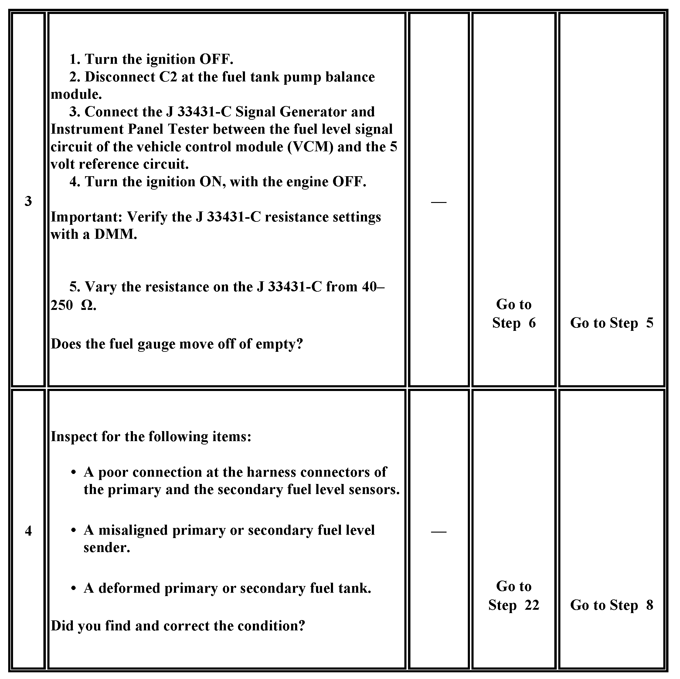

I am attaching the diagnostics for it, but they are quite extensive. The attached pics correlate with the directions.
Pic 1, however, is a pic of the sensor I'm referring to. It is in the tank. I circled the sensor (rheostat).
FUEL GAUGE INACCURATE OR INOPERATIVE
Fuel Gauge Inaccurate or Inoperative
Diagnostic Aids
- Verify that the fuel level is in the same range as the customer concern.
- Use the fuel level sensor resistance in order to verify the fuel level sensor operation. When the fuel tank is empty, the fuel level sensor resistance is approximately 40 ohms. When the fuel tank is full the fuel level sensor resistance is approximately 250 ohms.
Test Description
The number below refers to the step number on the diagnostic table.
22.DTCs will set in the PCM when you perform this diagnostic table.
pic 2
pic 3
pic 4
pic 5
pic 6
pic 7
pic 8
