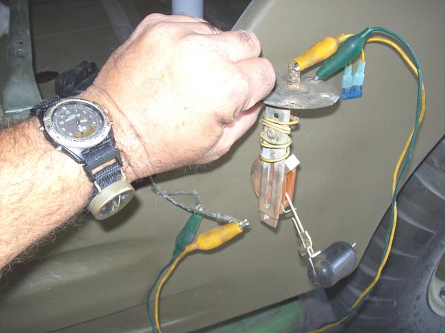

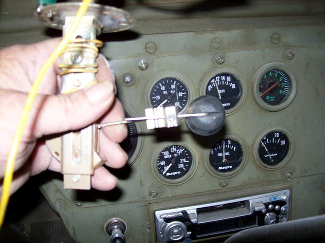

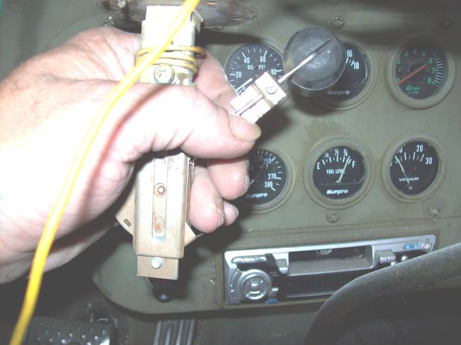

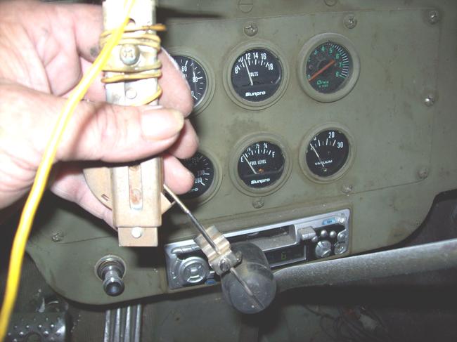

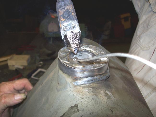

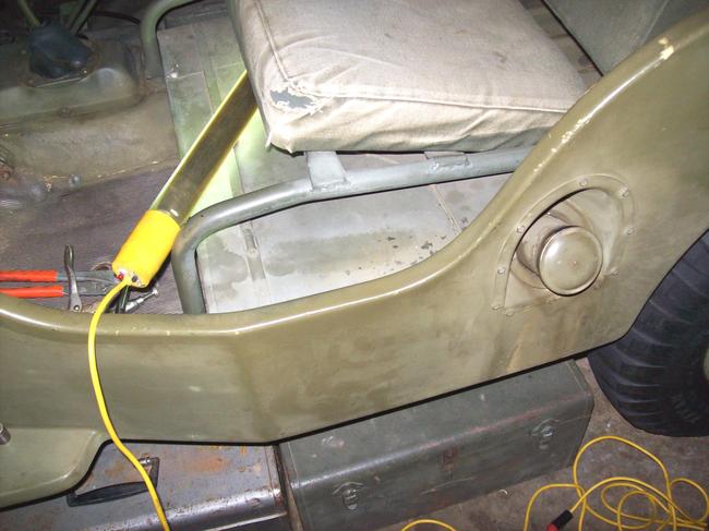

BEFORE YOU GO A-SNATCHIN' STUFF OUT
GROUND THE "EXTRA SENDER".........I GO ALL THE WAY BACK TO THE BATTERY NEG POST WITH LONG JUMPER WIRES TO INSURE A GREAT GROUND IS ACHIEVED........IN THE CASE OF THESE PICS, I WAS NOT HAVING A PROBLEM, I CONNECTED TO MY GROUND WIRE AT THE TANK, NOT THE BATTERY, THESE PICS WERE MADE SO I COULD USE THEM ON 2CAR, AND TO AID IN TEACHING MY OTHER JEEP BUDDIES
TAKE THE SENDER WIRE OFF OF THE "GAUGE" .......THEN "JUMPER" THE "EXTRA SENDING UNIT'S" SENDER (STUD/POST) TO THE GAUGE
THE SENDER IS NOTHING MORE THE GROUND WITH VARIABLE RESISTANCE
"GROUNDING" THE GAUGE'S TEMPORARY JUMPER WIRE WILL MAKE THE GAUGE PEG OUT (JUST LIKE A SKINNED SENDER WIRE AGAINST THE BODY OR FRAME WILL DO
...............INSTEAD OF GROUNDING IT, HOOK THE SENDER "JUMPER" TO THE SENDING UNIT (AS I SAID 2 PARAGRAPHS AGO)
MOVING THE FLOAT SHOULD VARY THE NEEDLE......EMPTY// DOWN.....1/2 WAY UP// 1/2 FULL....ALL THE WAY UP// FULL
THIS MAY HELP YOU IN KNOWING WHAT END OF THE VEHICLE TO TACKLE 1ST

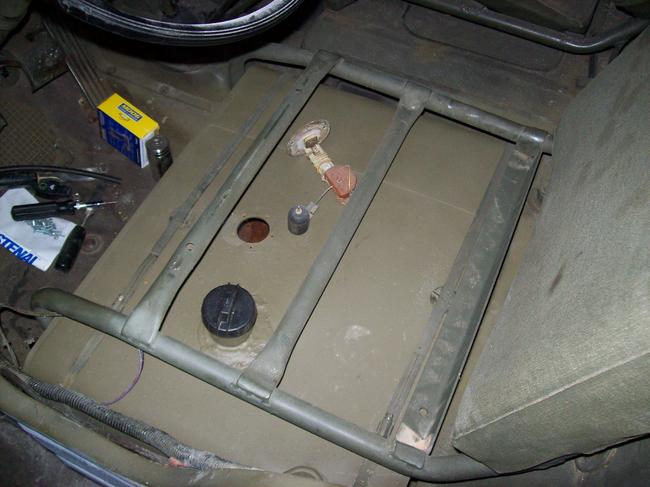

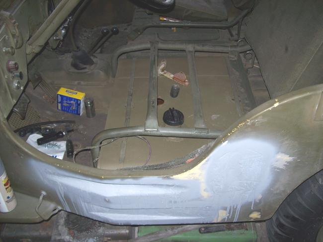

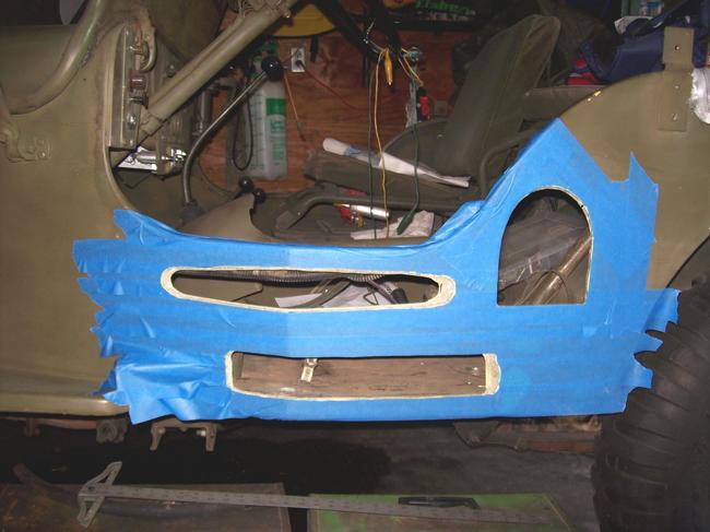

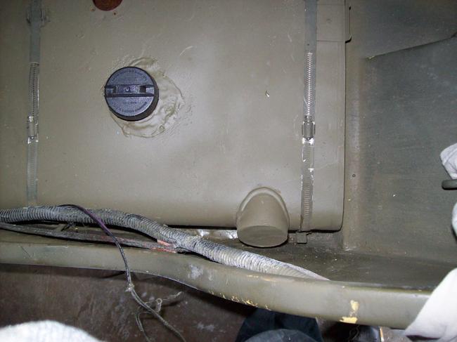

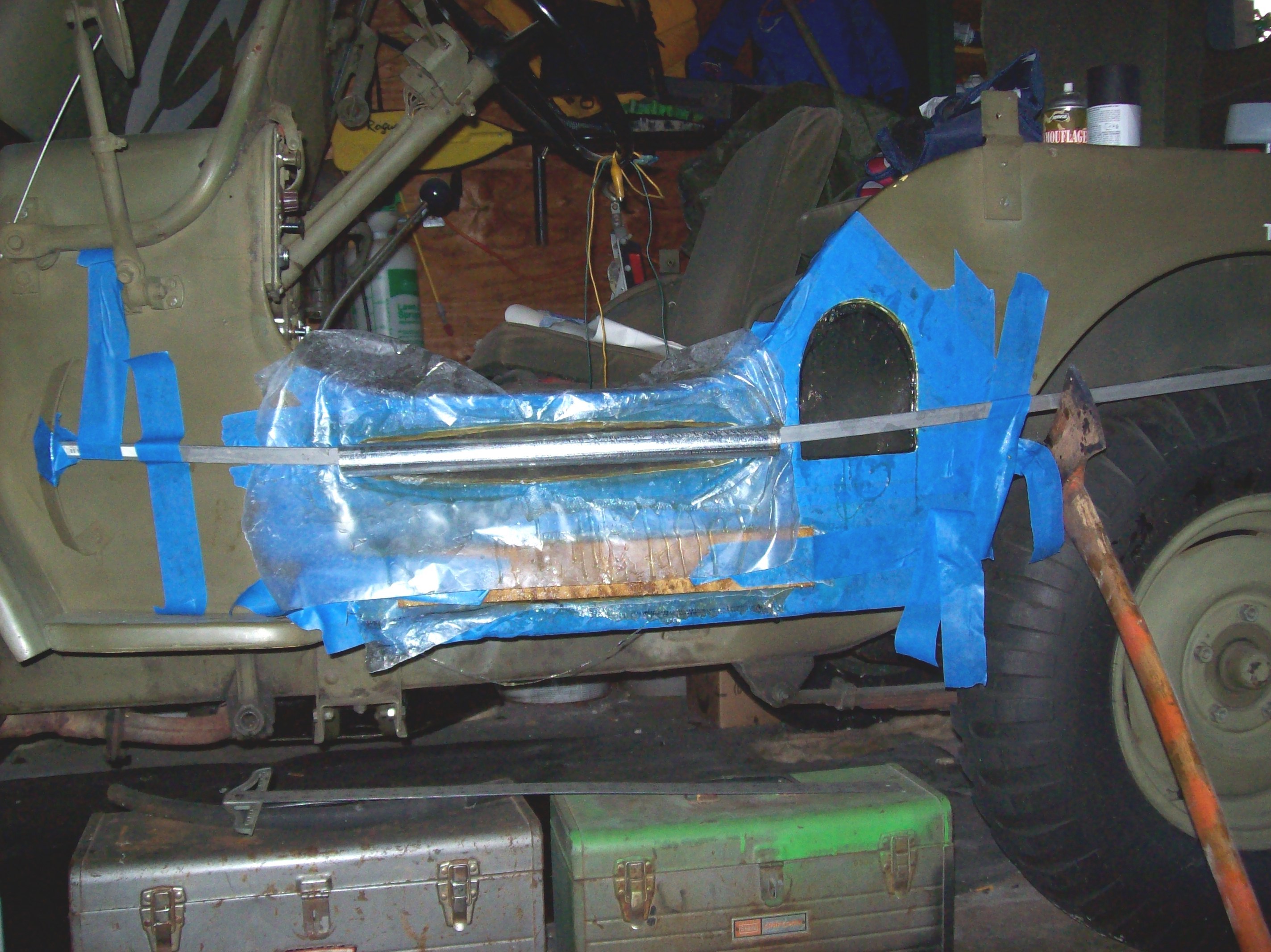

HAVE SOME PICS FROM MY RECENT TANK MODIFICATIONS TO MY '46 WILLYS ("WILLY").....HAD TO RELOCATE THE FILL SPOUT/ DO SOME BODY WORK TO ACCOMMODATE INSTALLATION OF THE SHOVEL AND AX (AS MY BODY CAME WITH NO PROVISIONS)
HE'S HAS BEEN 100% REVAMPED, HAS FIBERGLASS TUB/FENDERS/HOOD HE'S BEEN BACK ON THE ROAD EVER SINCE '93.......I'M STILL TINKERING WITH HIM.....I RAN EVERY SINGLE WIRE (ALONG WITH GROUNDS...FIBERGLASS) AND WENT THRU/ REPLACED EVERYTHING ALL BY MYSELF, JUST OUT OF THE ARMY AND 27 YEARS OLD

2CAR JUST DON'T LIKE LOTS OF PICS AT ONCE
HERE'S THE "HALF FULL".......OR........"HALF EMPTY" PIC THAT DIDN'T MAKE IT
