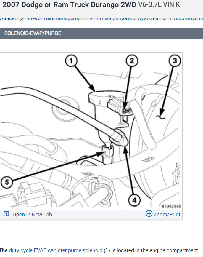

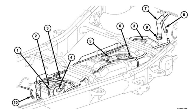

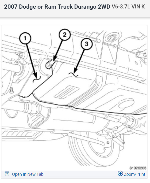

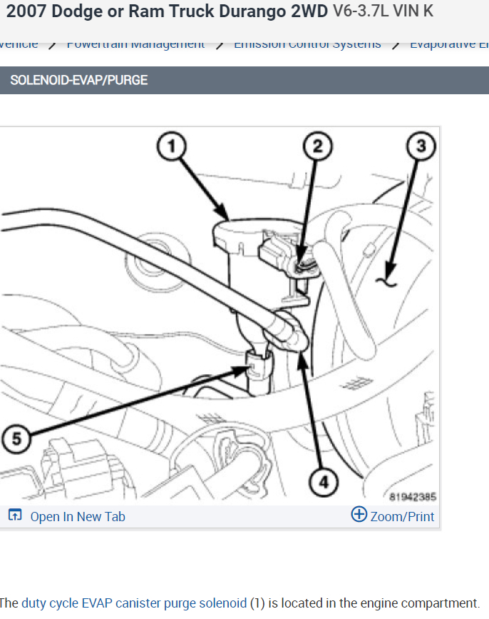

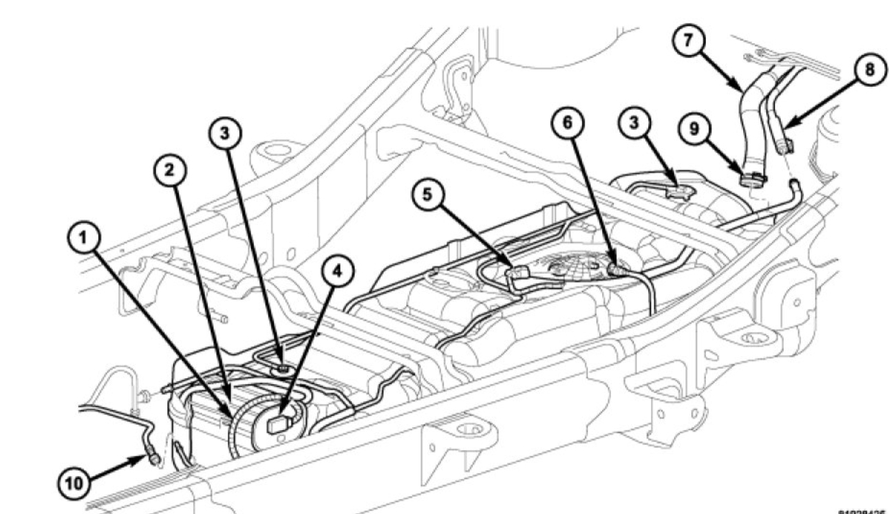

The display says Gas Cap and the Checking engine light is on. I've replaced the gas cap, evap and checked vacuum lines connected to it. I did find a hard plastic line near the tank, which goes to the evap and I reconnected it. Could it be about the tank?
Jul 17, 2024 at 8:01 PM
  • 55,433 POSTS
Yep, there is a leak in the EVAP system. The best way is to use a smoke machine mounted to the tank fill and check to see where the smoke is coming from. I have included the popular leak point in the images below. I would put the car in the air and use a flashlight to see if you can find the broken hose etc.
This guide can help:
https://www.2carpros.com/articles/evap-system-code-repair
