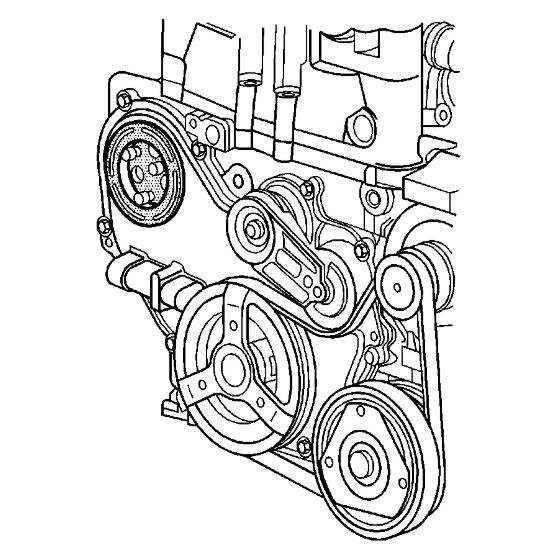

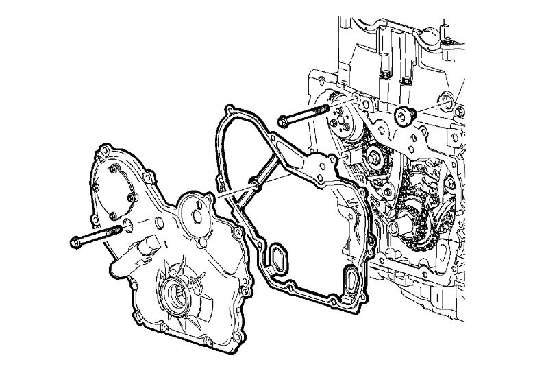

I just want to know if anyone has a diagram that you guys could share with me because it is so compact under the hood and it's hard to see down the left side of the motor to see which one the water pump actually is. I see a little bit of water running now do there so I know it's leaking, but I may have to take the passenger side tire off to even have a chance to access it. I just need a little help please.

Good morning,
Below is the procedure and there are some pictures.

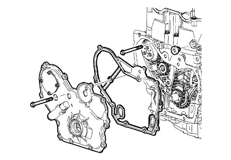

This is an involved job. Not very easy as the timing cover has to be removed.
Tools Required
J 43651 Water Pump Holding Tool
Removal Procedure

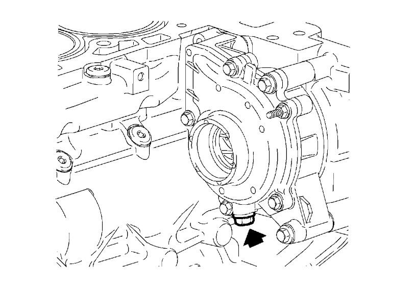

1. Remove the thermostat housing.

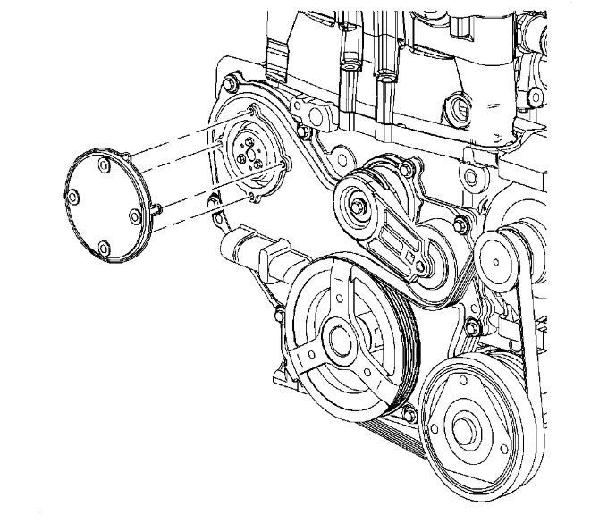

2. Remove the water pump access plate from the front cover.
3. Remove the right hand fender liner.
Important: A drain plug has been provided at the bottom of the water pump assembly for additional coolant drainage from the engine block and water pump.
4. Drain the coolant from the water pump using the plug at the bottom of the pump.
Important: The water pump holding tool supports the sprocket and chain during water pump service. The tool must be used or the balance shaft must be re-timed.
5. Install the J 43651 into position.
6. Tighten the bolts on the water pump holding tool into the threads on the water pump sprocket.
7. Install the access cover bolts that were removed earlier to secure the water pump holding tool to the front cover assembly.

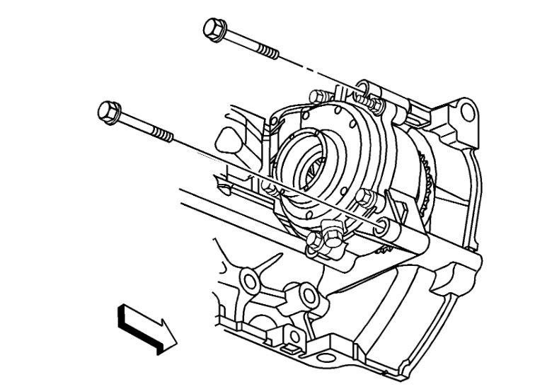

8. Remove the 3 inner water pump sprocket to water pump blots.
Important: Be sure to remove both water pump bolts from the front of the engine block.
9. Remove the 2 water pump bolts.
10. Remove the rear 2 water pump bolts.

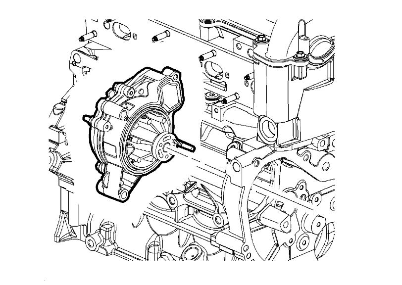

11. Remove the water pump.
12. Remove and discard the water pump O-ring seal.
Installation Procedure
Important: Prior to installing the water pump, read the entire procedure. This will help avoid balance shaft chain re-timing and ensure proper sealing.
1. Install a NEW water pump O-ring seal.
Important: A guide pin can be created to aid in water pump alignment. Use a M6 m x 6 mm stud. Thread the pin into the water pump sprocket.
2. Using the guide pin, align the pin with the water pump holding tool.
3. Position the water pump against the engine block and hand tighten the water pump bolts.
Sep 12, 2019 at 3:36 AM
