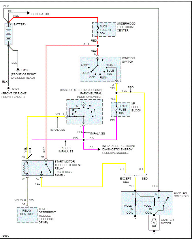

My car's fusible link burnt out and my car has power running through it but won’t turn over at all. so I bought a fusible link and when I lifted up my car to cut the link I noticed it was two links diverted into one and I don’t know which I need to cut in order to replace so my car is running again. Please get back to me thanks.
Aug 20, 2020 at 2:52 PM
  • 110,248 POSTS
For some strange reason, I'm not finding info on a 1997 Impala in either of my manuals. Ugh. The only thing I can find is a 1996 SS with the 5.7. Is that the engine size you have?
As far as the problem, does the starter engage at all? If it doesn't, that isn't a fusible link issue. There are two wires to the starter, a larger one from the battery (not fusible) and a smaller one to the S terminal (not fusible).
Let me know if the starter is working. If it isn't, take a look through this link. It explains how to test the starter.
If it does engage and it won't start, see if this link helps.
Let me know exactly what is happening.
I attached a pic of the wiring schematic from a 1996 SS. It should be similar.

Yes, my engine is a 5.7 and I tested the larger wire from the starter which the light turned on when cranking the ignition. so what does that indicate on the problem at hand?
Aug 27, 2020 at 10:29 AM
  • 110,248 POSTS
The larger wire at the starter should have 12v at all times. The smaller wire (should be purple) should only have 12v when the key is in the start position. So, if the large wire has constant power and the smaller wire has 12v with the key in start, replace the starter.
Let me know if that is what you found. I'm asking because you indicated you found 12v at the larger wire. You didn't mention the smaller one.

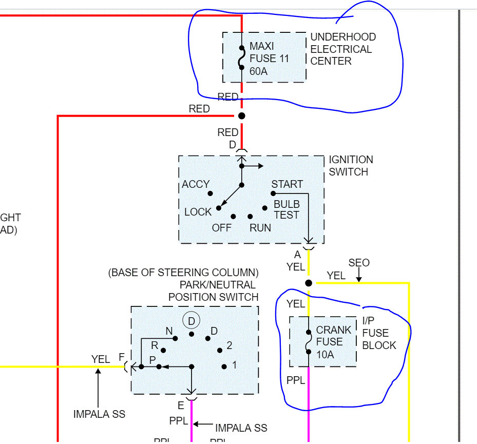

The smaller wire has no power running through it at all when turning the key.
Aug 29, 2020 at 2:40 PM
  • 110,248 POSTS
Okay, then we need to check a couple fuses. (also, make sure it won't start in neutral).
I attached two pics below. Please keep in mind, these pics are for an 2006 SS, so even though they should be similar, they may not be exact.
The first pic shows the schematic and the two fuses I need tested. The second pic shows the fuse box under the hood. I don't have a pic of the interior fuse box crank fuse. Check to see if there is a label on the fuse box cover indicating fuses.

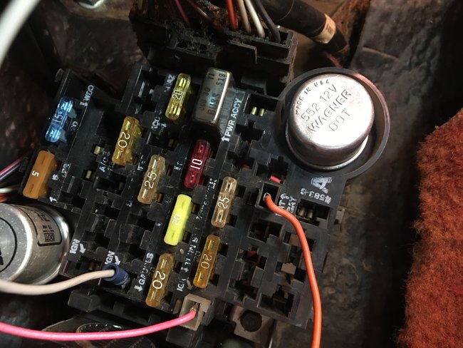

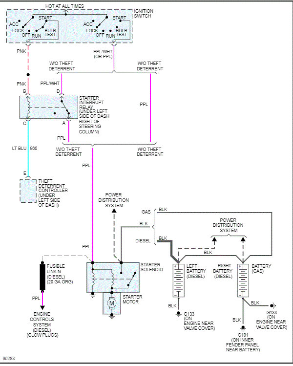

First, have you checked all fuses? Are you able to locate a starter relay?
As far as pictures, I need to see the fusible link that you are dealing with. You mentioned it went two different directions. I would like to see where it is going.
Please bear with me. This won't be quite as easy without a wiring schematic. I'm surprised there is nothing listed for me. I jumped ahead a few years and didn't find anything until I made it to 1985. I attached that starter system schematic. See if it resembles what you have.
Sep 2, 2020 at 1:35 PM
MARCUSMADRIGALES13
  • 9 POSTS
There’s a picture of my fuses and a video of my fusible link. let me know if you need a better video of my fusible link.
