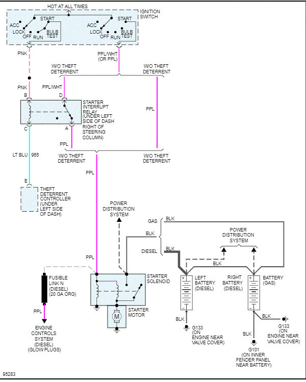

I attached a pic of the wiring schematic from a 1996 SS. It should be similar.

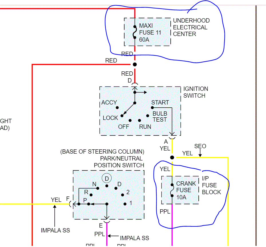

  • 110,194 POSTS

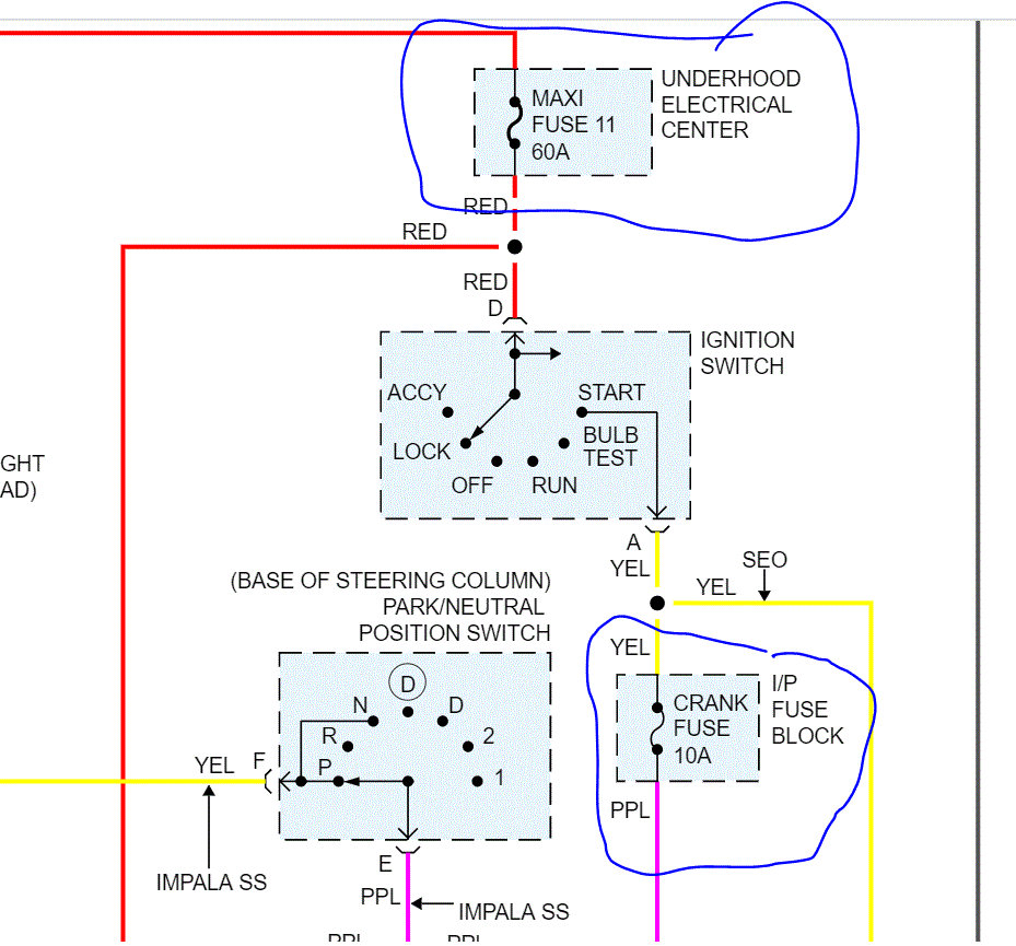

Okay, then we need to check a couple fuses. (also, make sure it won't start in neutral).

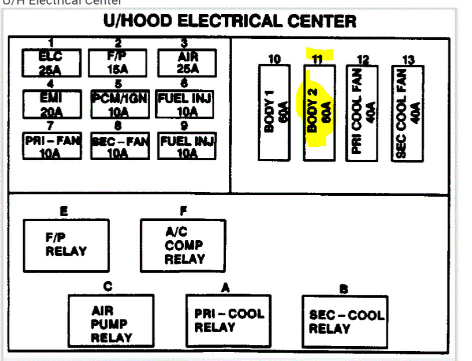

I attached two pics below. Please keep in mind, these pics are for an 2006 SS, so even though they should be similar, they may not be exact.
The first pic shows the schematic and the two fuses I need tested. The second pic shows the fuse box under the hood. I don't have a pic of the interior fuse box crank fuse. Check to see if there is a label on the fuse box cover indicating fuses.
Let me know what you find.

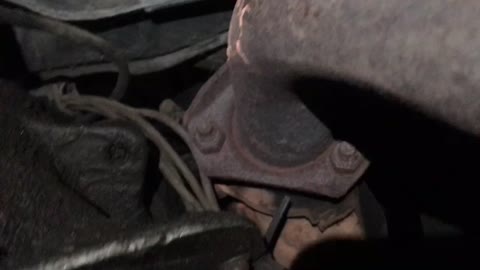

  • 110,194 POSTS

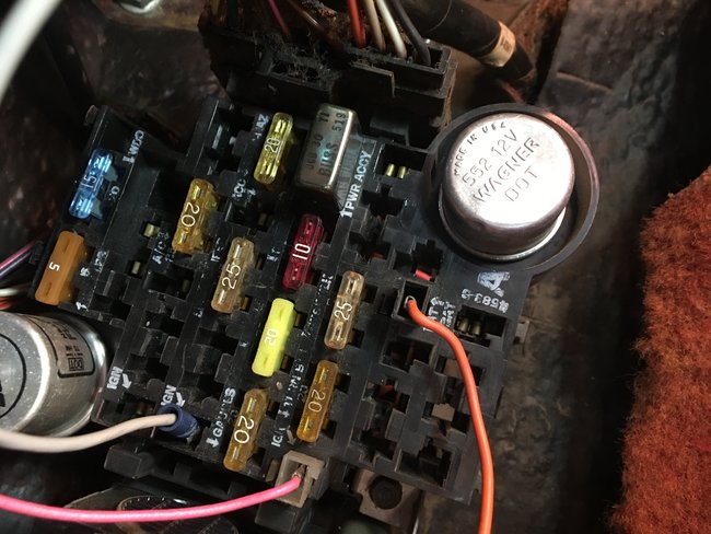

First, have you checked all fuses? Are you able to locate a starter relay?
As far as pictures, I need to see the fusible link that you are dealing with. You mentioned it went two different directions. I would like to see where it is going.

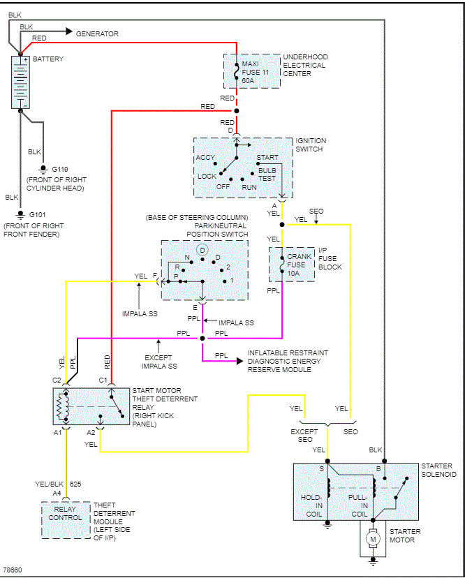

Please bear with me. This won't be quite as easy without a wiring schematic. I'm surprised there is nothing listed for me. I jumped ahead a few years and didn't find anything until I made it to 1985. I attached that starter system schematic. See if it resembles what you have.

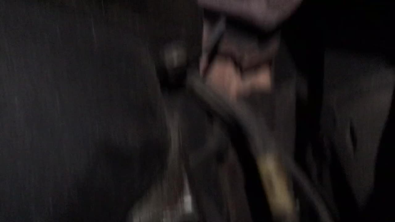

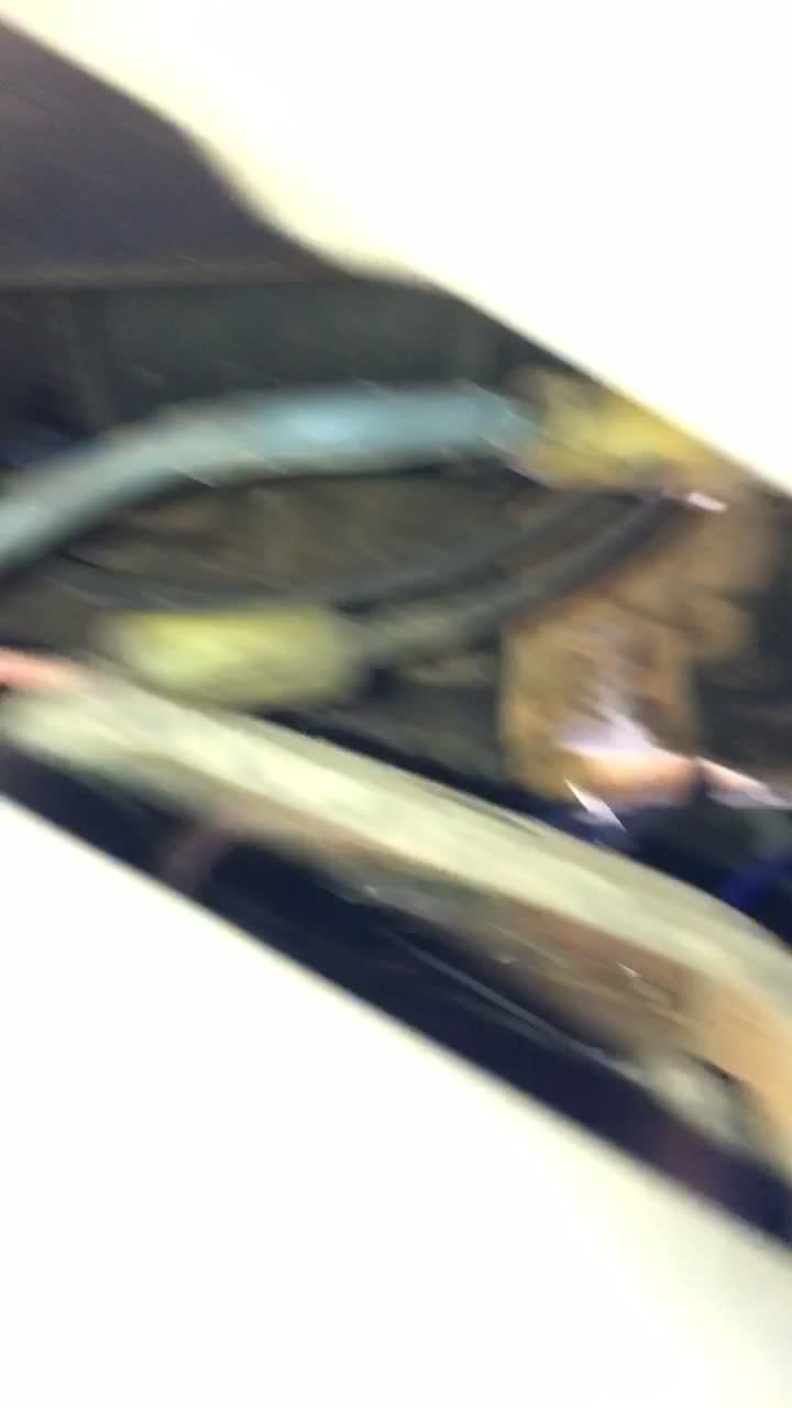

Sep 2, 2020 at 8:35 PM
MARCUSMADRIGALES13
  • 9 POSTS

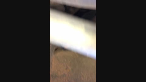

There’s a picture of my fuses and a video of my fusible link. let me know if you need a better video of my fusible link.
Sep 3, 2020 at 12:01 PM
  • 110,194 POSTS
I see one side of the fusible link going toward the starter. Where does the other side go?
Sep 3, 2020 at 5:13 PM
MARCUSMADRIGALES13
  • 9 POSTS
I can’t really see where else it goes to because it joins with a bunch of other wires into a tube thing to cover the wires.
Sep 3, 2020 at 8:57 PM

This is going to be a tough one without knowing and not having a wiring schematic to review. If you go to the alternator and move the larger wire, do the wires in the harness move as well?
