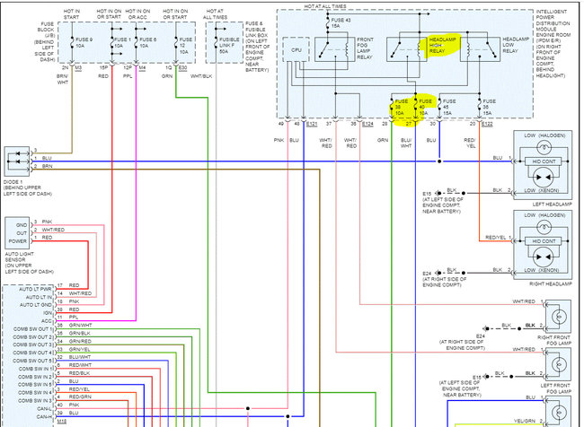

I believe that according to the diagram printed on the box cover fuses that powers the high/low beam and the fuse that powers the IGN cccs cont has popped also. As soon as I replace those fuses it pops again.

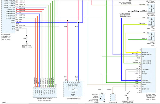

I need to know if the vehicle has daytime running lamps. The schematics are very different.
Also, I attached a schematic below for the DRL circuit. I highlighted two fuses. Is it one of these that is failing or both?
Also, recheck the other fuse you mentioned. Is it an eccs fuse and not cccs?
Let me know

KEALII808HAYN
Yes, it is the eccs.

Do you have DRLs also or not?
