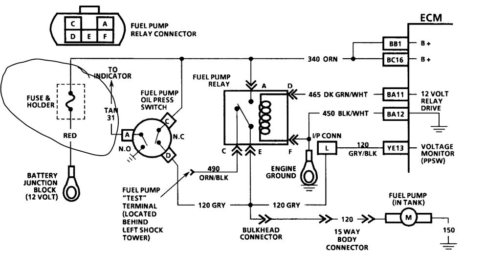

Where is the fuse for a fuel pump on the car listed above?
Aug 24, 2019 at 4:02 PM
Good evening,
The power for the fuel pump comes from an inline fuse from the battery to the ECM.
If your check engine light comes on with the key, then that fuse is good as it feeds the ECM as well.
I attached a wiring diagram for you to view. You will need to test for power at the fuel pump.
