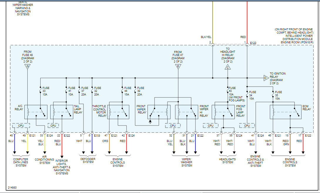

CHICKFIX86
I do not have the manual, nor do I have the cover. I know some fuses burnt out and some are just missing. I don't know which ones I need to put in what spot. If anyone has an image of the fuse and labels you would be an angel! Thank in advance.

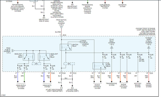

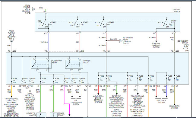

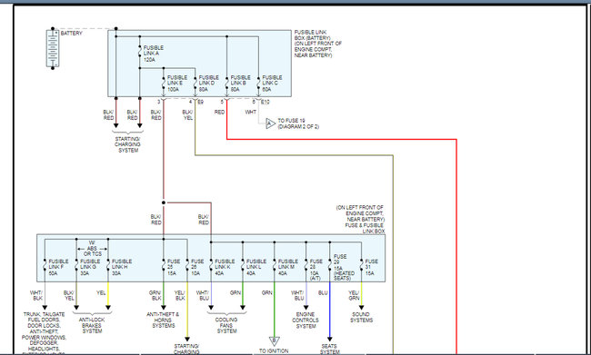

I am having a hard time finding an actual diagram of the fuse panels for your vehicle in our reference materials. The best I can do for you is the Power Distribution Wiring Diagrams, which I have included for you in the diagrams down below. I will continue to look for the actual fuse panel diagrams and will post those for you when I find them, but please go through for now.
Thanks,
Alex
