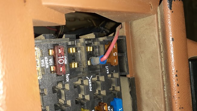

1.what amperage is the two battery fuses in the box under the steering column? it has a single wire running from the lower one. when tracing it, it runs to a cylinder under the dash.
2. my running, reverse and dash lights don't come on, everything else works as it should. any ideas?

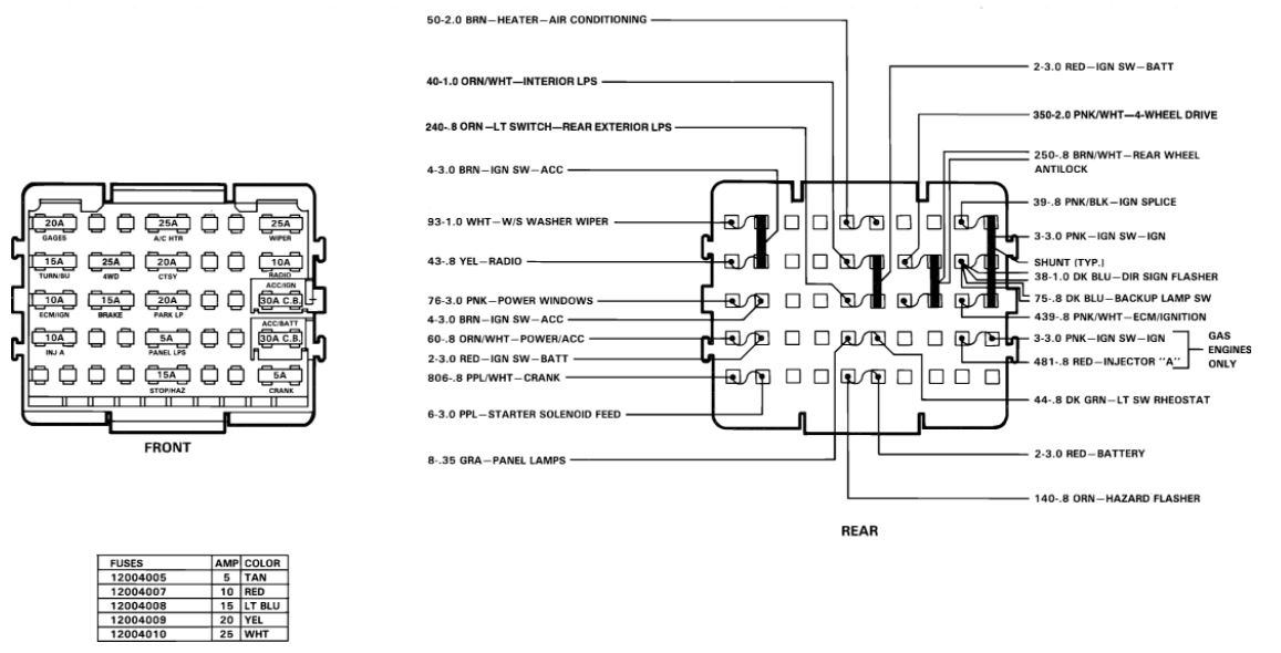

I attached the fuse block diagram for your truck, give it a review and you should be able to ID the two in question. Go though the diagram and make sure there's not any fuses missing that may be the ones for your dash,running and reverse lights then we can go from there. On your kind of truck in those years I have seen the dimmer switch be dirty on the inside and just moving it a bunch of times the dash lights may start to function again. As for the running and reverse those will be on a different circuit and could be a few things. The switches or poor grounds which is common. The reverse light switch will be on the side of the transmission at the linkage for the gear shifter. Go through and do a visual inspection for broken or corroded wires there at the switch to start with. On this cylinder you speak of can you upload a picture of it? Off hand I would say its the flasher for the blinkers or hazard lights.

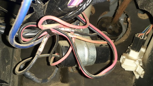

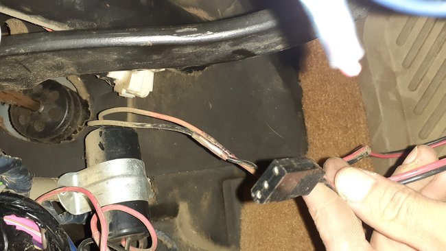

this is what i'm looking at. the red wire plugged into the battery circuit is running to the black can? id don't know what the black can is. looking at the Haynes typical for this year and can't find it. it looks like it was put there aftermarket. each side has two wires. one side is one black and one red. other side is one orange and one black. switch wires look good on transmission. the orange and black side of black cylinder turns into another black and red which ends i'm n a three hole male plug. i'm lost as to what it is. maybe something with towing? i forgot to mention. there are three towing options installed in the truck, travel trailer, fifth wheel and regular pull behind trailer.

i have already disconnected the trailer brake control. it had no power and was in the way to where we are so far.

Yes, that looks like some sort of trailer braking assistance part. Can you take it down and see is there are any numbers on it or a name?
