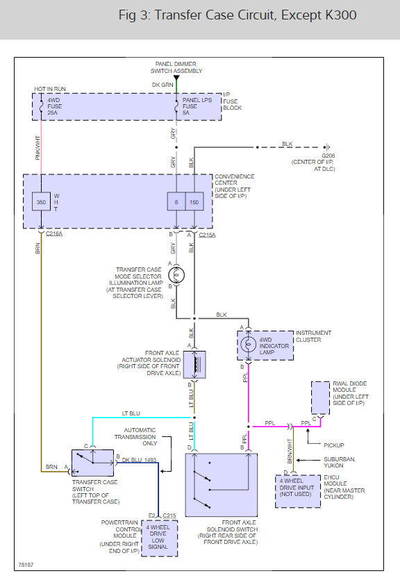

When I attempt to engage 4x4 the fuse blows and wont allow it to lock it. What would cause that and how can I fix it?

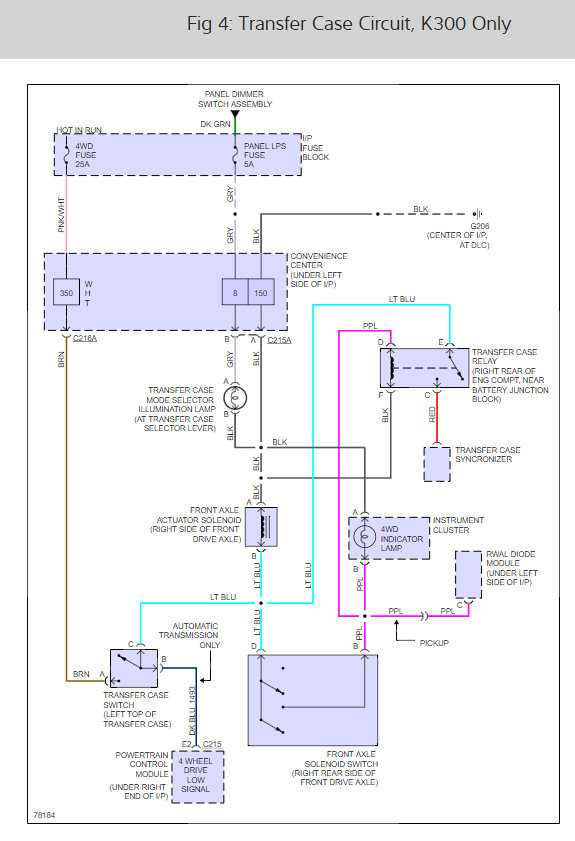

There is a transfer case switch located on the top left of the unit I would start there. Here is the wiring diagrams for the transfer case.
If the front differential actuator shorts out on these trucks. Try unplugging the 2 wire plug that goes to the front diff actuator and see if the fuse still blows, if it does not then you know the actuator is no good.

The actuator is located on the front axle right?

Yes its located on the front axle. It has 2 wires coming out of it. The actuator screws into the front diff, it has a huge 1 1/16 spot for a wrench or you can unscrew it with a big pair of channel locks.

It was the switch once I replaced it the fuse stop blowing thanks for your help I love this site.
