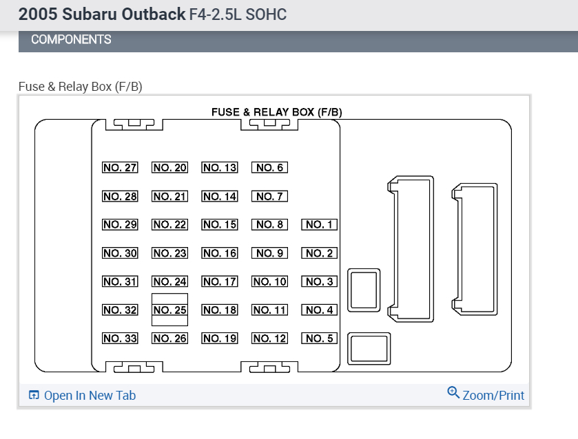

The radio, dash clock and front dome lights are not working. I’ve checked all the fuses, but they’re all good. What could be causing this?
Oct 18, 2019 at 8:26 AM
  • 54,840 POSTS

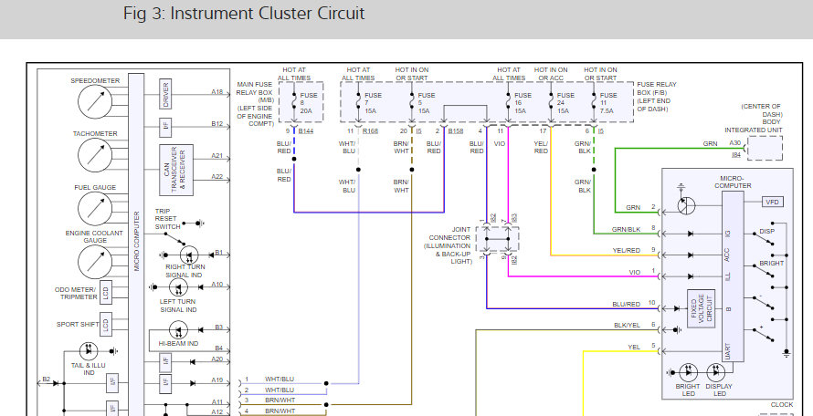

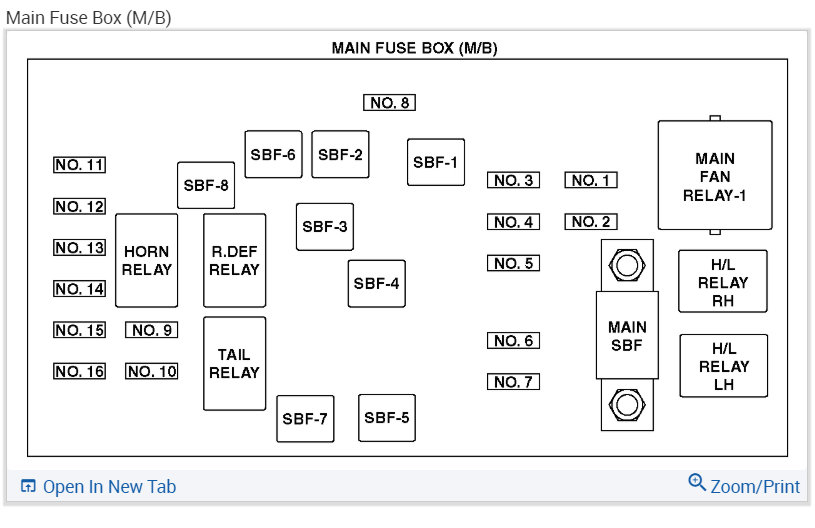

Can you check for power at the clock fuses? there are 4 fuses that run it please turn the key on and follow this guide:
See if all have power here is the clock wiring diagrams so you can see which fuses to check. Check out the diagrams (below). Please let us know what you find. We are interested to see what it is.
