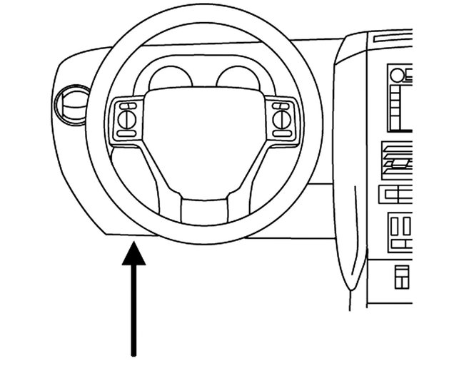

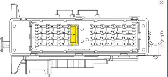

I need a designation for the fuses. I see the fuse box under the hood, i just need something that tells where they go to. Is not there also a inside fuse box? For some reason the rear window in the center is down and it wont power up. Fuse? Relay? both?

There is a fuse box located under the driver side trim. (See picture) I have highlighted the rear window switch in yellow (CB1) and the rear fuse (F5) in blue. I would remove them and test both of them for continuity before moving on to accessing the rear motor.

Thanks, fuses were okay. i disconnected the battery. checked fuses put them back in, connected the battery and everything was fine. I just don't know why the window was down. It was raining, maybe something got wet and the truck thought it was under water and the window opened automatically.
