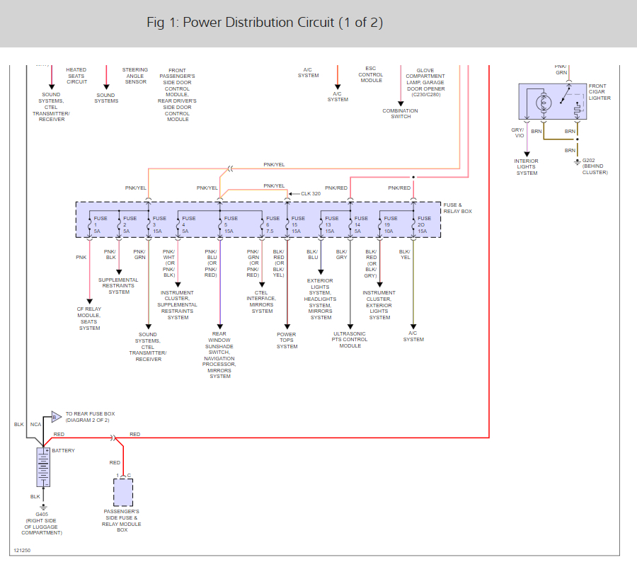

The gas meter, speedometer and back brake lights all went out. Checked the fuses but they are all good. Trying to find the next step.

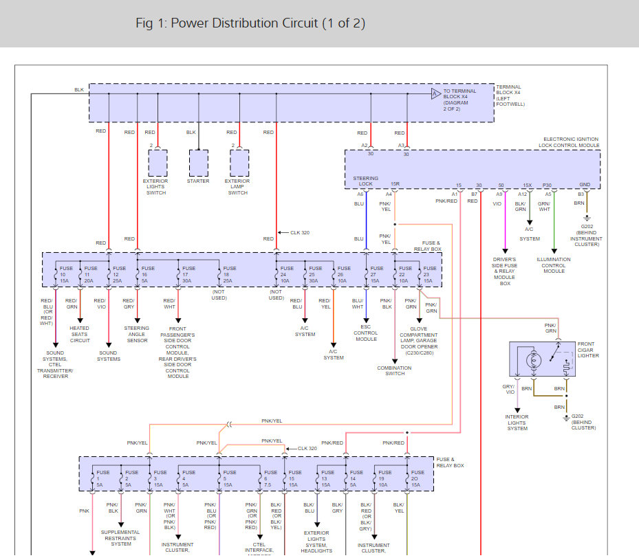

This sounds like you lost one leg of the ignitions witch module but to confirm the issue here is a guide to help you test to see if you are losing power along with the wiring diagrams to help you see how it works:
