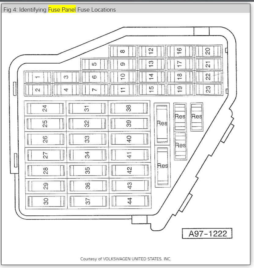

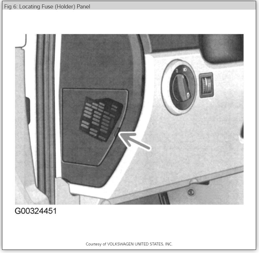

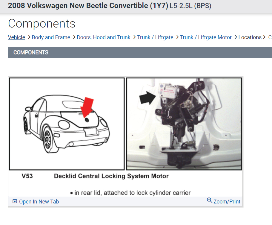

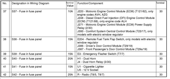

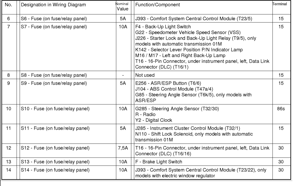

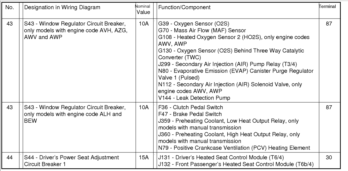

I am unable to open my trunk on my convertible beetle. I have read to check the fuses 14 and 144. Do I need a tool to properly check them? Also if I do need to replace the motor in the trunk does it need to be from VW or will an aftermarket be okay?
May 25, 2021 at 2:00 AM
  • 55,224 POSTS

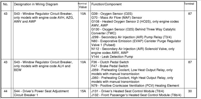

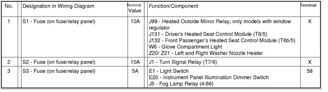

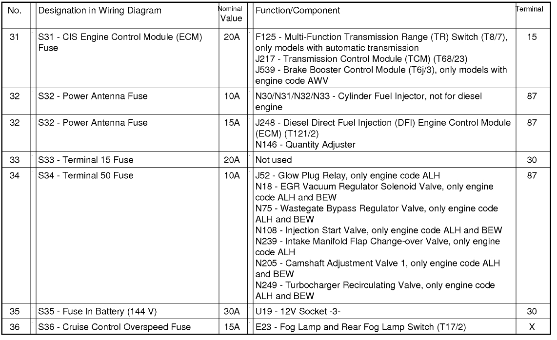

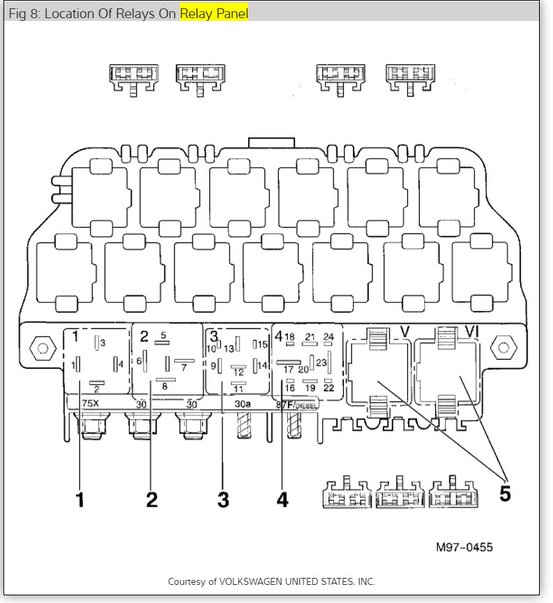

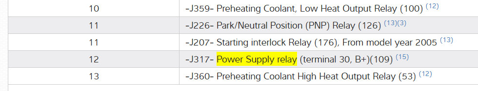

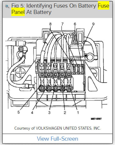

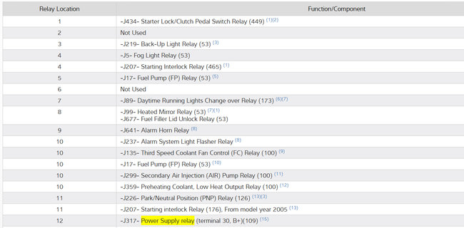

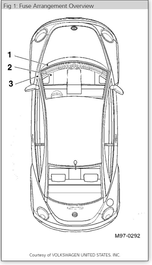

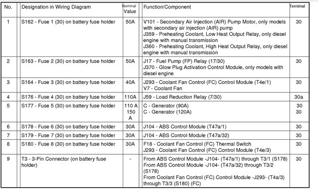

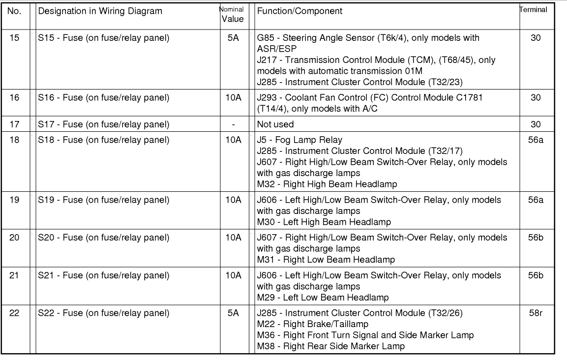

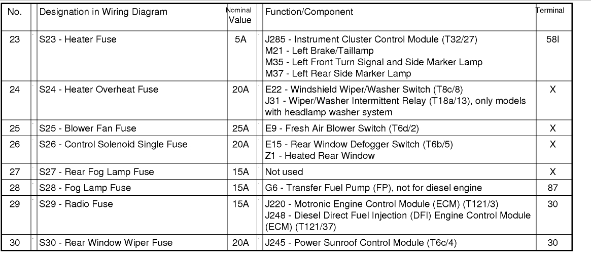

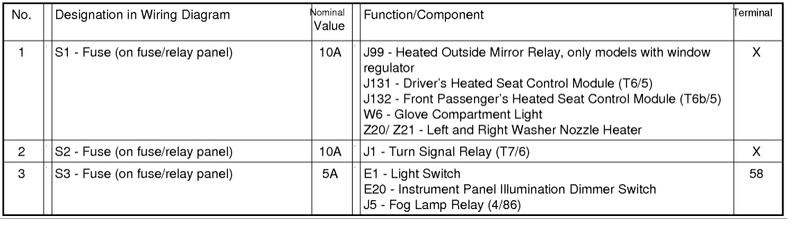

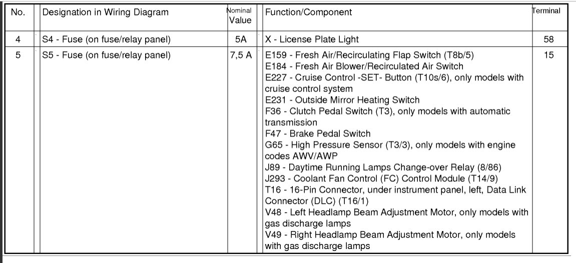

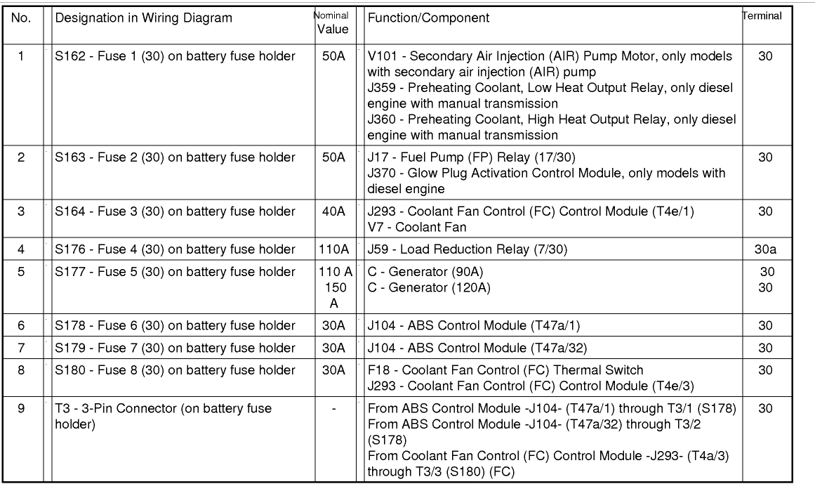

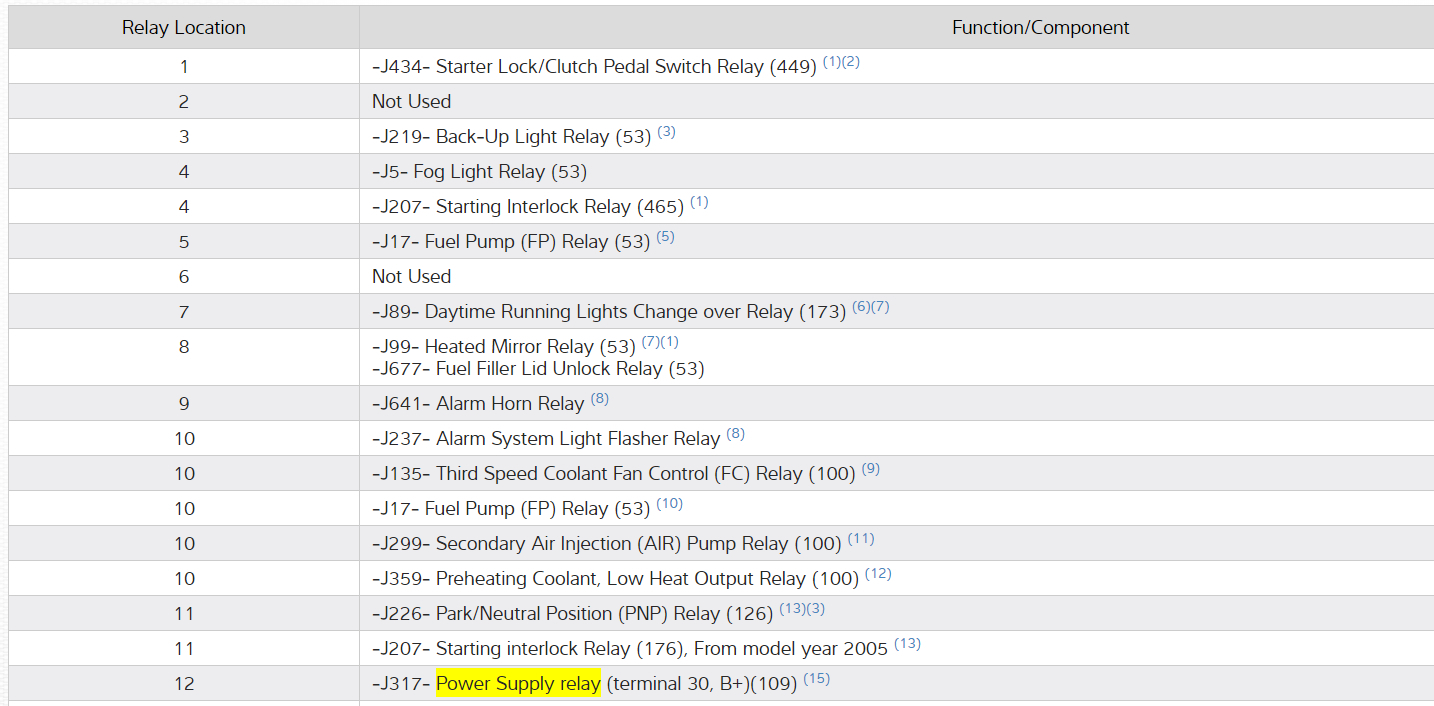

Let's check the fuses first. here is a guide to show you how to check for power with the fuse locations in the diagrams below:
I have also included the trunk latch assembly so you can see how to change it out. I would use OEM parts they seem to work better. Check out the diagrams (below). Let us know what happens and please upload pictures or videos of the problem.
May 26, 2021 at 3:30 AM
