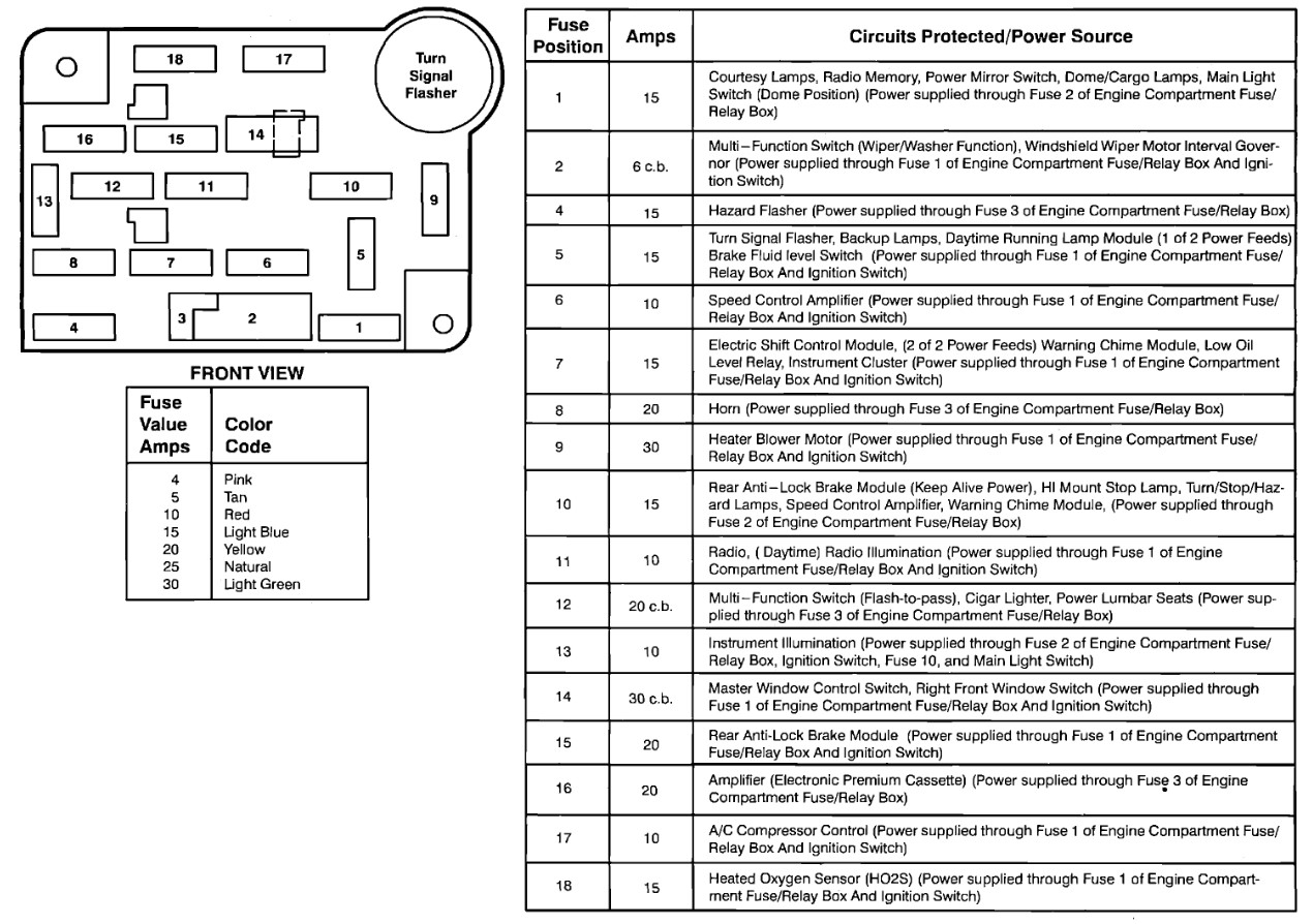

I need a fuse diagram for under dash fuse panel.

This should be the fuse layout. What is the issue you are having?
Image (Click to enlarge)
