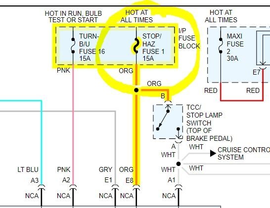

Do I have s 30amp fuse for my stopping and brake lights in the fuse panel under the hood of my SUV?

No, that circuit only uses a 15 amp fuse. Do not install a larger fuse.

It that the fuse panel under the dashboard or in the engine bay?
Jun 26, 2019 at 8:50 AM
Experienced Mechanic
52,796 POSTS
It is under the dash inside the car.
Jun 26, 2019 at 9:01 AM
JARROD379
MEMBER
4 POSTS

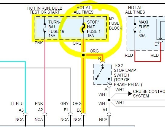

Ya, I just replaced it with a new one that the same as the one I took out. I’m still not getting any brake lights.
Jun 26, 2019 at 9:04 AM
52,796 POSTS

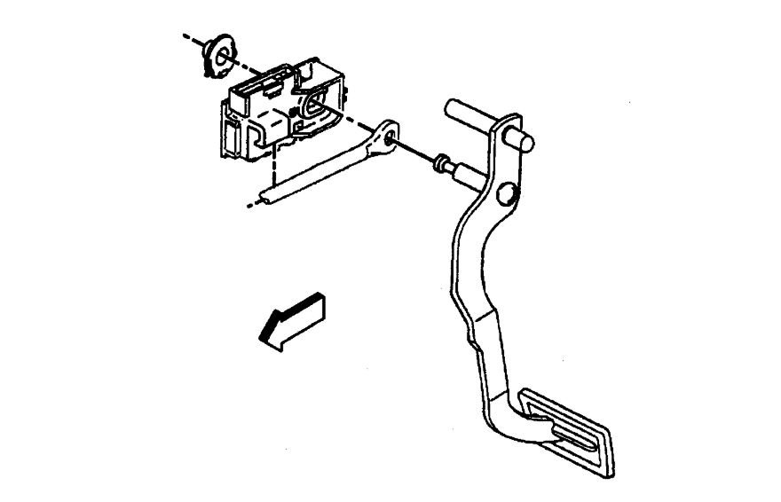

Okay, Did you test for power at the fuse with a test light or voltmeter?
You need to start there and then go to the switch on the pedal.
