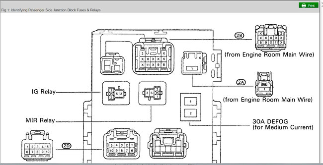

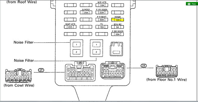

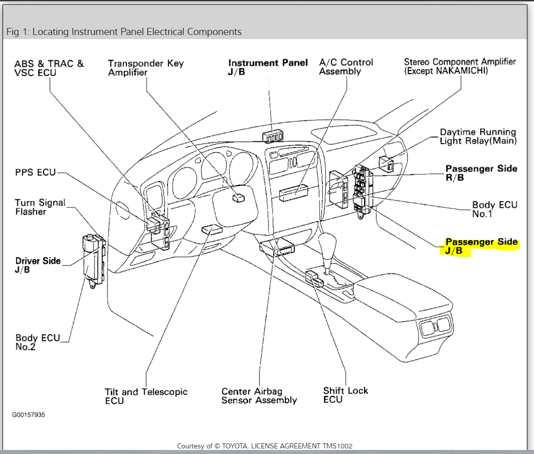

Where is the fuse for interior lights?
Mar 2, 2019 at 1:08 PM
SCGRANTURISMO
  • 4,897 POSTS
I have included the information that you requested in the diagrams down below. Please feel free to ask any other questions that you may have.
