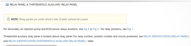

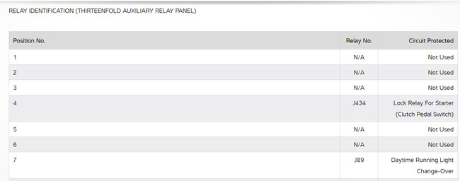

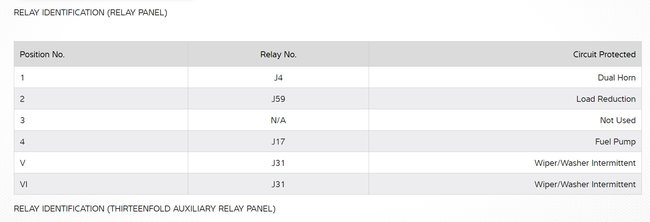

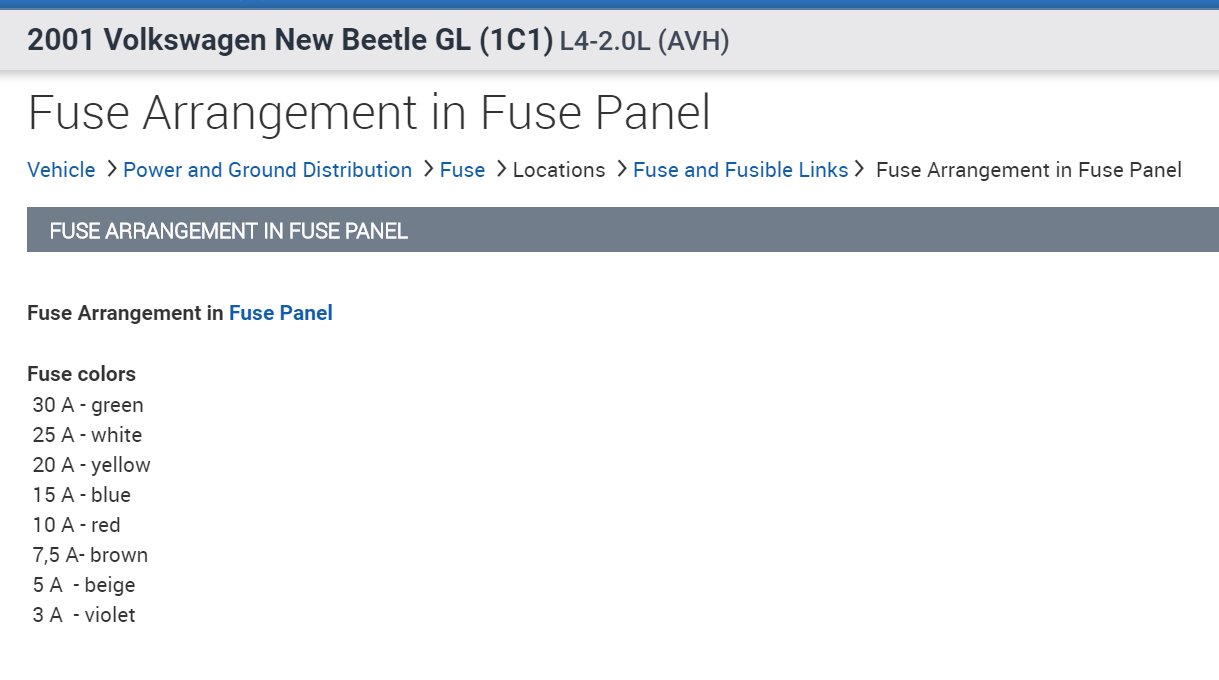

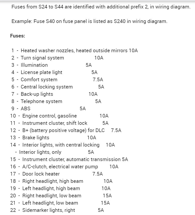

Where is the fuse for power windows, sunroof, and interior lights? All went down at once.
Mar 16, 2019 at 6:39 AM
SCGRANTURISMO
  • 4,897 POSTS

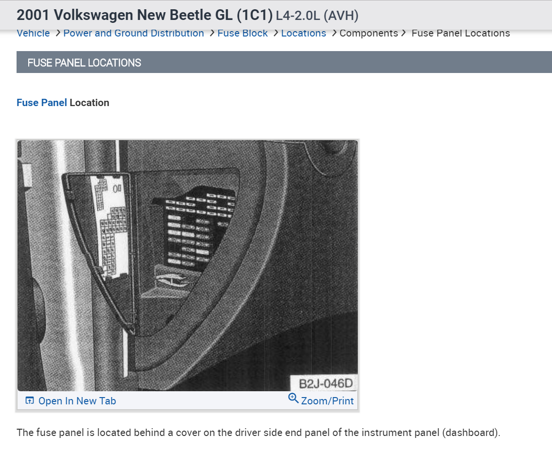

I have included the information that you requested in the diagrams down below. Please let us know if there is anything else that we can do for you.

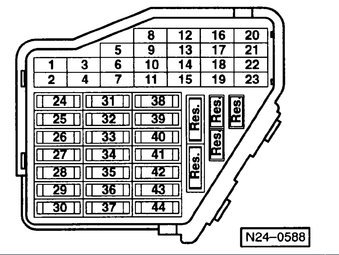

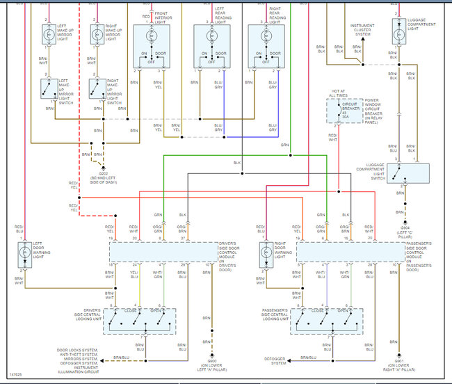

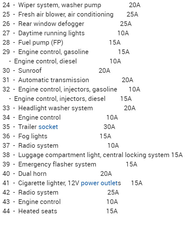

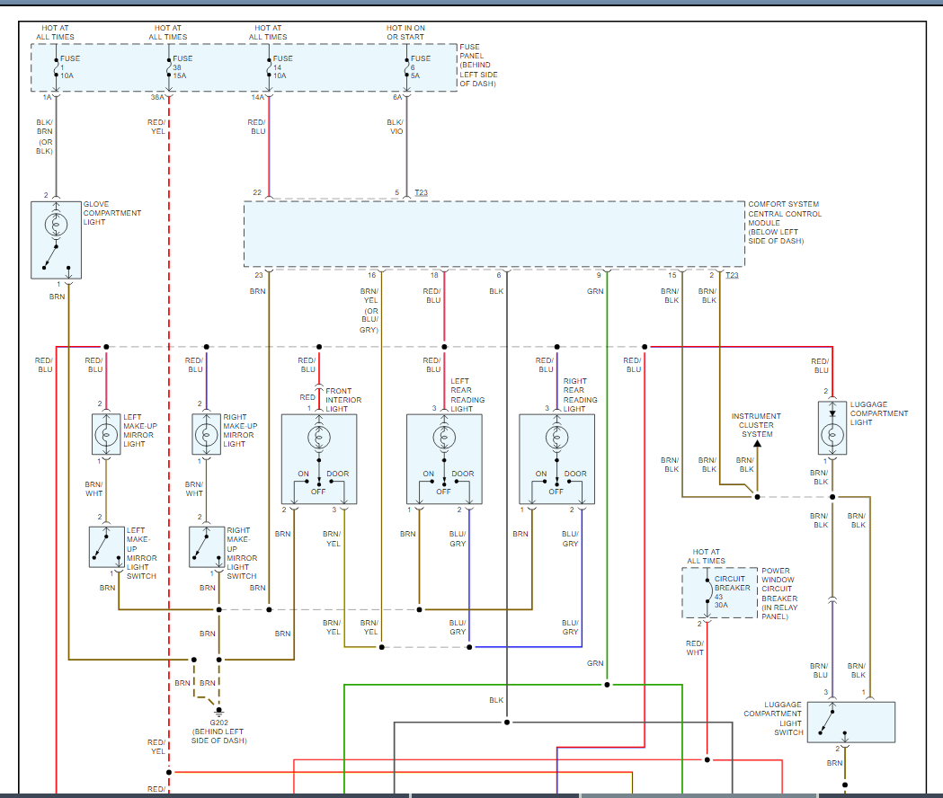

I already reviewed this diagram. Is it the fuse for the sunroof? I see nothing listed for power windows. Thanks
Mar 16, 2019 at 8:44 AM

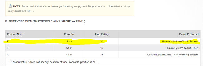

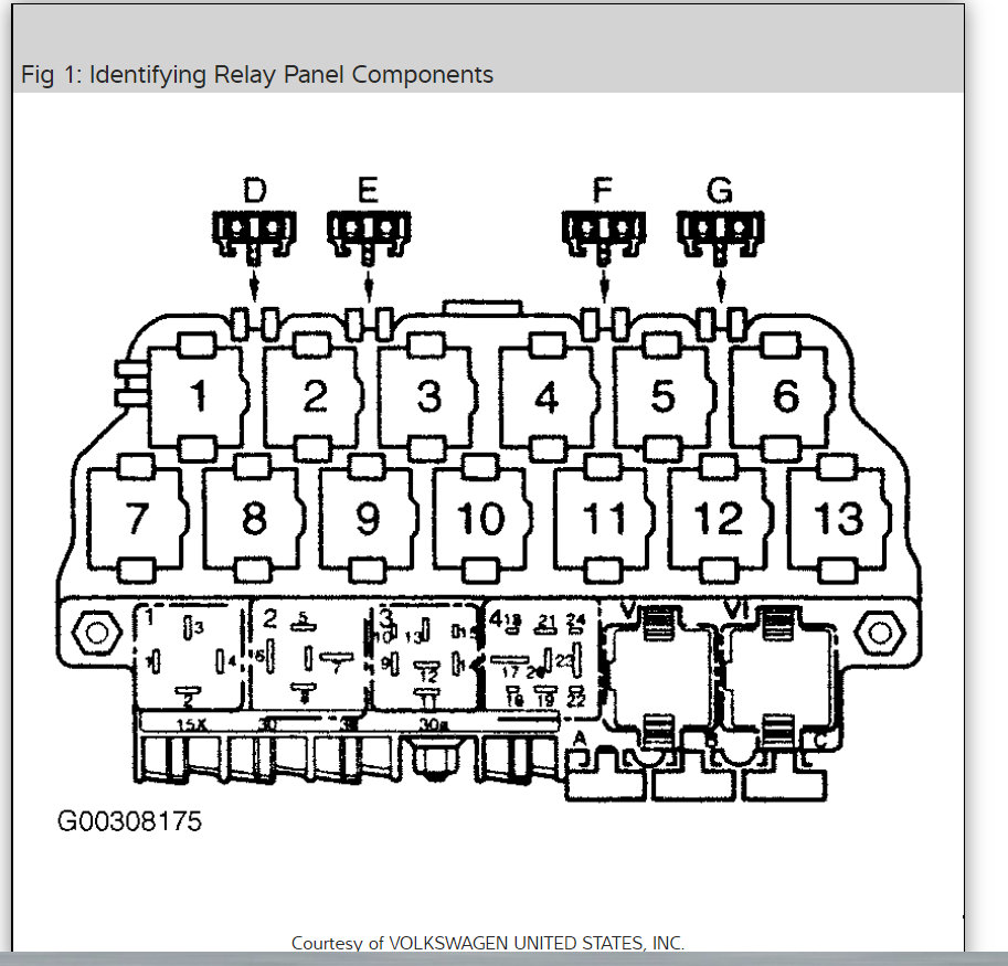

SCGRANTURISMO
  • 4,897 POSTS

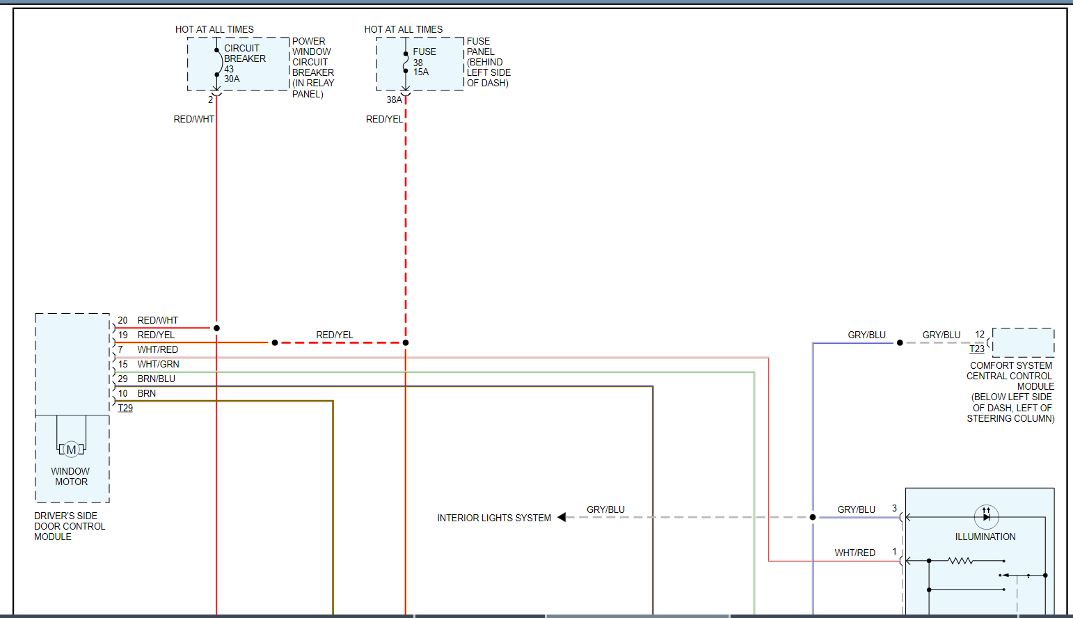

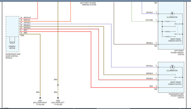

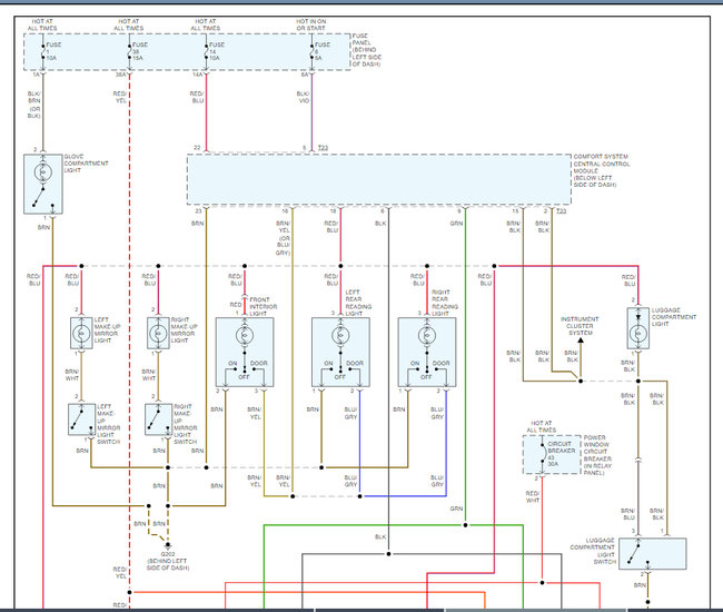

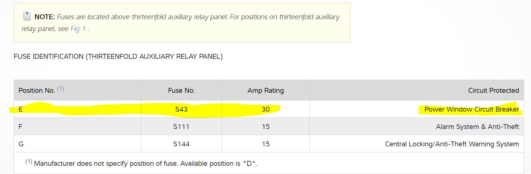

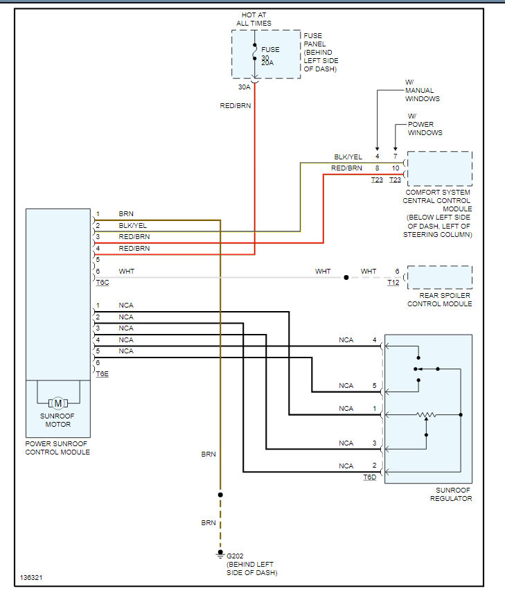

The sunroof fuse is fuse #30. I am sorry about the power windows. I have included more information in the diagrams down below. I have highlighted the information for you. In the power windows wiring diagram I included earlier, it looks like power is provided through fuse #38.
