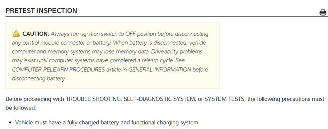

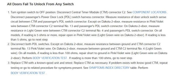

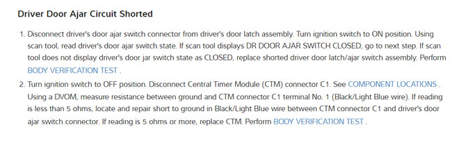

It’s raining and my windshield wipers won’t turn off and my doors won’t lock and when the door is open my lights don’t turn off and I’m afraid of turning my car off because what if it doesn’t start again. what do I do?
Aug 26, 2019 at 11:53 AM
SCGRANTURISMO
  • 4,897 POSTS

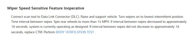

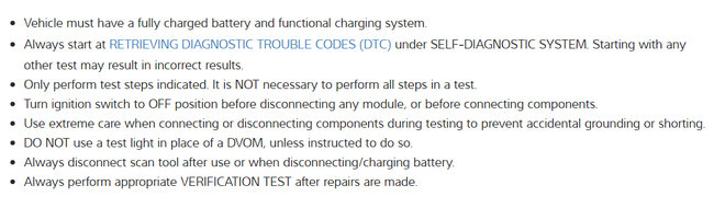

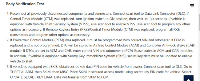

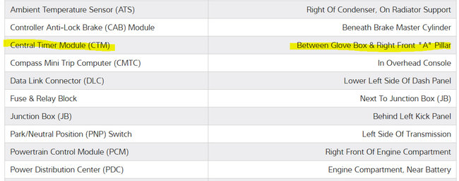

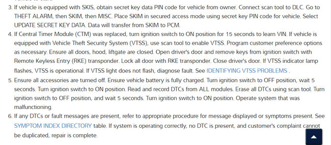

This could be a problem with your vehicle's Body Control Module (BCM), or in your vehicle it is called the Central Timer Module and it is located behind the right side of the dash. In the diagrams down below I have included specific diagnostic tests for the symptoms that you described above as well as location information for the Central Timer Module and removal and installation instructions for the module as well. Please go through these guides and get back to us with what you find out.
Thanks,
Alex
