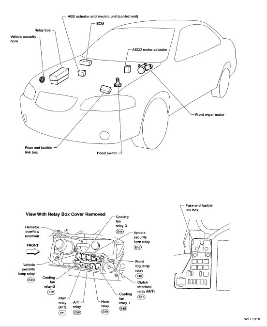

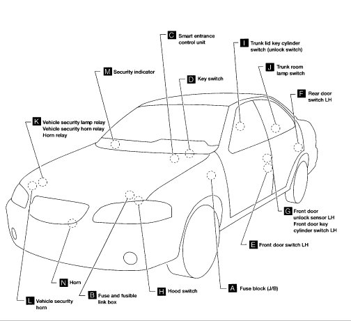

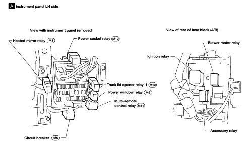

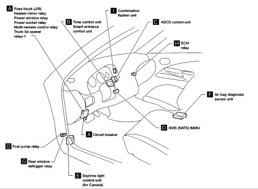

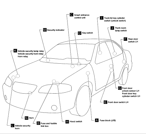

Fuse box diagram can you give them to me?
KRISNJESSE
MEMBER
2001 NISSAN SENTRA
55,000 MILES
I just need a diagram of the fuse box.
Tuesday, May 8th, 2018 AT 5:08 PM
MECHANIC
110,057 POSTS
Hi and thanks for using 2CarPros.com. I have attached pictures of the fuse, circuit breakers, and relay blocks along with locations. Additionally, here are directions on replacement:
