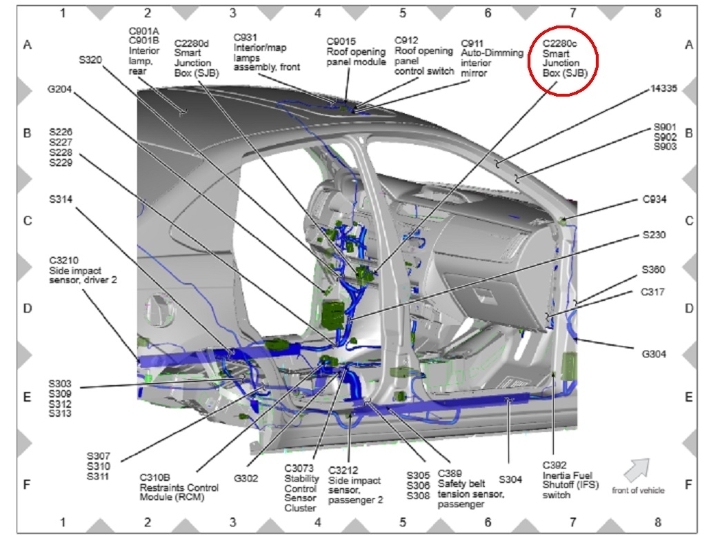

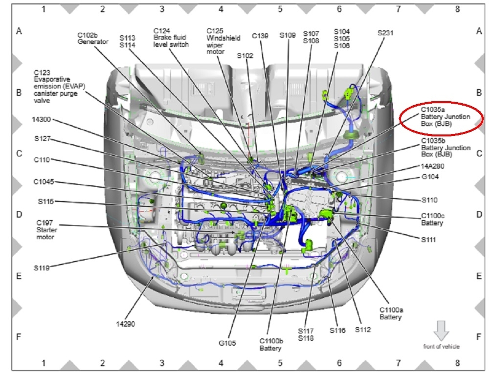

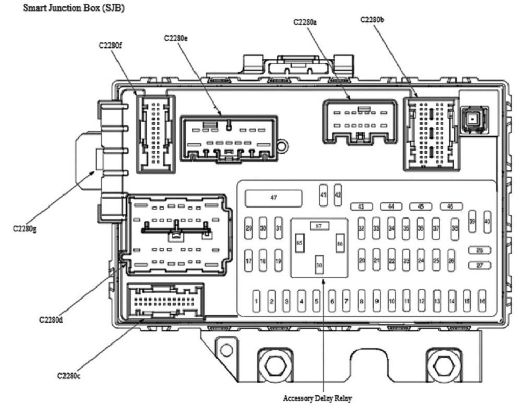

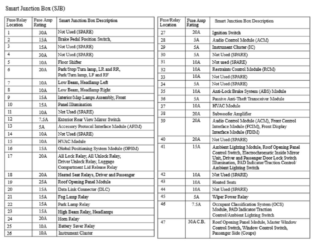

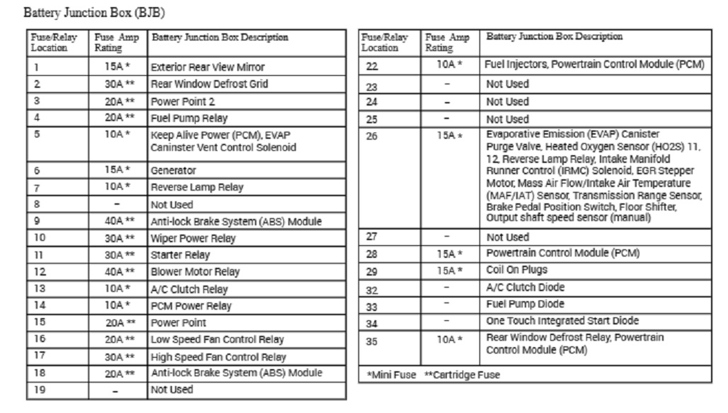

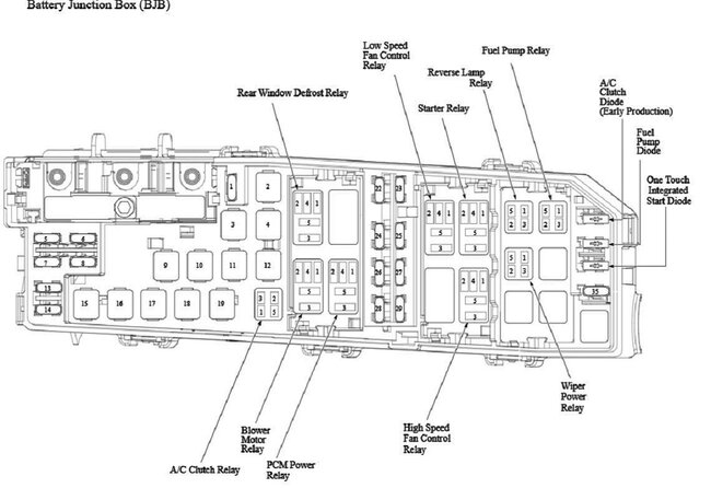

I bought this car and there was no owner's, Manuel. Can you help me with a diagram of fuses and what they go? Also, where to locate. Thank you
Jul 25, 2023 at 11:40 AM
CARADIODOC
  • 34,380 POSTS
The "Battery Junction Box" will be under the hood. The "Smart Junction Box" is inside.
