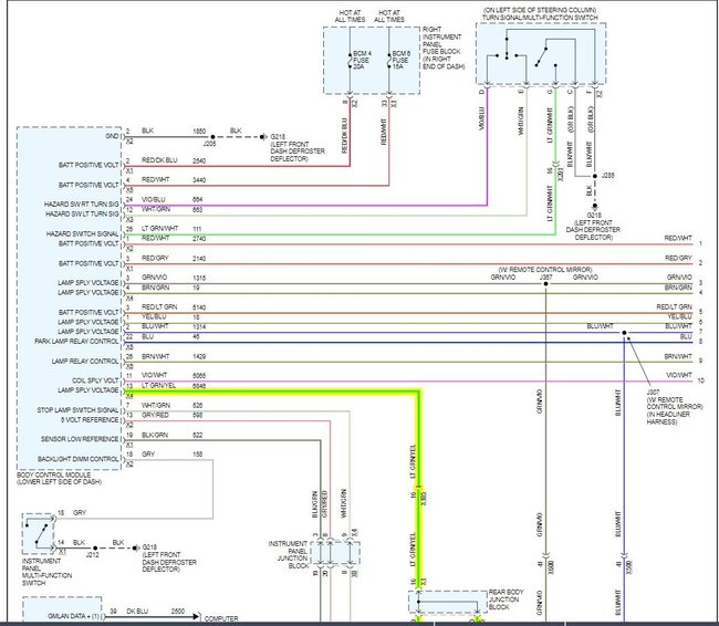

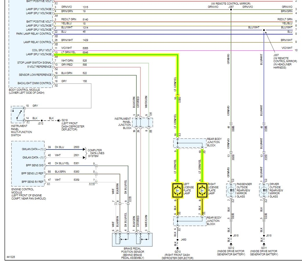

I have the truck listed above Silverado LTZ. The license plate lights aren't working. Already replaced the bulbs. Where is the fuse located at??
Apr 5, 2021 at 1:53 AM
Good afternoon,

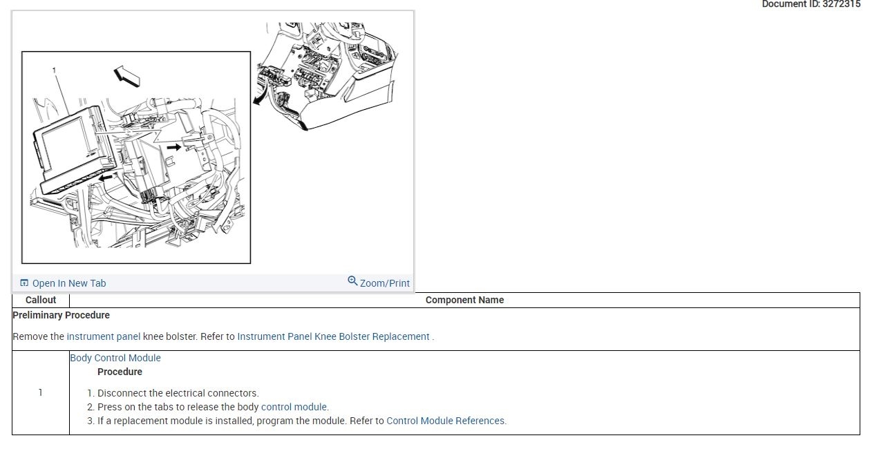

I attached a wiring diagram of the system for you. Check the green wire for power. If there is no power, then you need to go to the body control module as that is what powers the bulbs. There is no fuse.
https://www.2carpros.com/articles/how-to-replace-a-bcm-body-control-module
