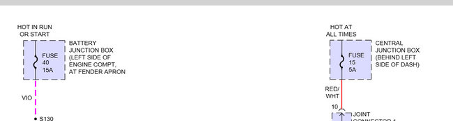

My owner's manual does not let me know what fuses control the cruise control. does anybody know?

See picture. there are two use a test light or volt meter to test them.
Image (Click to enlarge)
