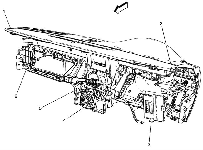

Need location of fuse blocks.

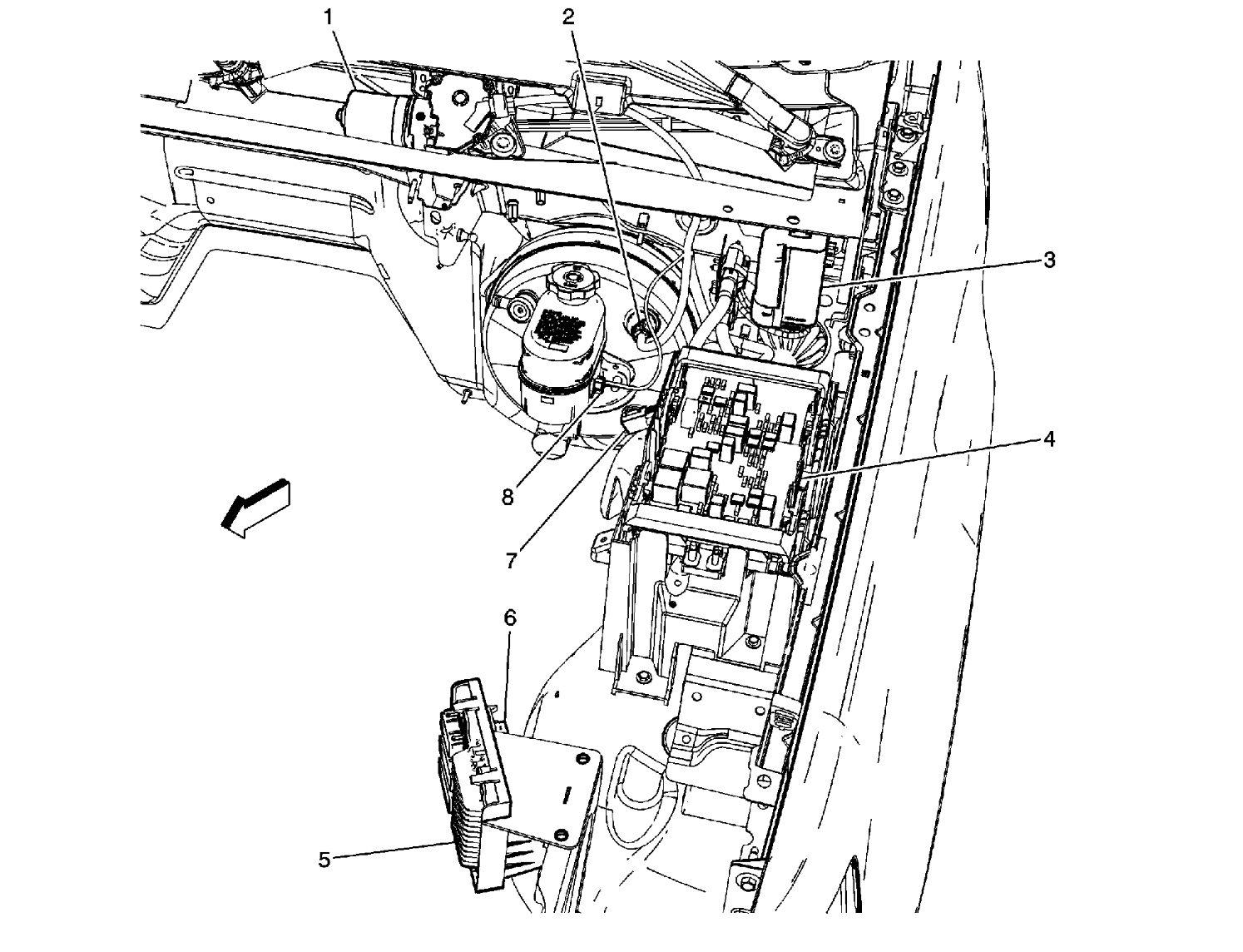

You will have an engine compartment and body fuse block.
Engine fuse block next to the brake booster as shown in the first picture.
Body fuse block underneath the dash on the drivers side, you may need to remove the lower dash panel on the drivers side to access. try looking up under the dash from the drivers foot well.
Hope this helps, any further questions let me know.
