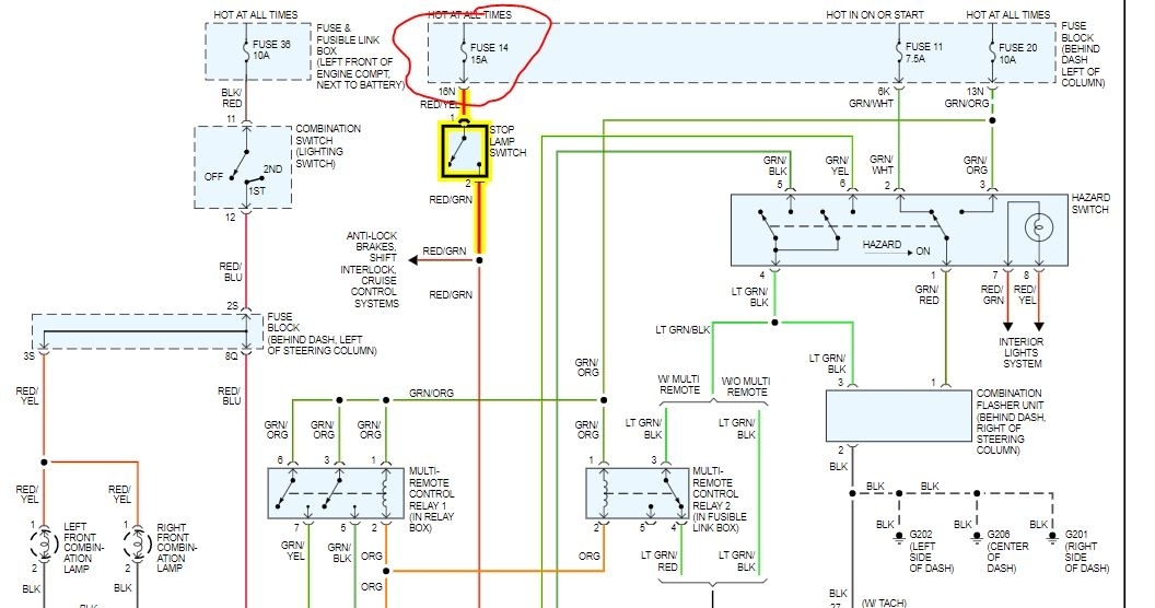

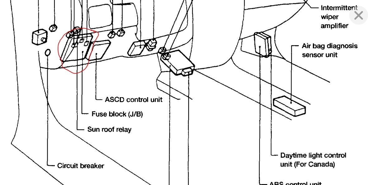

What is the fuse number for the rear brake lights?
150,000 MILES
HAYDEN COX
lost fuse interior fuse diagram would like to know number for rear brake lights.
Jun 22, 2020 at 11:15 PM
Good morning,
It is in the fuse block under the left side of the dash. It is fuse 14 in the fuse block. I attached a wiring diagram for you to view. If the fuse is not the issue, we can do some testing to find the fault.
It is fuse 14 in the fuse block. Check out the images (Below). Please let us know what happens.
