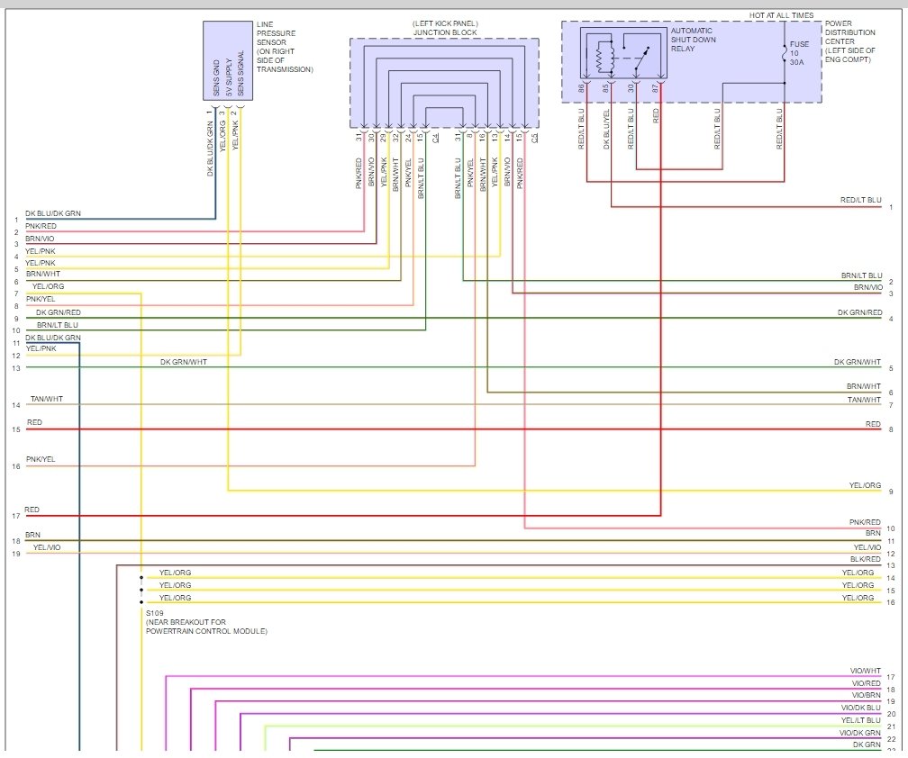

I was driving my truck it cut off I could not start it back up. when I try to start it it turns like it is going to start but will not fire up. so I found that the ASD fuse was out so I replaced it and the truck started right up like normal, but only stayed running for like thirty seconds and the fuse blew again

there is a short in that circuit that is causing it to blow. try the dark green/orange wire it goes to injectors you might have a bad injector or the wire is hitting and grounding out .

Hey AALDREDGE,'

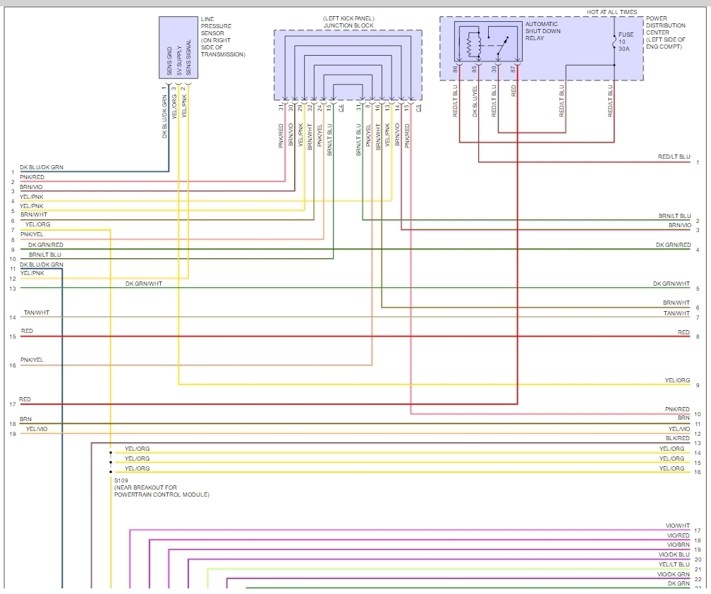

I would try replacing the relay it could by grounding out internally. Here is a wiring diagram to help you.
Please let us know happens so it will help others.
Best, Ken
