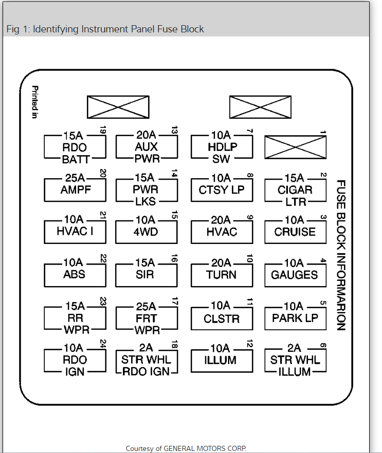

What is the fuse number and location for the windshield motor?
Feb 7, 2019 at 3:53 PM
SCGRANTURISMO
  • 4,897 POSTS

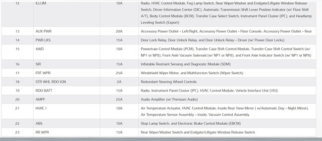

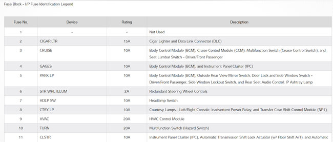

It looks like fuse 17(25A) in the instrument fuse panel which is located on the left side of the instrument panel near the door jamb switch. I have included diagrams if it and the fuse legend below.
